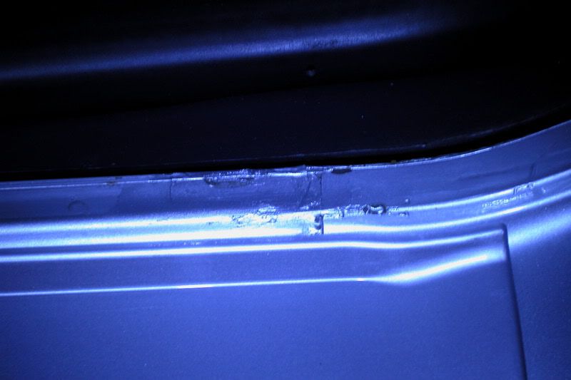

note the inside of the rear quarter panel is black as the other is silver...

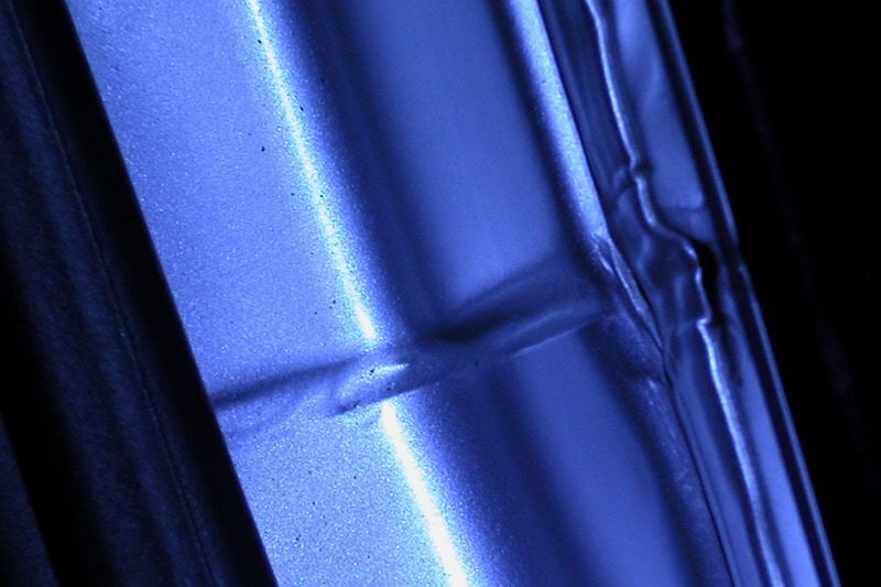

this seam is factory

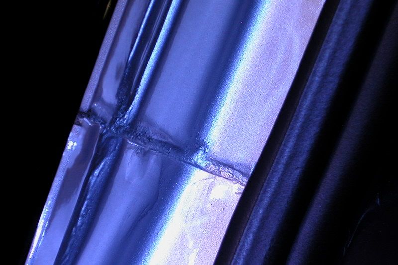

this one is not

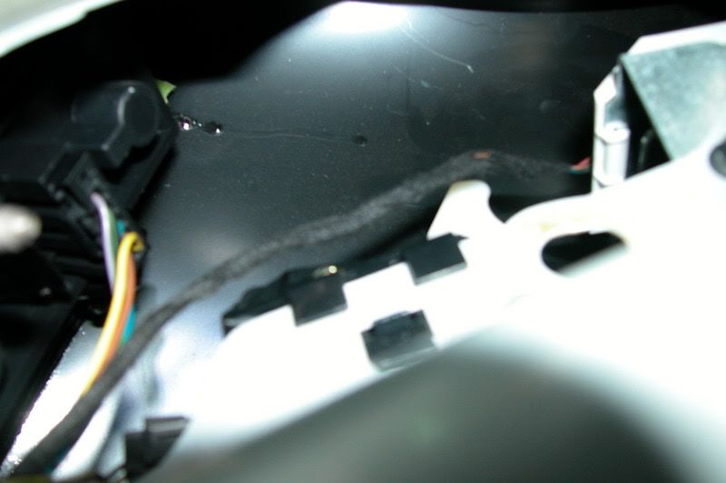

the one of runs on the rear hatch, other is on the inside

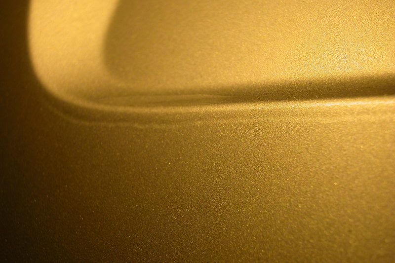

keep in mind there are no stickers on the driver side jam, the sticker that has the vin # and all that good jazz on it. Also there is alot of "smooth" but rough paint on the inside of the passanger side of the hatch where clearcoat i assume drifted over and stuck, and on the drivers door jam, any way I can smooth that out cause its in the jams and thats look to be a pain in the flower hole...

However, the Lexus also is missing the original stickers and those same seams are welded...I believe the CPO Lexus dealer called them "hung quarters"...and it means that the car was in a significant rear-end accident (or in your case side-rear). So, Devilsown, your car was almost definitely in a rear-end collision and repaired, whether CarFax showed it or not. Our autobody shop did an amazing job, and it sounds like the one that repaired your car probably did too, but if whoever you end up selling this to sees the lack of sticker or the hung quarter the resale value will drop a lot.
