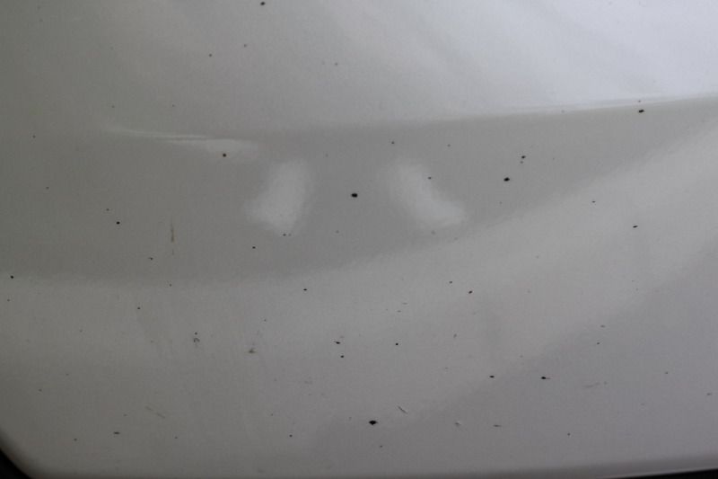

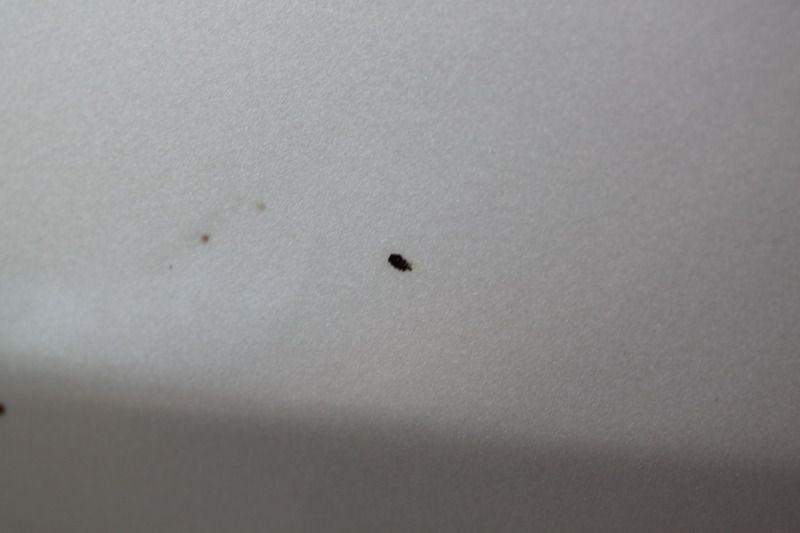

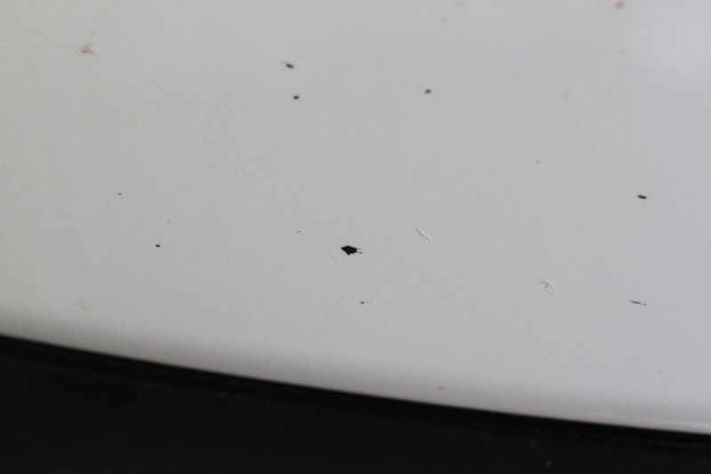

Included are pictures showing these black spots some up to a few mm in diameter which are smooth to the paint and not coming off. In the pictures there are also what appears to be Artillary Fungi which I can scrape off with my finger but the larger spots are the ones I am referring to. I just had my car washed and can not seem to get this crap off. I can only think it would be tar but it is smooth to the touch. Any ideas?? pics below..
My guess would be bituminous asphalt (tar) as the spots have direction-ability
Using steam and / or a safe solvent (Stoner™ Tarminator, Stoner™ Natural Citrus Xenit or Wurth Clean Solve) will simply emulsifies and dissolves the bituminous asphalt when you spray it directly to the surface, apply to the affected area, allow sufficient react time, and carefully wipe off, you may have to apply it three or four times allowing plenty of react time between applications.
