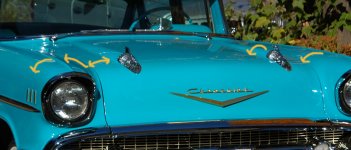

Just about to order a Flex but before I do, I still wonder if it can do it all with the 6.5” pads. I dunno, some of these areas on the hood and fenders don’t give much room to move around. Also as you can see in the pix, dips and sharp curves are in abundance everywhere. The only real flat areas are the lower side door panels. Will I need a PC too with 4” pads for some of these areas or can the Flex maneuver around those ok?
Question #2, those two ridges that run along the hood with the rocket chrome ends. How would you polish those? By hand I guess? If so, will the finish match the rest of the hood done with a buffer?
Let me know what you think as I sure can’t afford two buffers right now.

as far as the angles and curves you should be alright, the tight spaces I'm not sure. I (this may be wrong but works for me) will angle the pad in areas like you're showing. You shouldn't angle a rotary but I have never had a problem with the Flex only using part of the pad at an angle to hit some spaces. If you are worried about it put tape on the hood where the line breaks for the two ridges, this way if you angle the pad to hit the ridges you will be hitting tape if you do come down and hit the hood. Understand? Like I said I haven't had a problem doing this, others may say it is not good. There are pads that are 5", if that is still going to be too big then maybe get the flex now to polish most of the car and then save up for the PC to use later.

fins&chrome- IMO you'll do fine with just the Flex. By using the overhanging outer portion of large pads, you'll be able to get into a *LOT* more tight spots than you'd expect. Areas like those you circled shouldn't be a big deal once you get the hang of using the machine.
IMO a PC would be more useful for doing small areas/spot-correction with 4" pads than for getting into tight spots on that car.
I used my Flex to do a '60 Jag MKII that was a *LOT* trickier contour-wise than your Chevy and it handled the odd shapes just fine. I only used the PC/4" for concentrating my efforts (quite aggressively) on small areas, *not* for getting into tight spots.
The "how to do tight spots" thing just doesn't usually work out the way one would expect, eh..at least not the way *I* expected it to go.
