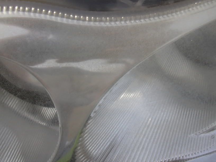

1. Just the yellow haze or film that has built up on the plastic. This is the easiest to repair
It is usually just a mild oxidation.
Such as the hazing on the Mercury.
showphoto.php
Some times the haze will simply buff off with a heavy compound. If not wet sand it with 1500-2000 grit wet/dry paper. Followed by a heavy compound and polish. I like 3m perfect-it
any high speed buffer should work though I prefer 3in. wool and black waffle pads on a drill.
This should take about 1-1.5hrs. to complete

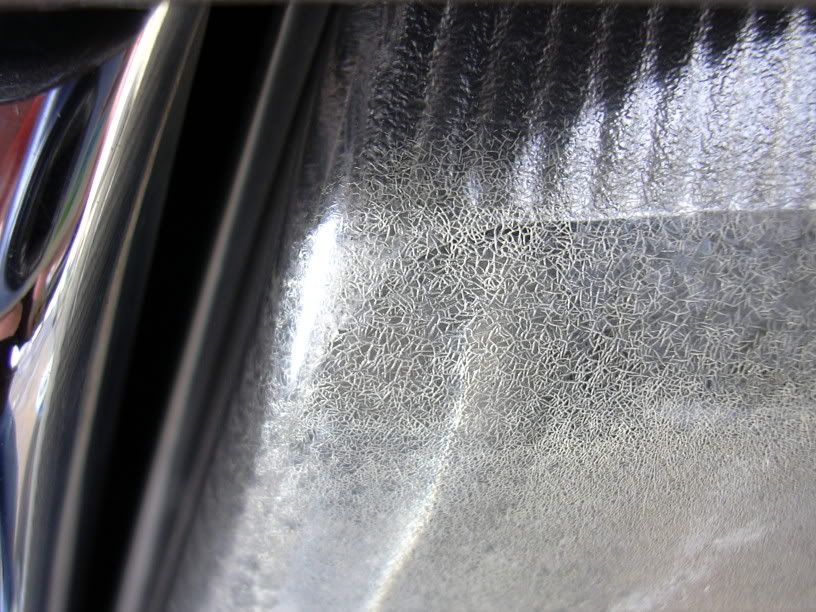

2. The second category is what I call pitted damage. This can be much more difficult to repair.
Note the Intrepid, 300M, Cherokee, & Mustang.
showphoto.php
Alot of vehicles come with a claer sealer that is sometimes difficult to remove. Be sure to get it all off and sand deep enough to remove all of the pitts.
Begin wet sanding with 400 grit wet/dry paper
Next step up the sanding to 600 grit to remove the 400 grit marks
Continue this with 800- 1000- 1200- 1500- 2000 grit wet/dry sand paper
Now you can buff compound polish to remove swirls
This is where sealers come in but not an absolute necessity. Bright Solutions Shine Restorer will work or you can use Rustoleum clear spray paint ( not highly recomended) or clear coat ( expensive)
This usually takes 1.5-3hrs. maybe more in some cases
Tip for wet sanding. Alternate between grits with a vertical then horizontal motion so you can see that all marks from previous grit is completely gone

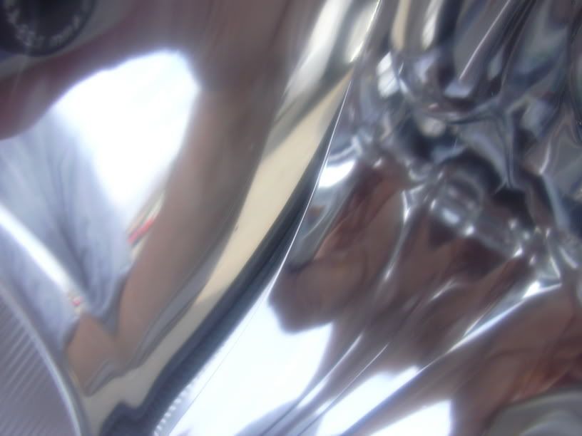

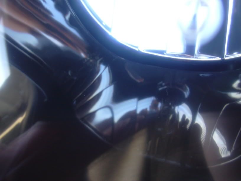

Try buffing out the cracks and pits such as these.
Here is a Jeep Grand Cherokee before & after
Here is a Chrysler 300M before & after
For the Jeep I started with 320grit, the 300M 400grit. The first step is what takes the longest it also uses the most paper because the grit wears down fast. Always be sure to remove all the lense damage in the first step. Changing directions when stepping up each grit makes it easier to see when the previous grit has been completely removed.
The Jeep took about 2.5 hours to sand and 20-30 minutes to buff. I don't remember how much time I spent on the 300M.
