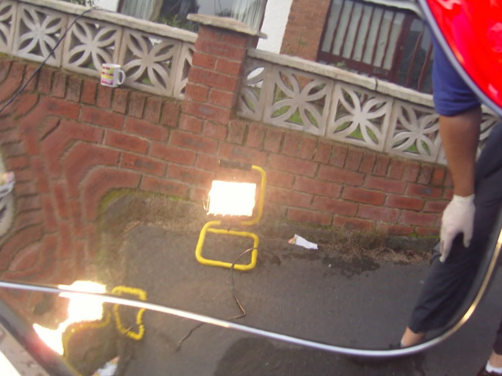

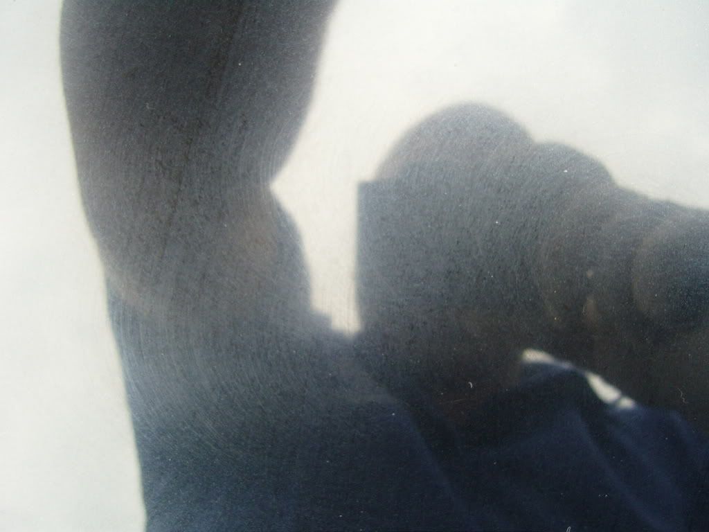

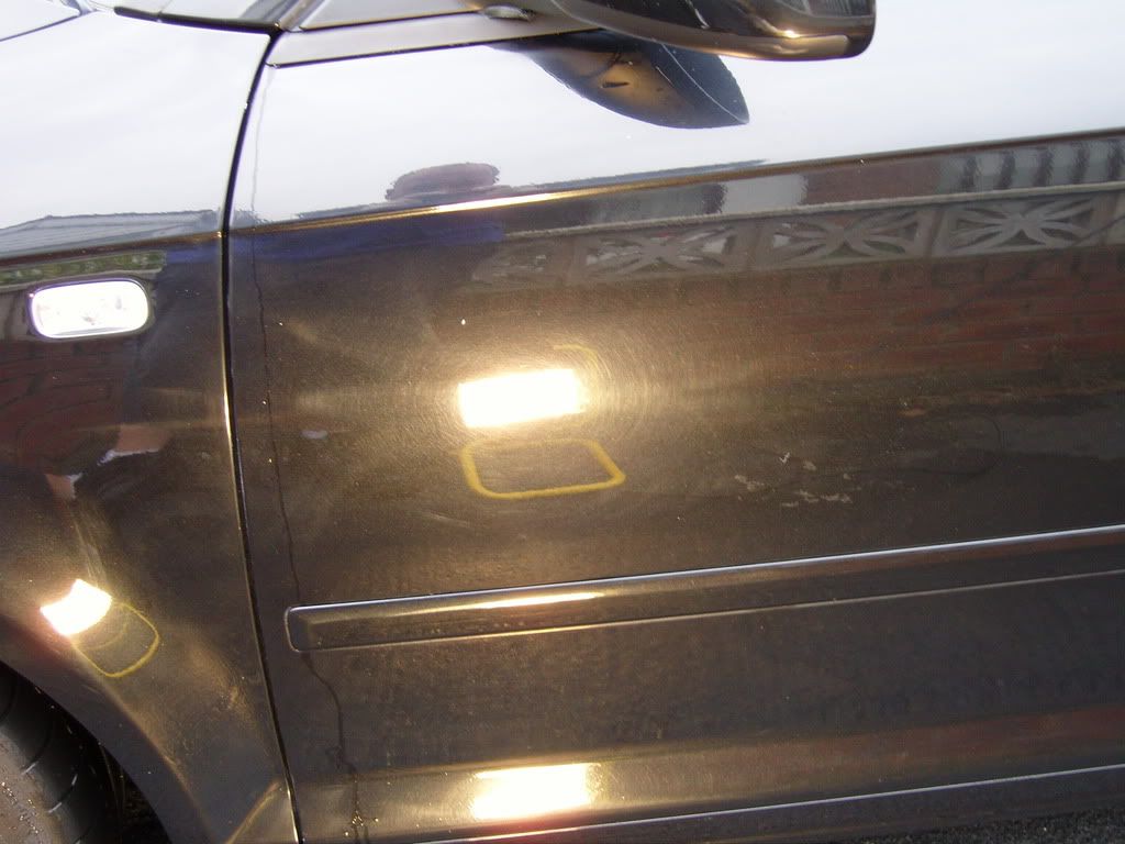

This customer had some minor fine scratching on the bonnet of his black A3, and employed a bodyshop to buff it out. Think they misheard him, and buffed some scratching IN. ALL over.
Lots of holograms and a right mess.
No flash full car pics on this one, as the wheels, arches and glass just had a very quick clean. Not a full detail, bodywork only.
Here's the wonderfull work to correct.
Lovely, I'm sure you'll agree :roll:

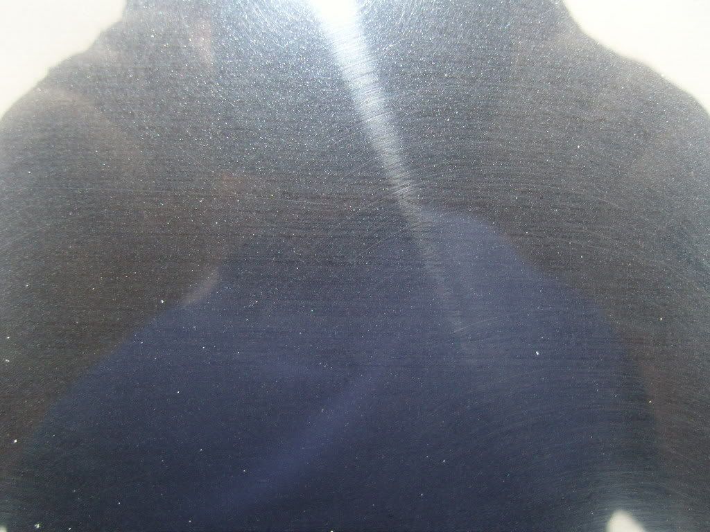

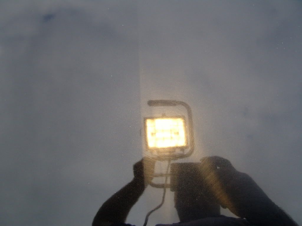

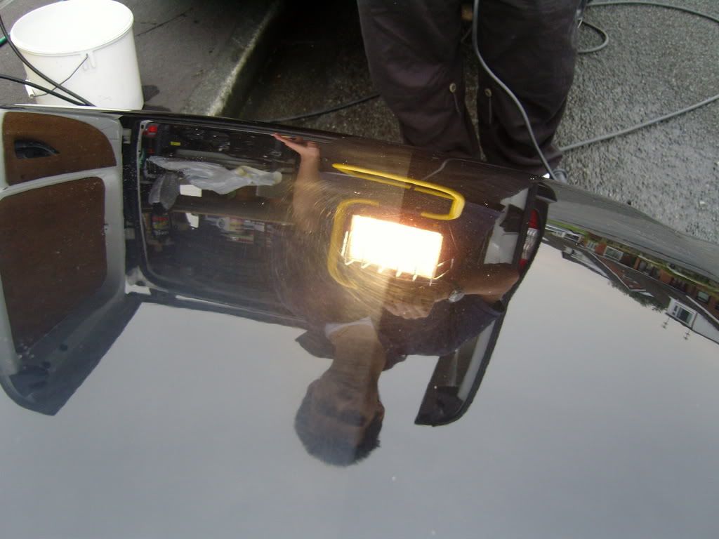

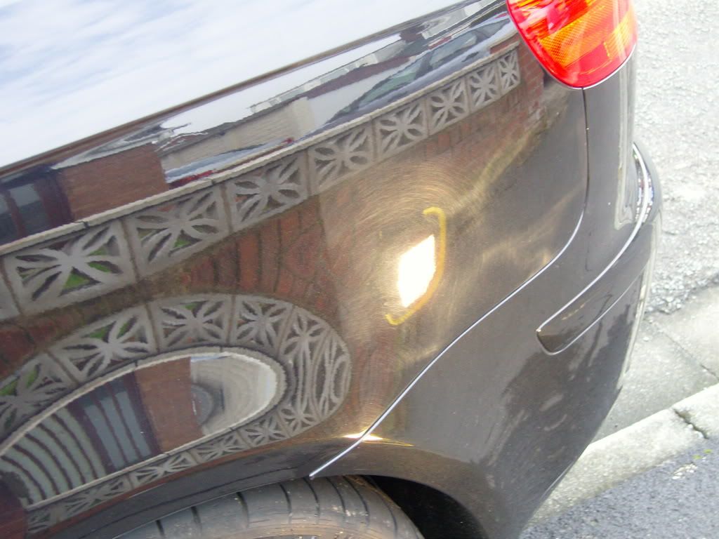

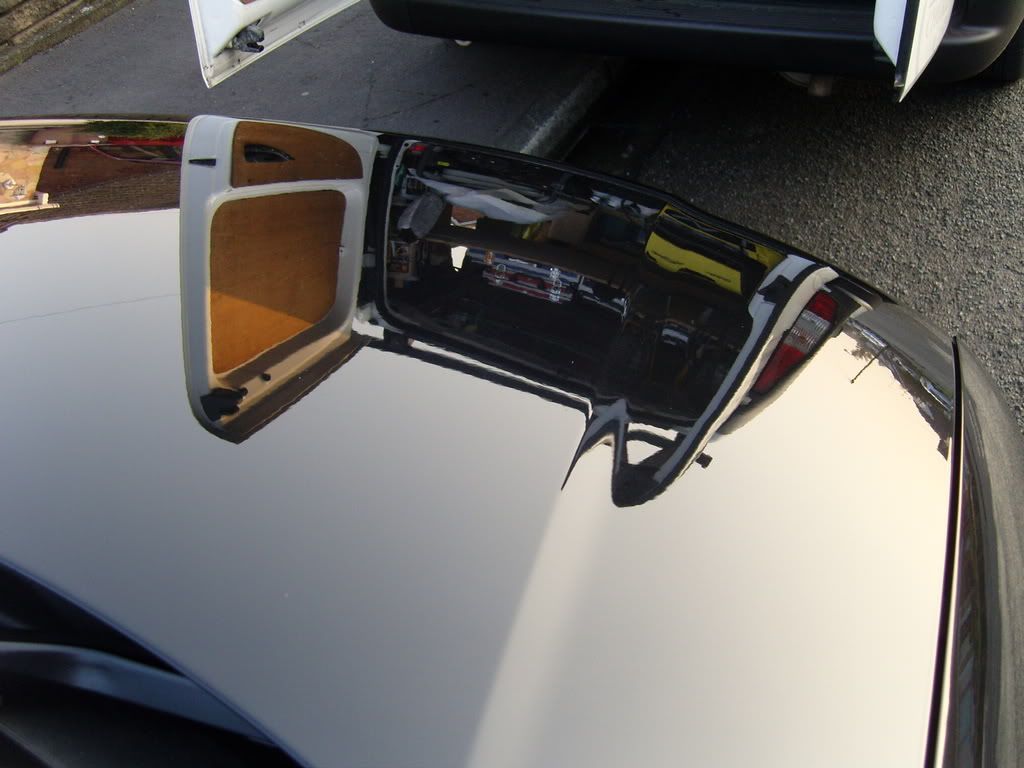

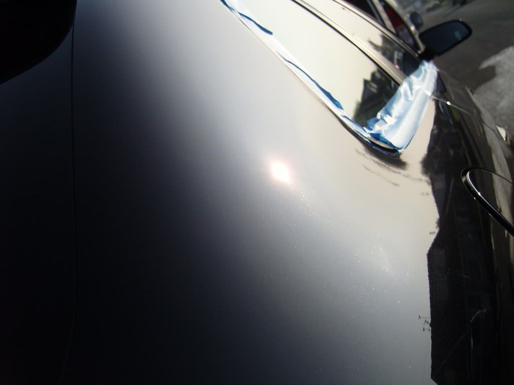

Here are some 50/50.
Getting there - still some deep scratches. -

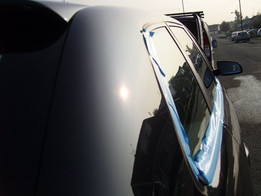

Better -

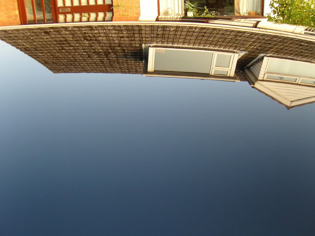

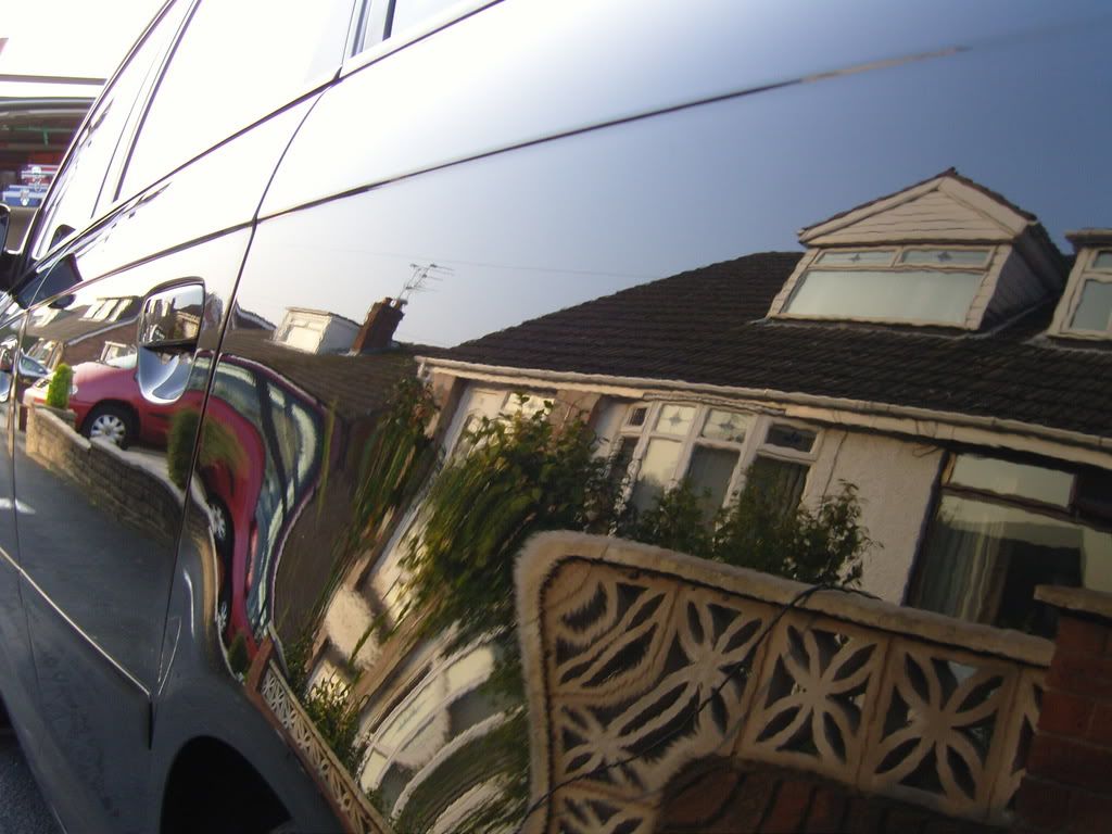

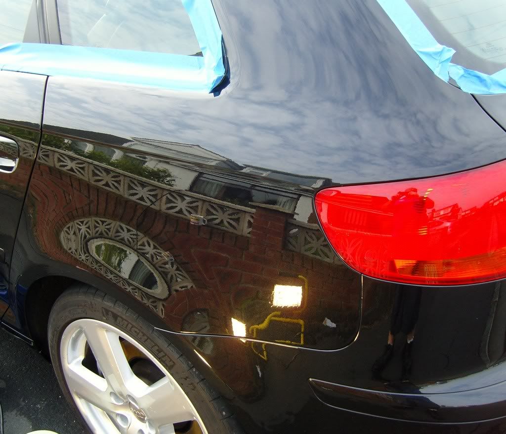

After -

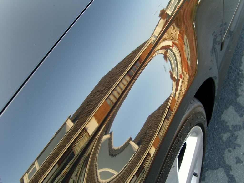

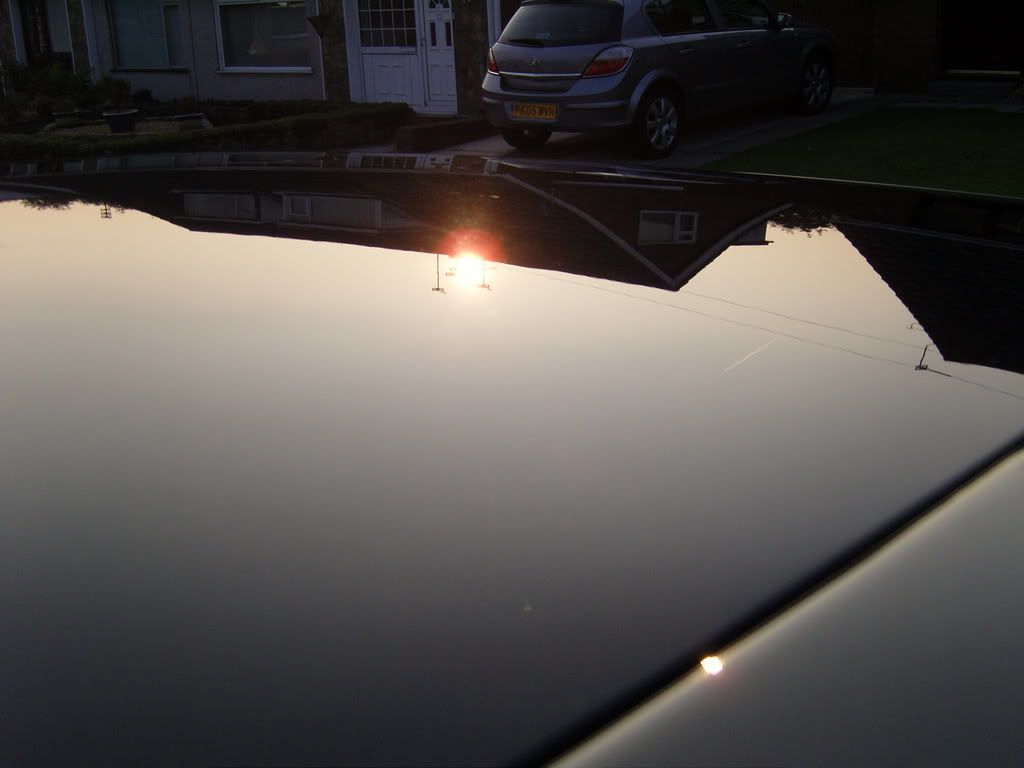

and some direct sun -

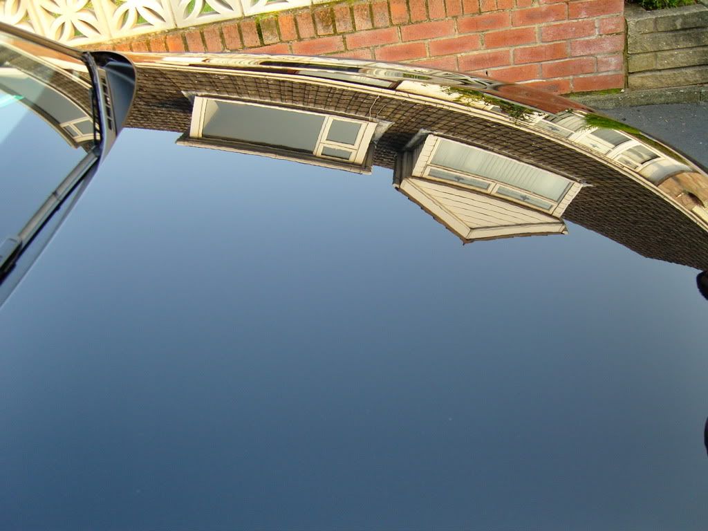

and some reflections after a layer of Swiss.Onyx to protect the finish -
