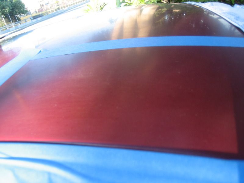

Below is work I did to the hood ( you can see how bad the paint is ) using the PC starting with a yellow pad and the troubleshooter. Didn't quite cut it so I switched to a clean pad and hit it with one pass of the DUZ-ALL then back to the troubleshooter and finished with the PRO-GOLD.
You can see where I had taped off two sections.
After hitting it with the PRO-GOLD
You can see how hazy the hood is toward the center. The roof and the decklid are in the same condition.

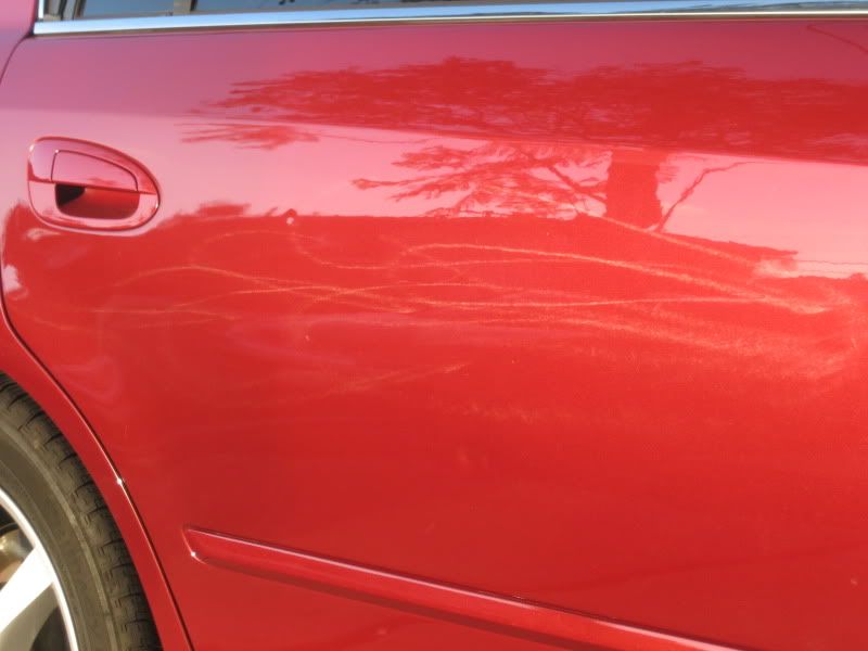

now, we got rear-ended a few months ago and the whole rear of the car was repainted including the rear doors. Car has only been hand washed since then and no polishing or waxing has been done. I noticed these bad boys after the second wash. Not just side panels, whole car.
Obvious hack job by the body shop and the wife won't go back due to other instances. Now, whats the best way to tackle this using my current product line? Are the any recommendations for different product?
This is downright ugly and I cringe when I see it.

I used Pro stuff for a long time but never used Troubleshooter or Duz All. Are there better products out there? ABSOLUTELY. Are they simply a must have to correct this? No. The swirls are pretty bad and to work with your current product line for the most part your going to need to start out with some light - medium compound such as Megs Ultimate Compound from Wal Mart. I dont think either of your Pro polishes will touch those swirl marks. Your going to notice an unbelievable difference just from that because your going to be using a PC and not a rotary so the body shop's swirls will be gone just from re-compounding. All you will have to deal with is the very slight marks your PC might make with the compound, and any of your polishes should take care of that easily. Make sure and use a good polishing pad with them. Then seal or wax and your good to go. Just make sure to clay first. Always clay first...
Im familiar with some of Pro products and agree the Duz all and trouble shooter probably wont have enough cut to get these out as these are more paint cleaners than polishes. If you have "clear cut " that may do it.
Meguiars 205 may work as well , or step up to the above mentioned megs ultimate compound.Good luck and sorry that shop did that to your car! :)

I would just get the Meg's Ultimate Compound or get the Meg's M105 and M205 from our the Autopia carcare store here with some of the Lake Country Hydro Tech pads and work on one panel at a time. These will do the job for you, if your going to wet sand then maybe getting a rotary ( from someone or buy one used ) with some wool pads will help also after any wet sanding, but you might get them off with a DA like your 7424 PC with these products.
Taking it back there might just do more damaged then good IMO.

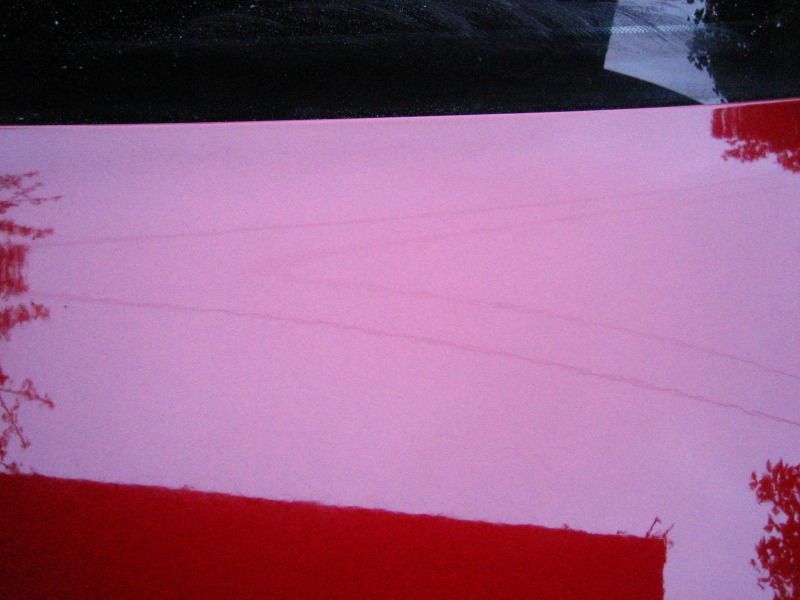

Back from the dead this post is as a little update is needed. Have been quite busy lately and I finally got around to putting down some elbow grease ( wool pad, rotary and a light clearcoat cutter ). followed this up with the DA and paste wax.
This is what I started with on the deck lid.
After wool pad/rotary followed by the PCDA

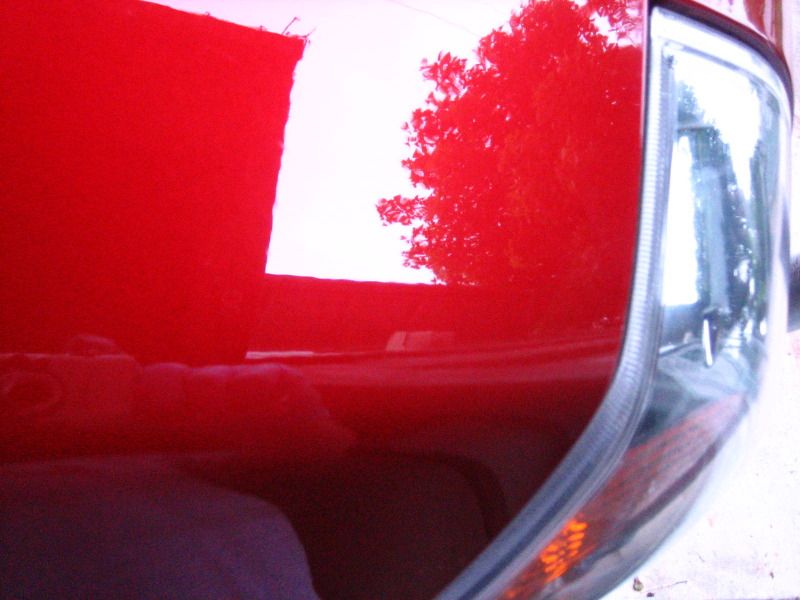

Here is some more nasty stuff from the deck lid.
After rotary/PCDA

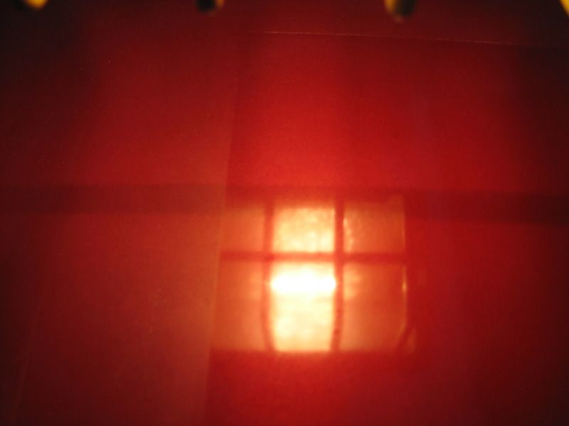

Hood is proving to be troublesome with the same combo so I may need to go much more aggressive. During shot provided. The after were not quite as good as the decklid.
The roof. This is the last part of the nightmare. This will be tackled this coming weekend. This is basically what the hood looked like when I started.

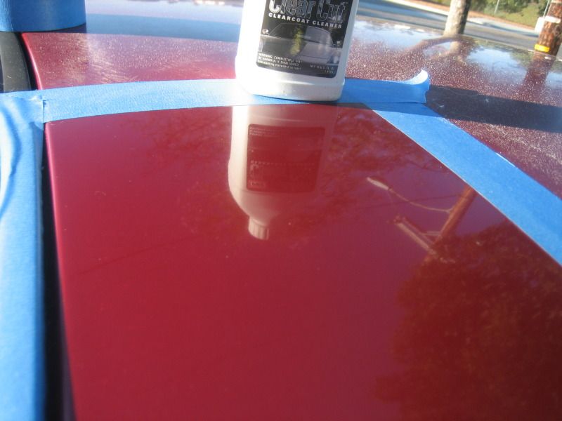

Don't know if the paint is soft. All i know is I have a heck of a time getting this thing to shine up. Did a small section of the roof to see if it may be something I want to tackle. Don't think I do :(.
Started with this.
After one pass with the CLEAR CUT and high speed rotary ( drill )
After one pass of DUZ-ALL
The work that needs to be done...
After final seal.
