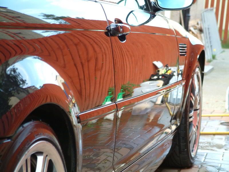

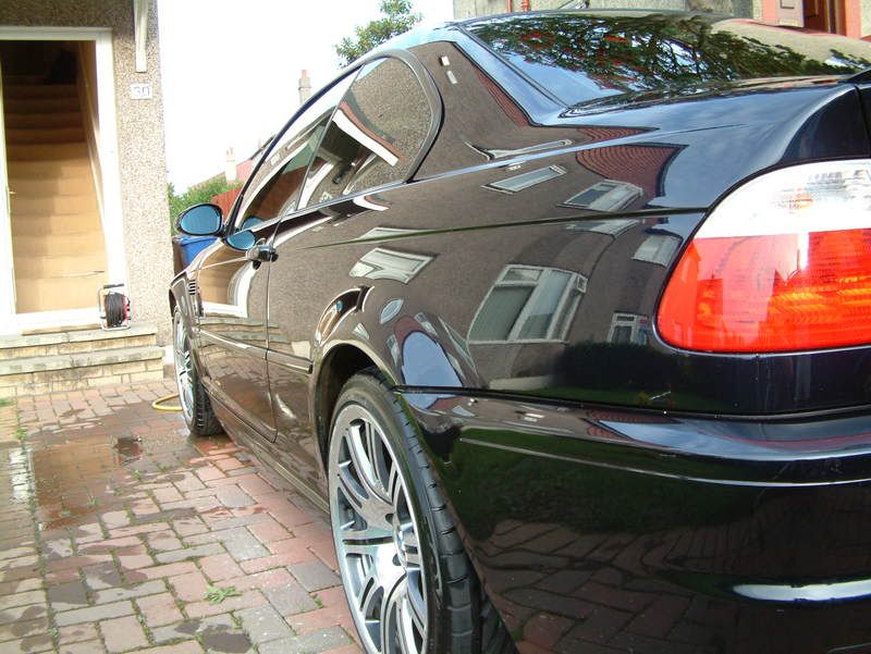

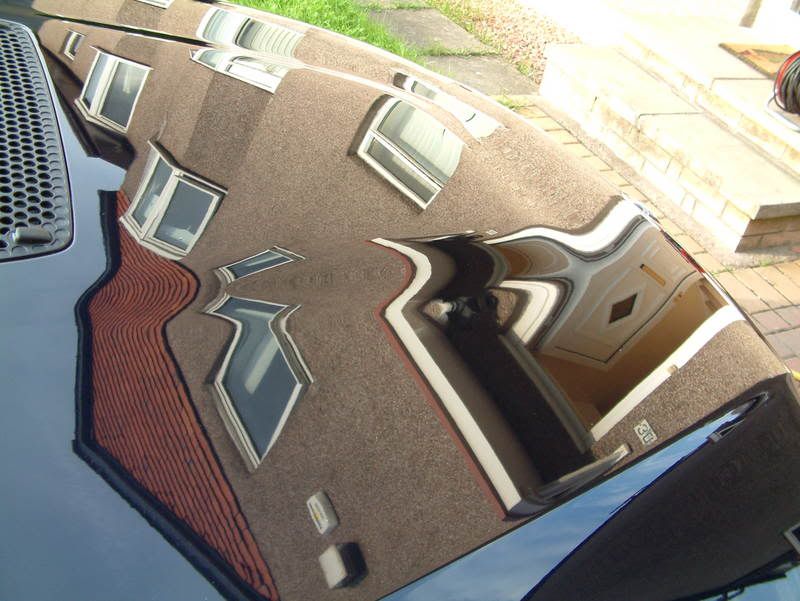

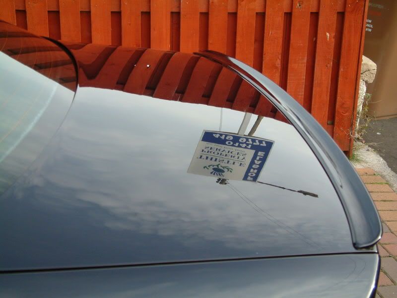

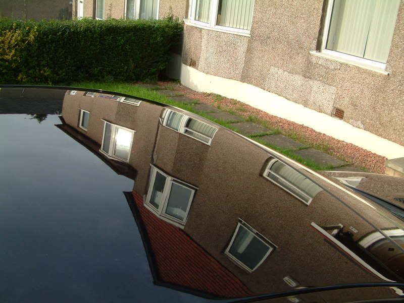

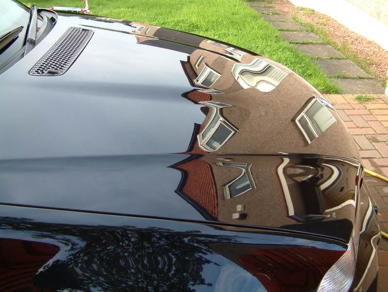

the merc vito was loaded up for my 400 mile round trip
so once i got there thanks to the sat nav (what did we do before i dont know) there was a carbon black M3 waiting for me
first off i checked the tickness of the paint and it was not to bad apart from the normal swirls
so washed the wheels and under the arches then on to washing the whole car with the normal 2 buckets
dryed off with meg`s last touch and the sonus towels (super soft)
clayed with a sonus clay bar
now time to get rid of those swirls
meg`s 84 with a meg`s polishing pad on the rotary
meg`s 83 with a meg1s finishing pad on the rotary
for the glaze i used the meg`s 7 for that wetness
then for the wax i used 1 of my fav`s the pinnical sig souv
the rest was all detailed aswell and i will list what i used but its near midnight and i`ve been on the go since 5 so i need my sleep due to another bmw detail tomorrow but only a 4 mile round trip
