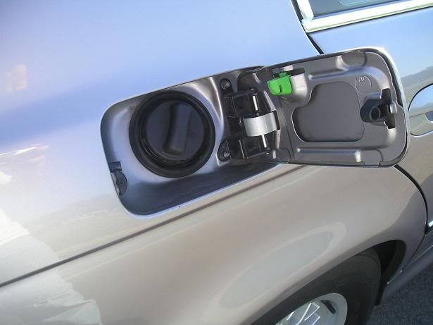

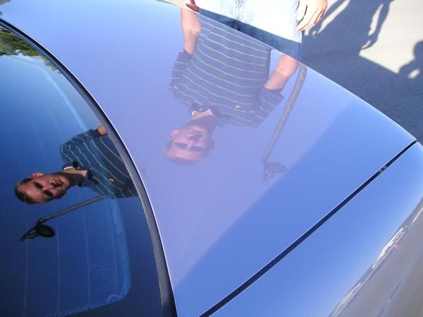

This detail was done about a month ago.. just now getting to posting it up. This belonged to my friend who joined the army. He was going to do a bunch of mods but never got around to it. He tackled the interior while I perfected the exterior. I spent about an hour on the hood alone. It had a really poor wetsanding job done and then the bmw detiailer burned it up badly so I came to the rescue.

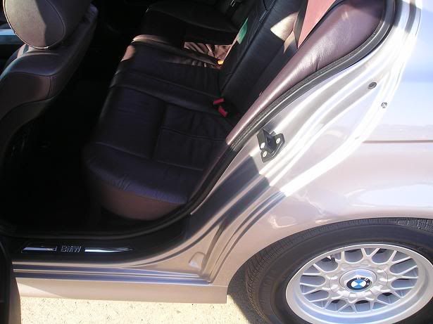

Interior:
Vaccuum
meguairs #40 on all trim
meguiars leather - (freinds preference)
OCW on wood trim

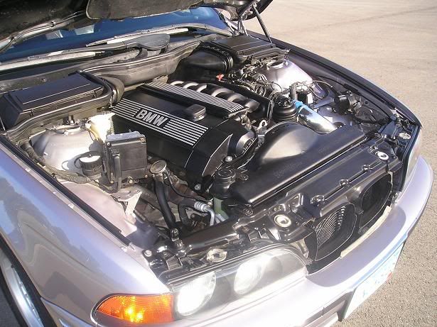

Engine:
Meguiars APC 10:1
agitated with megs brushes and nxt wash
dressed with meguiars hyper dressing 2.5:1
ocw on paint and metals

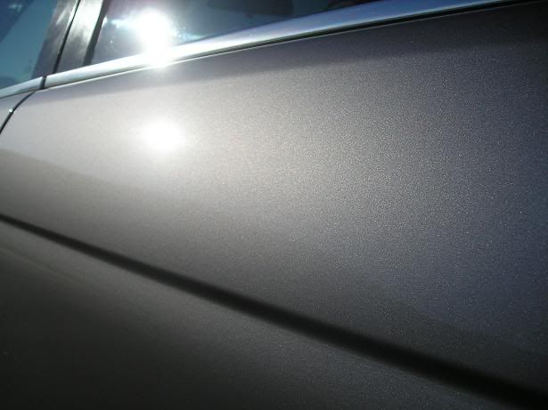

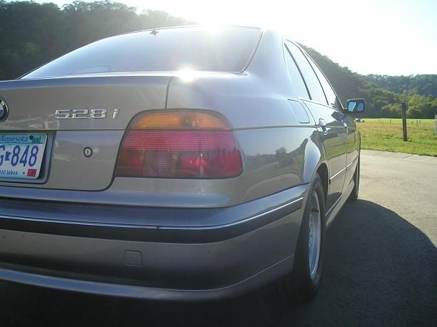

Exterior:
OP via orange LC light cut pad @1200 rpm
#80 via pc
Max Wax
OCW 24 hours later
Tires:
Meguiars Wheel Brightener 3:1
NXT wash
Poorboys WS
IG on windows
BNB on trim
BnB on tires
- proud buddy
Megs Apc/ocw in jambs and gas door
Questions/Comments?

what did you use on the carbon fiber, if it was clearcoated i would have imagined you treated like regular paint?
It was clearcoated so you are correct I treated it like normal paint and It had the same treatment as the other parts of the vehicle. Good question!

Looks great! That engine compartment could be a little more "spiffed up" *cough* M3 Motor and T3/T4 hybrid turbo *cough* if you ask me :biggrin:
Agreed!! That would be awesome!! My freind is getting rid of this car becuase he had to ship out. he plans on buying an M3 when he gets a chance though.

Man that paint looks awesome . Like it has a thick gloss to it. Not my fav color but you got it looking its best .
