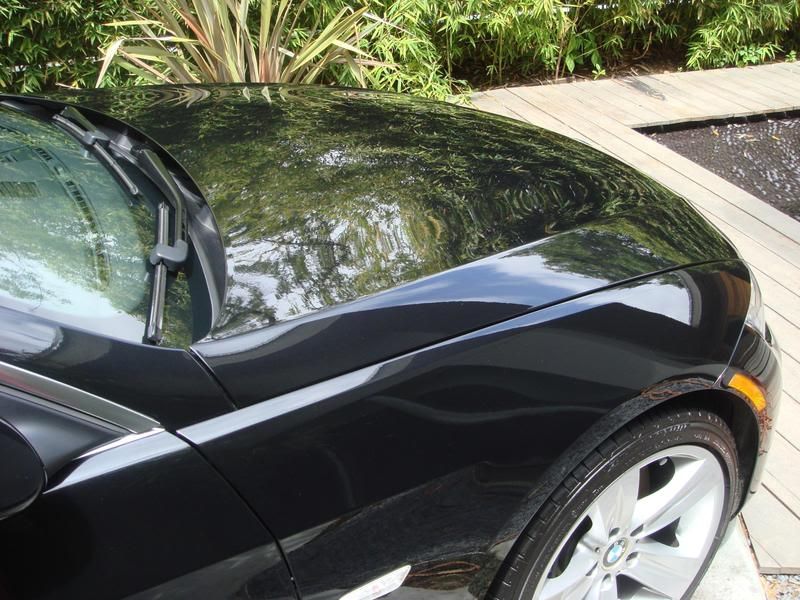

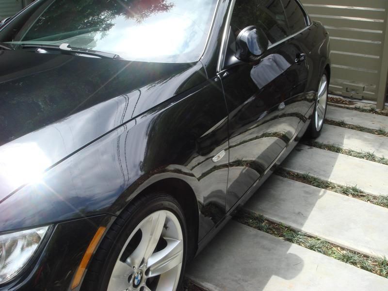

First up,

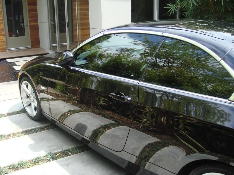

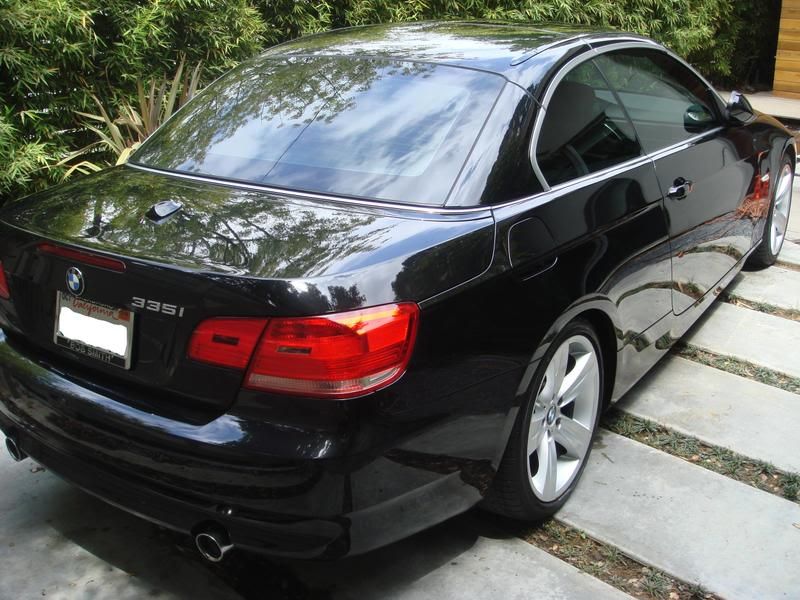

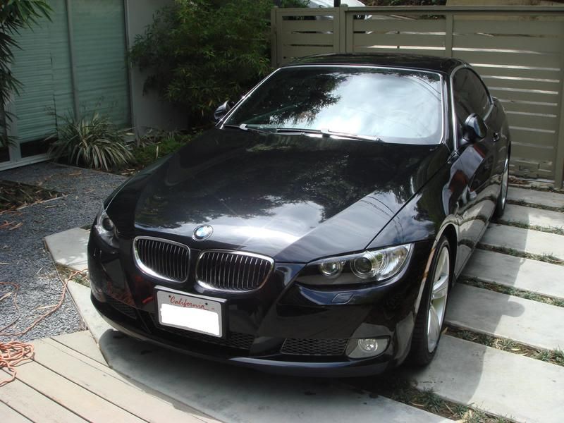

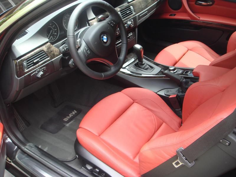

BMW 335i convertible. Customer just came back from a road trip and never had it detailed since he got it.
Process:
Wash
Clay
106ff w/ white pad @ 1500 rpm
z5pro

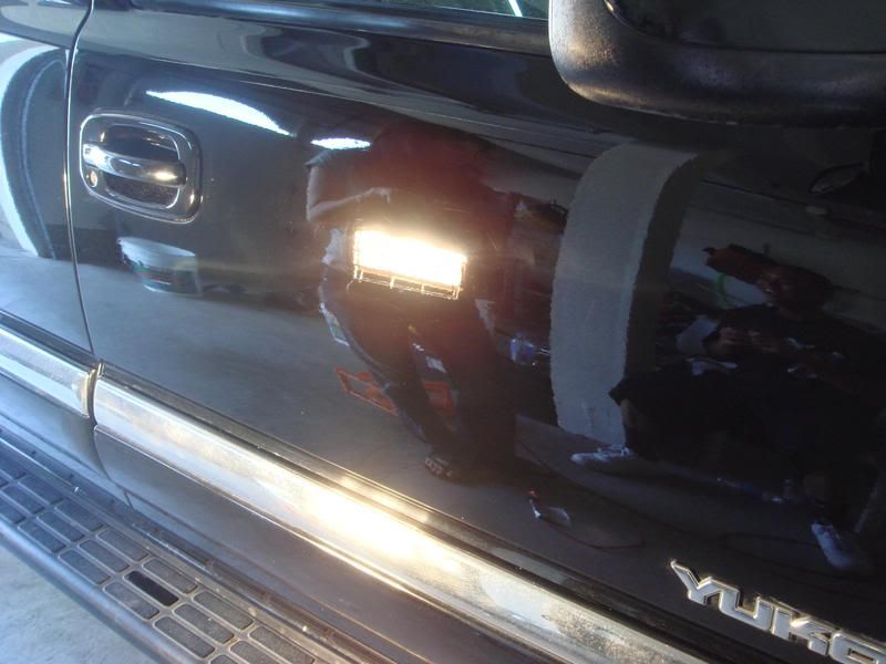

Next,

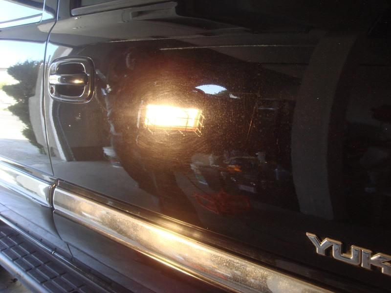

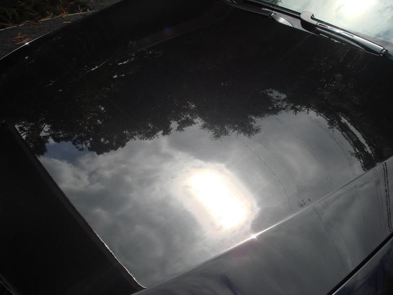

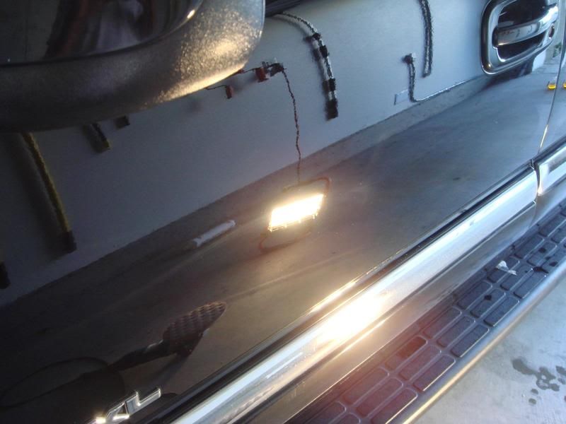

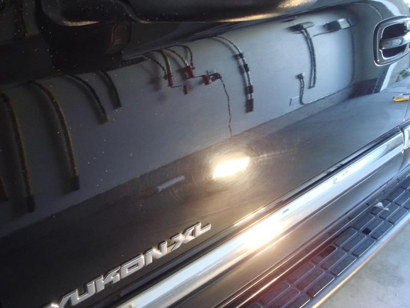

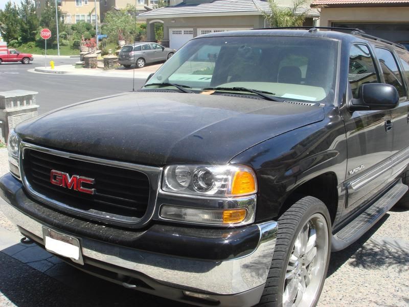

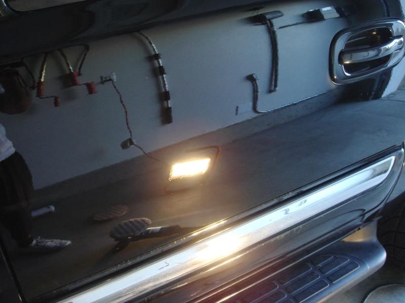

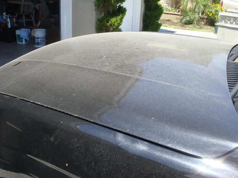

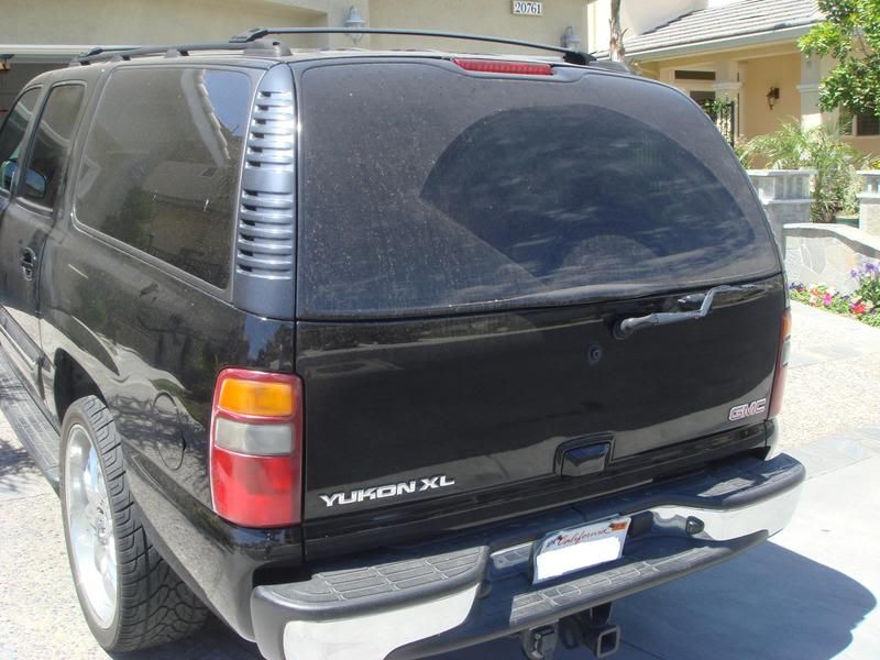

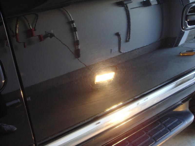

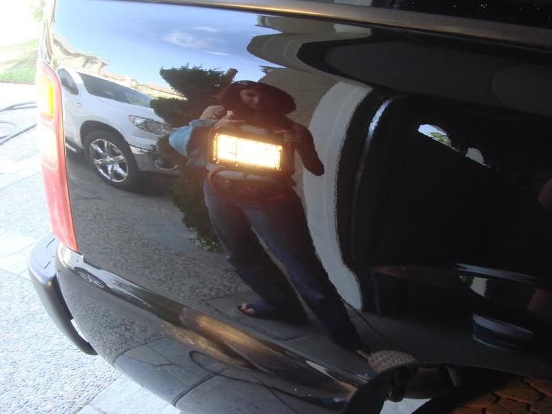

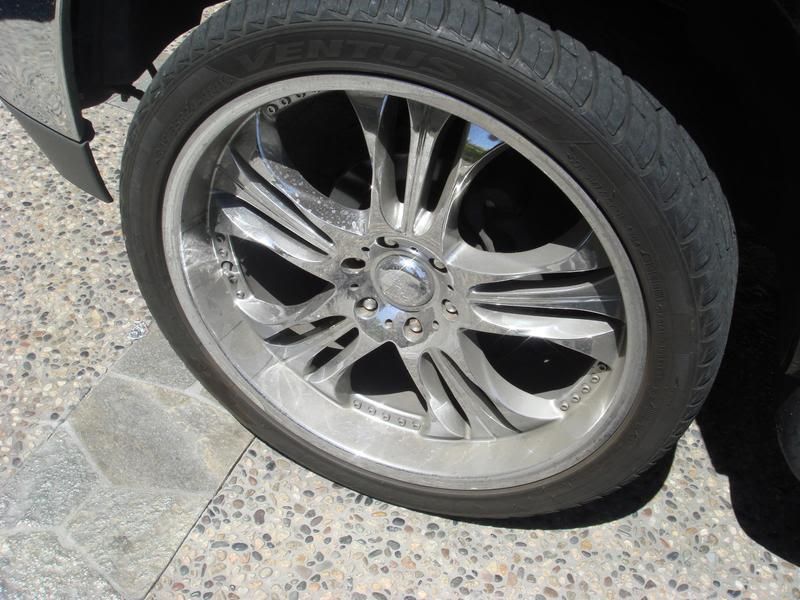

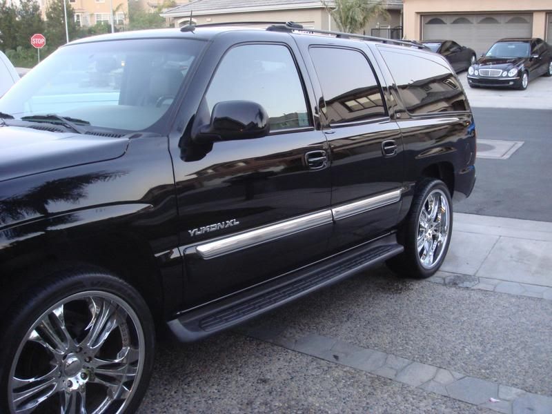

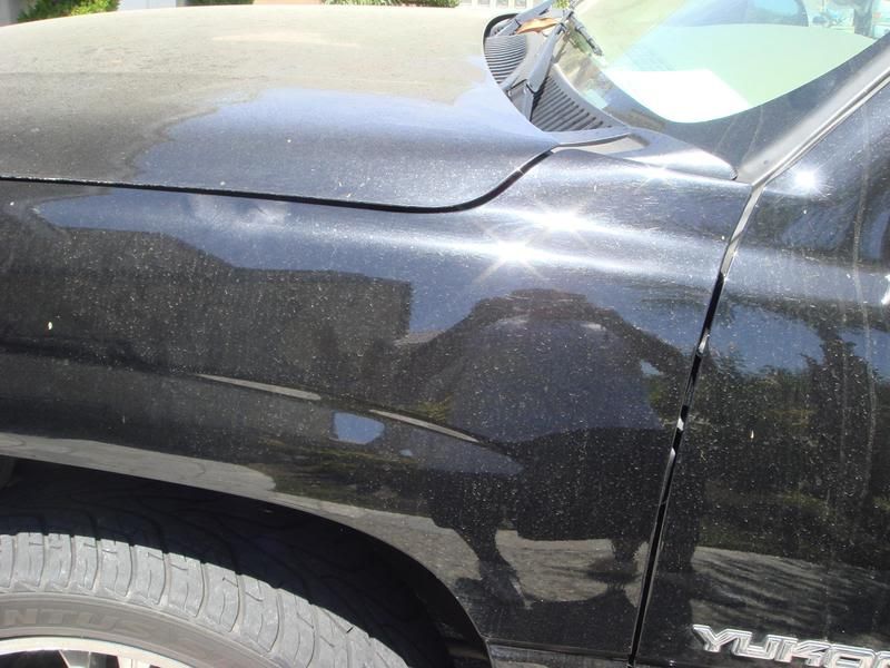

GMC Yukon. This car belongs to my brothers friend. He never washes it, always outside and neglected
Process:
Wash
Clay
SIP w/ orange pad @ 1700 rpm
106ff w/ white pad @ 1400 rpm
z5pro x2

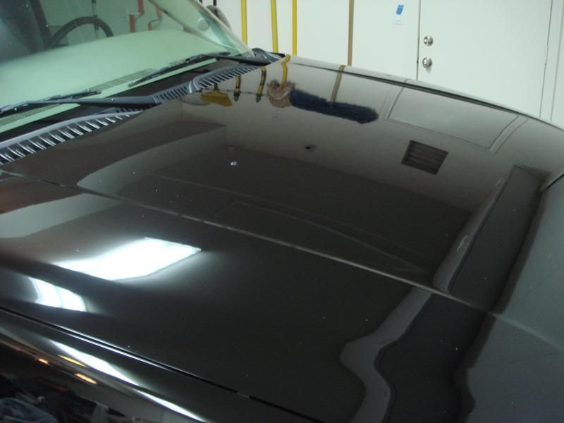

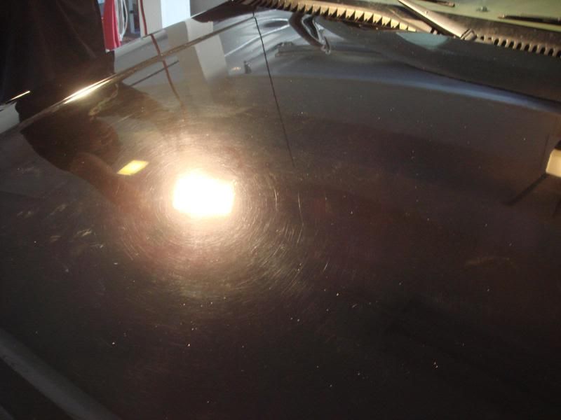

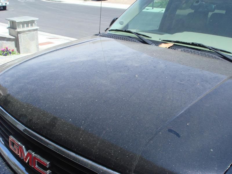

before:
before:
after:
50/50:
after:
before:
after:
before:
after:
before:
after:

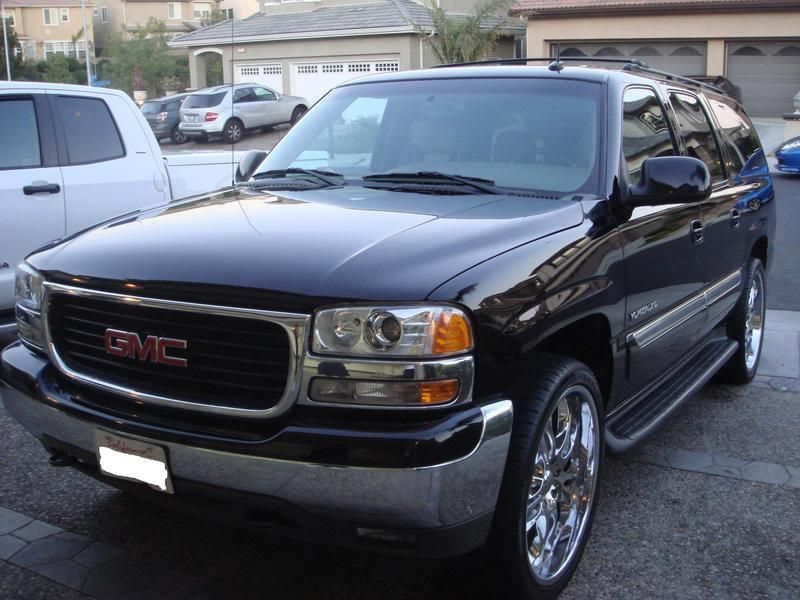

AFTERS:
Wheel wells and exterior trims were not dressed due to lack of light outside. I wanted to take quick pics of the paint before it got too dark
