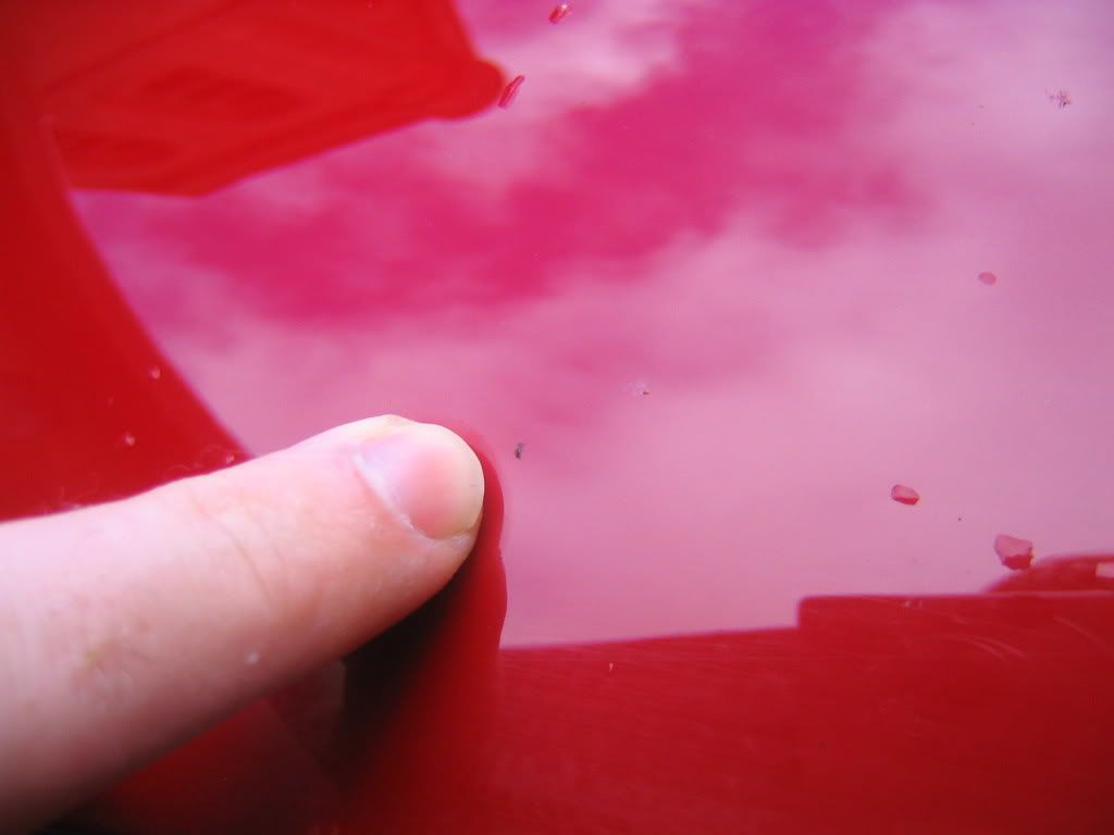

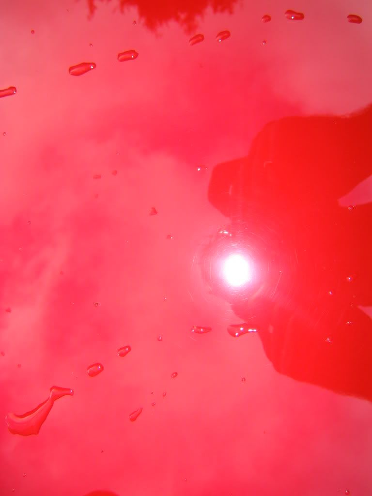

I mean if they leave holograms why did he not lift the grit as well. Its just rediculous really.
After recieving prep'd car there are still cobwebs everywhere. Poor.

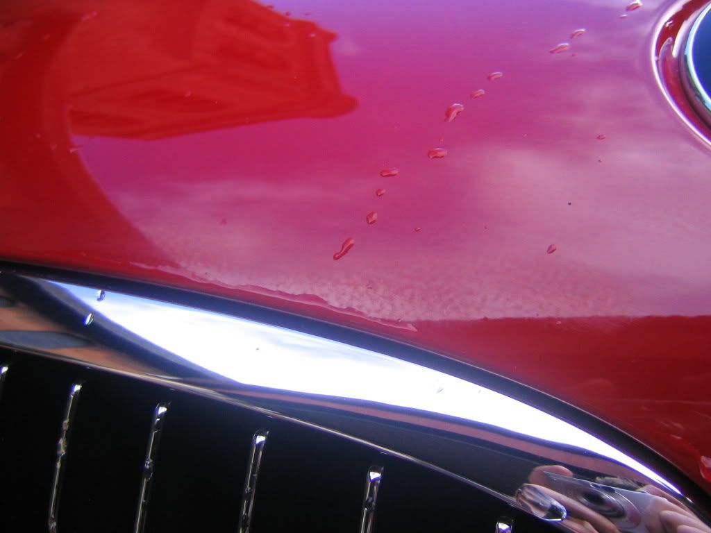

The bit that hacked me off, if you don't know how to wet sand don't even attempt it on a car that is going to a customer, I don't even know if he went through the clear. I simply left this as its too risky to fix, until I get access to a paint thickness gauge.

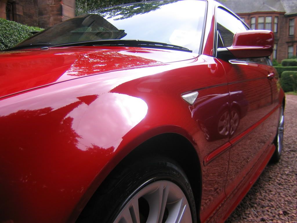

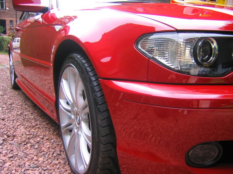

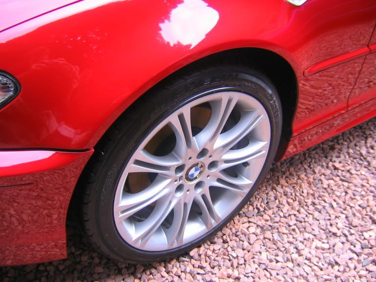

DEEP BREATH ahhhhhhhhhh, the afters. The Bimmer is now back to how it should look.
Thanks for viewing and remember don't let anyone tell you a new car doesn't need detailed.
JJ
Its ok picky man, I got that with the cloth lying on the window straight after.
I think from what it was it looks superb.
Looks great. That part above the front grille where it was an attempted wetsand just looks like its hazy from not being polished out. You can see how the orange peel effect shows through it, but your judgement was good.. better safe than sorry.
Yeh guys do you think that was a 2500, as he hasn't even went through the OP on it. So i though he musta just gave up. Also something interesting I found that he never used a backing pad, as you could see three finger like shapes sanded into the finish.
I guess this is what keeps us in business. I have taken the plunge and bought a rotary so im gonna hit the wet sanding with that when it comes.
Thanks guys.
Wow i like proper red.
I don't know what grit sandpaper they used but it is not close to going through, unless the edge is different ( as you can still see OP). You should never wet sand that close to an edge unless you have to.
I had a look today and it looks as if he has used maybe 2500 and literally two passes.
So Im going to probably polish it out by hand since its so near the edge. :)
