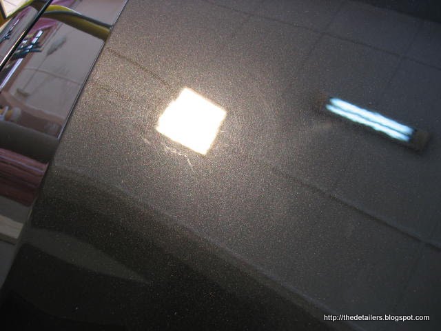

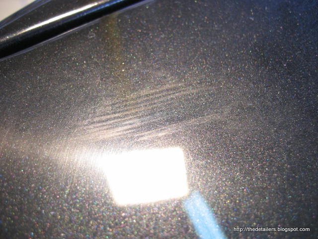

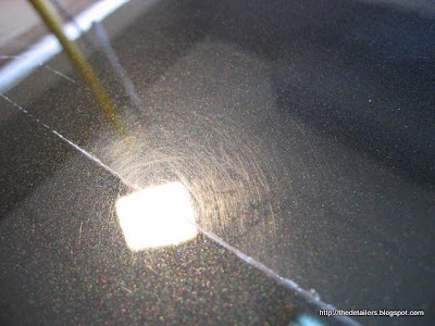

front hood...swrils inflicted by improper wash

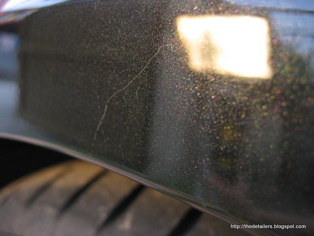

a bruise UDMs
swirls from side door
front panel scratchs

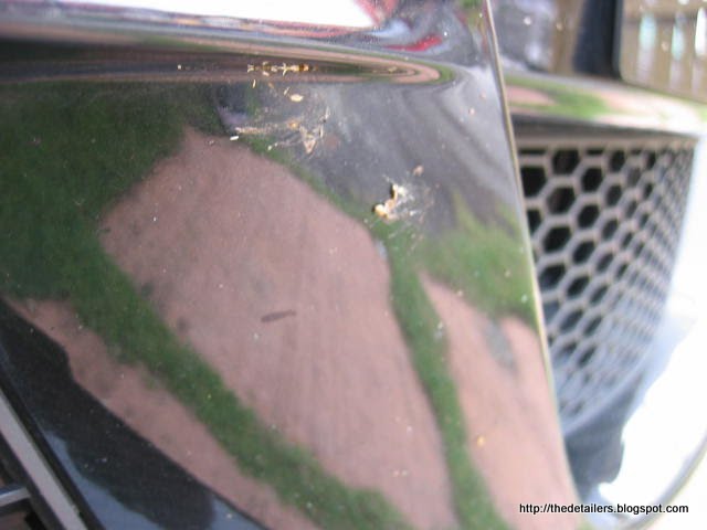

insect saps is also harmful to the paint
grill before
more sticky friends
oppss..its a bug life...

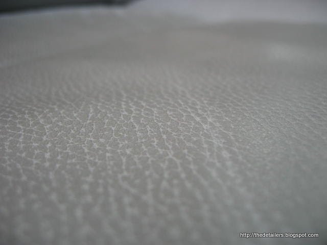

quite a few E90 interior has the issue of stains on the leather seat....I have also check with the technical advisor...he told me many onwers has complaint....even the door panel rubberised surface get peel/worn off easily...prehaps they are meant for germany...i guess

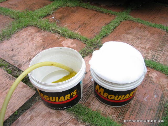

2 bucket wash??
yes...Osren bubble wash premixes with MPC ...to strips off any existing wax prior full paint correction carried out
Menu for the day:-
WASH Osren bubble wash premixes with MPC 3 microfibres cloths

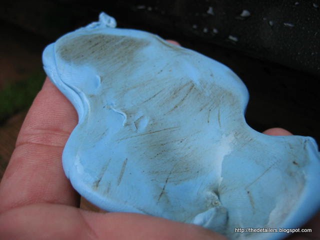

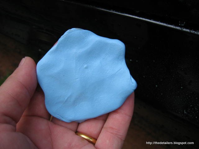

Clay with mild clay

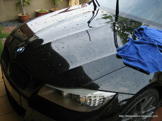

after wash
clay from the hood

.....a second bath.....8 litre & 3 MF

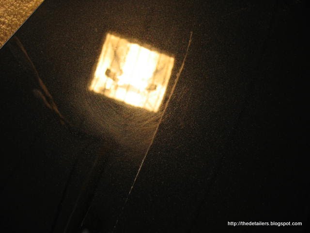

now the actual paint defect u do not see from far away shots & without proper lighting

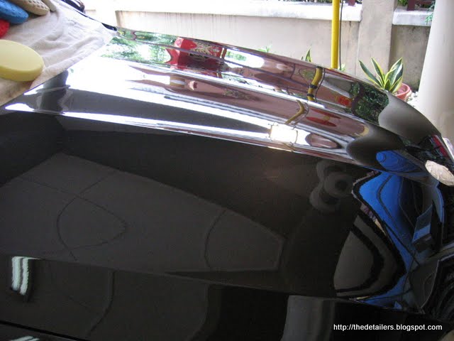

ta da
tada
extremely close up shot..mot prefected yet
from this

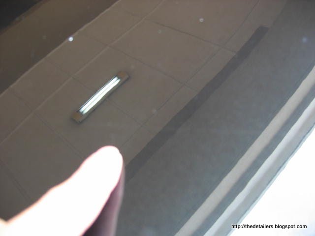

if u could see the paint defect from this light...u must be superman..only he has the super power to do so
BUT sad to say most detailing shop uses this as a guide to swirls & hologram judgement...."Matt Davis, Meguiars Asia consultant once told me......if you cant see, you can correct"...lighting is the most important tool for any detailing
will this work...many will use this lighting to show u .. my cars looks wet & glossy...but is it defect free

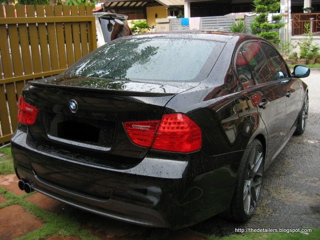

..as he happy his ultimate detail ultimately
Thanks to my friend whom drove all the way to central & in allowing me only to detail his car
thanks buddy for his generousity & kindness & encouragment all the way
to you guys again...for viewing another piece of my detailing art
Great job making her look shiny! Black Sapphire looks beautiful.
Compliments to the owner for a very, very, nicely modded E90 M Sport! :)
