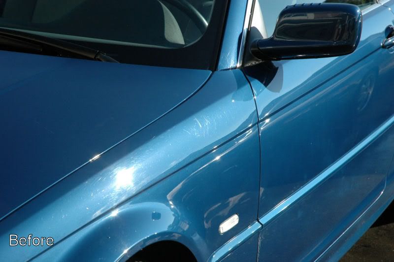

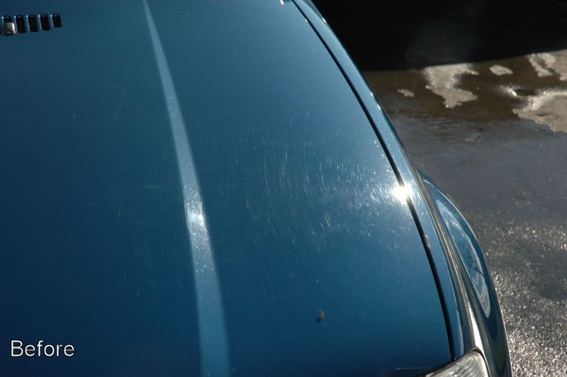

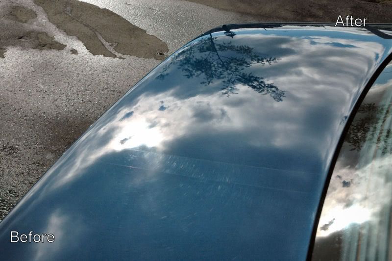

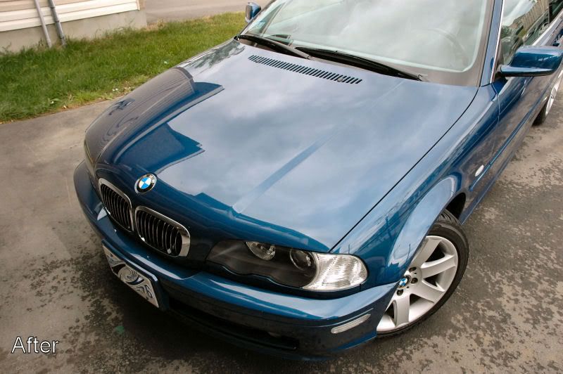

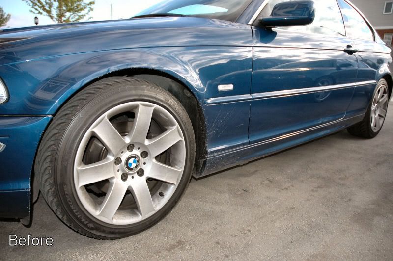

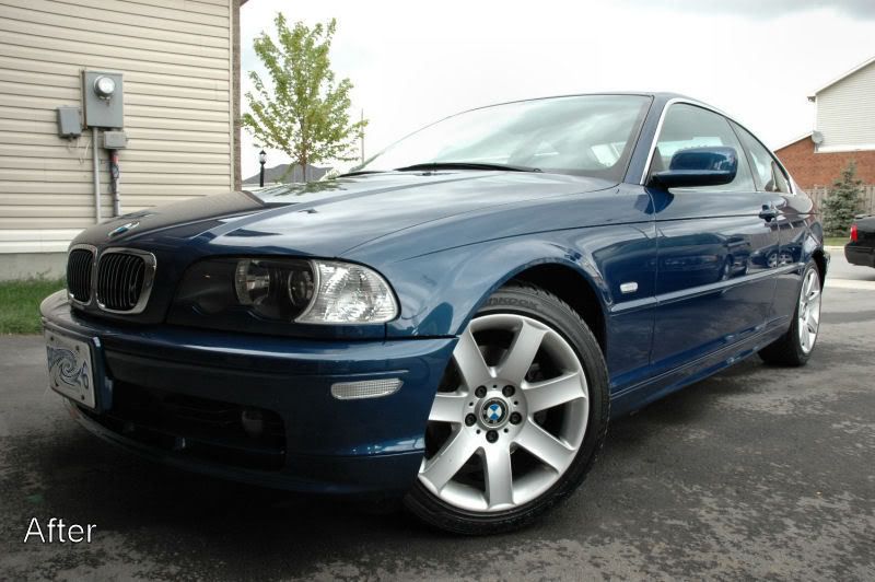

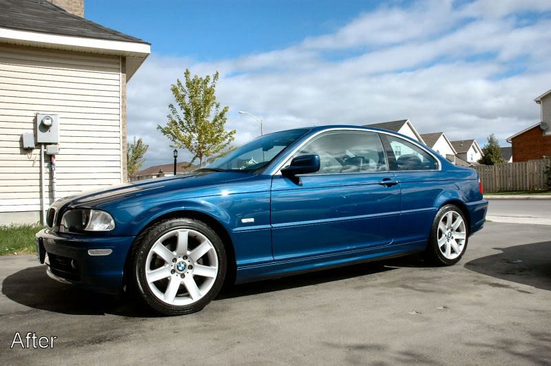

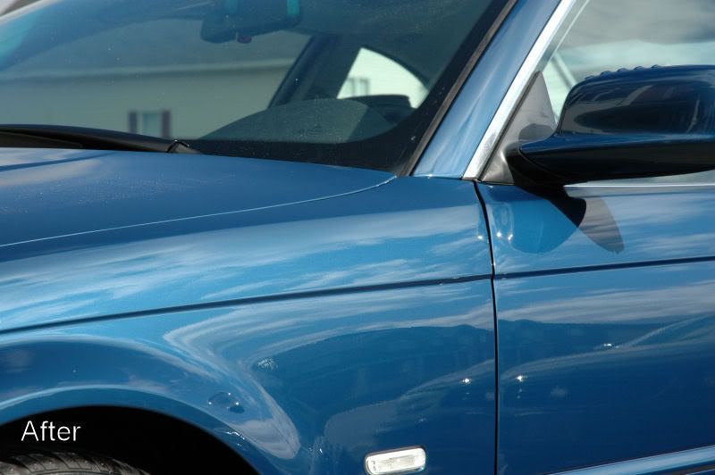

Sep 9, 2007 #1 G gtpaul New member Topaz blue, had scuffs from a car cover and traditional swirls. The sun came and went so it was a pita to take decent pictures. Process: PowerGloss via PC/Yellow speed 6 PO106FF via PC/Orange speed 6 PoliSeal via PC/Black speed 4

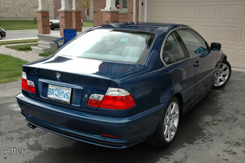

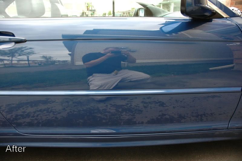

Sep 9, 2007 #3 V .VorteX. New member Nice work. And I agree with smprince1, great work with the pictures. :goodjob
Sep 9, 2007 #4 V VTechFan02 New member And people say you can't correct with Orbitals!! Makes me mad! You did a bang up job on that paint. The 50/50's speak for the selves and the afters are amazing. I know rotaries are faster but Orbitals can do almost as much if you have the time. Great job!! -Frank
