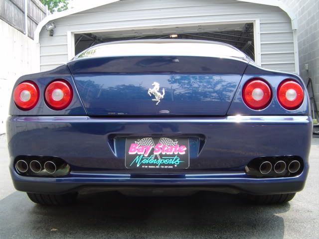

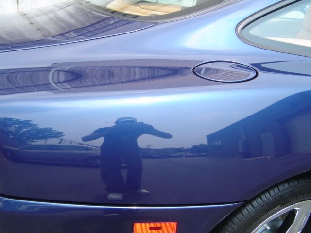

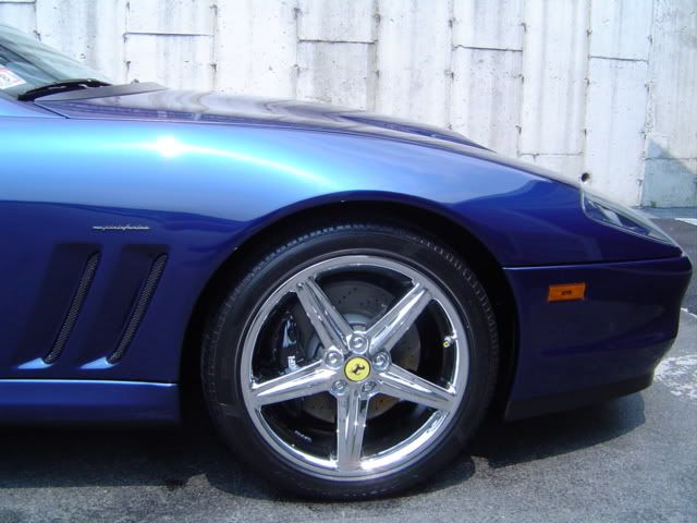

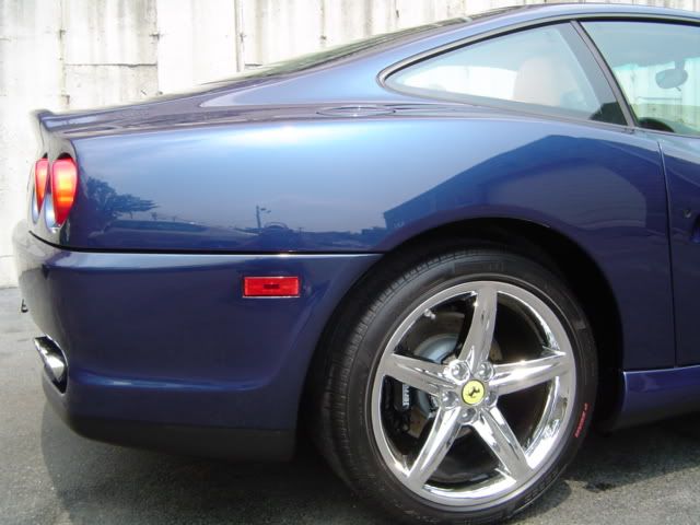

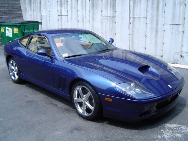

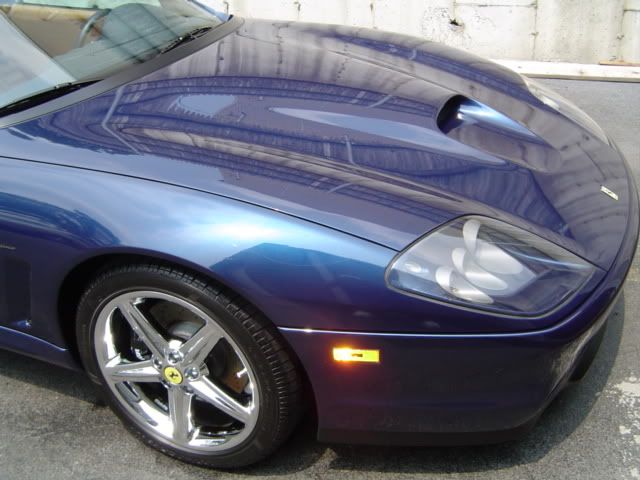

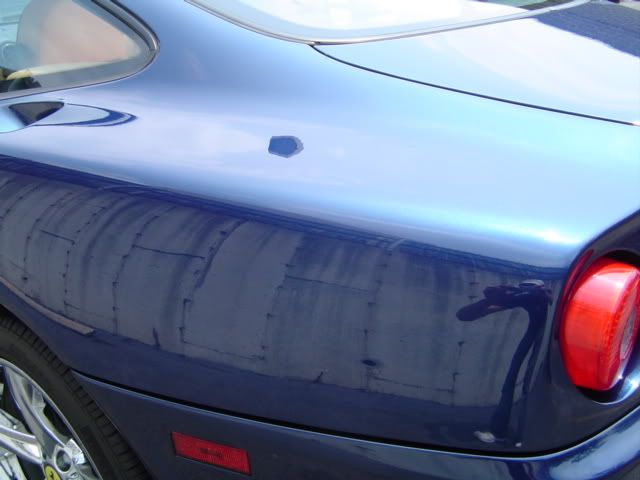

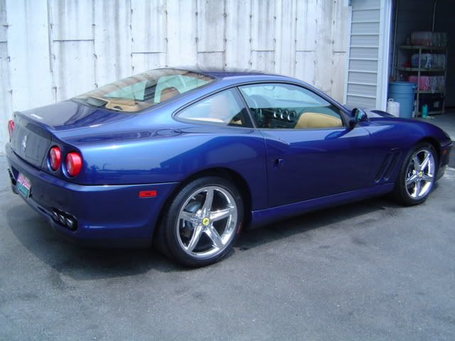

This Ferrari is on consignment at my work. The owner has a new 430 Spider on order, so he decided to sell the car before the new one arrives. The car was in pretty good shape besides a few hairline scratches, light spiderwebbing and some fallout on the top surfaces. There was tons of caked-in wax in all the nooks & crannies which wasn't fun to get out.
All in all it was a pretty enjoyable detail.
Here's what the detail consisted of:

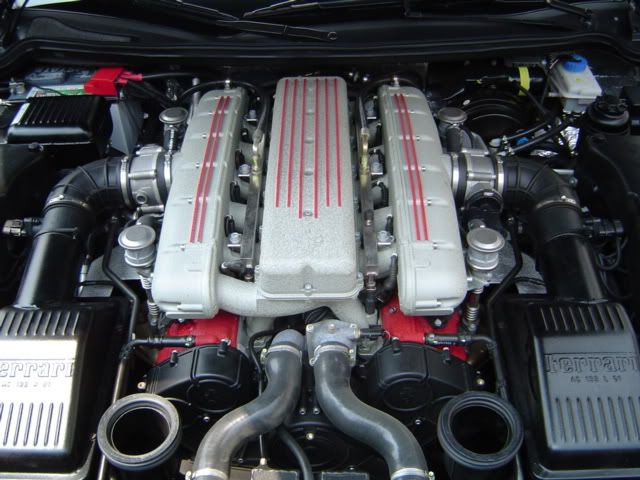

Washed exterior & cleaned engine compartment
Clayed with Kar Kraft clay bar
Buffed complete exterior with IP/RMG mix (70% IP/30% RMG) using foam polishing pad @1600 rpm
Buffed complete exterior with FP II using a foam finessing pad @1400 rpm
Z2 pro (ZFX'd) x2
Super Blue dressing on tires & wheel wells
Werkstatt's prime on wheels

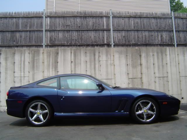

I like the Maranello...it has that retro body line to it. Reminds me of old Aston Martins.
However, I don't like the wheels. They don't scream Italian Ferrari to me...more American Camaro.
Is that a straight blue?
