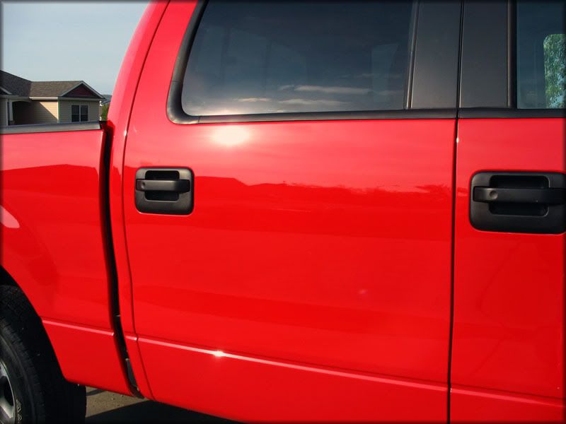

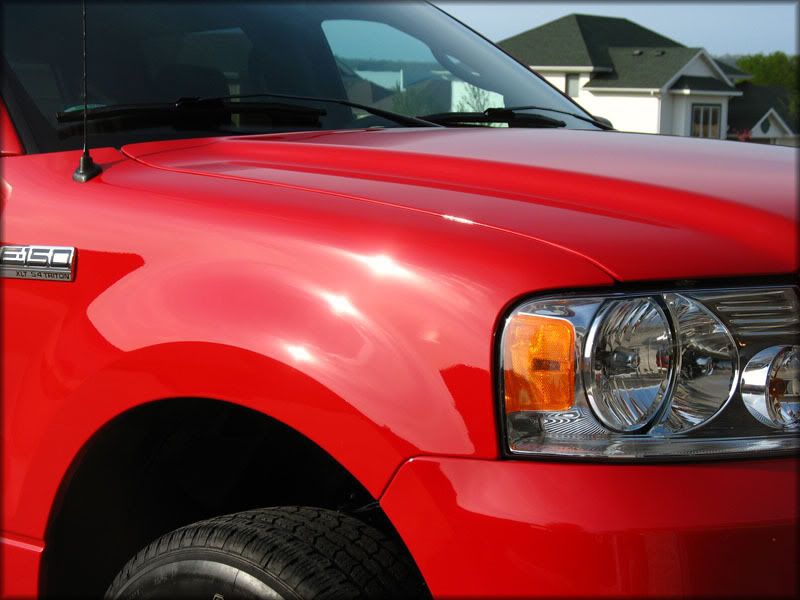

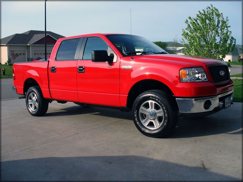

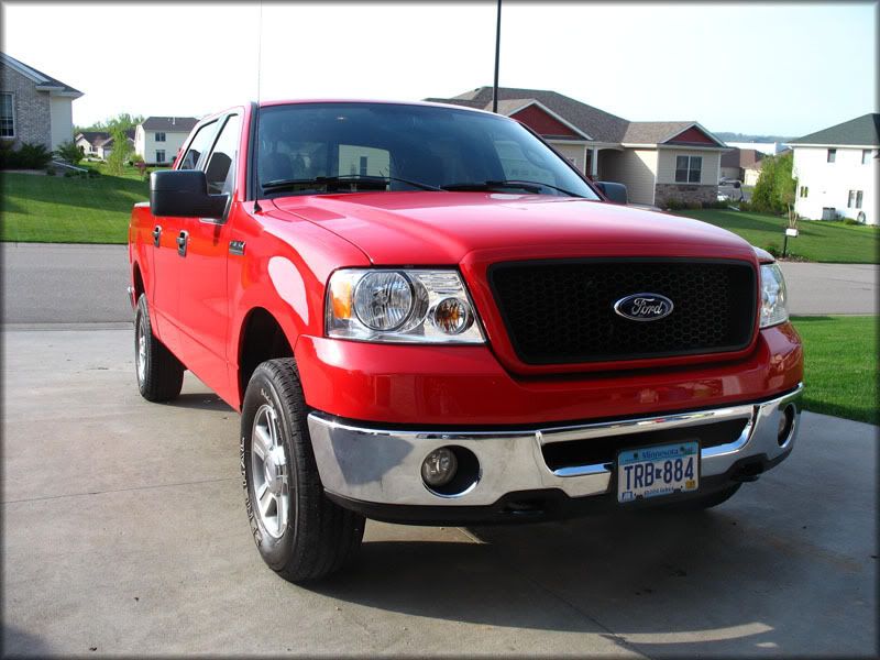

Exterior:
Dawn Wash
Z18 Clay
106ff
ZAIO
Z2pro
Z-CS
Z16 on tires and wells
Plastic treated with Z14 plastic polish and dressed with Z16
Glass treated with Z12 glass polish
Chrome got ZAIO
