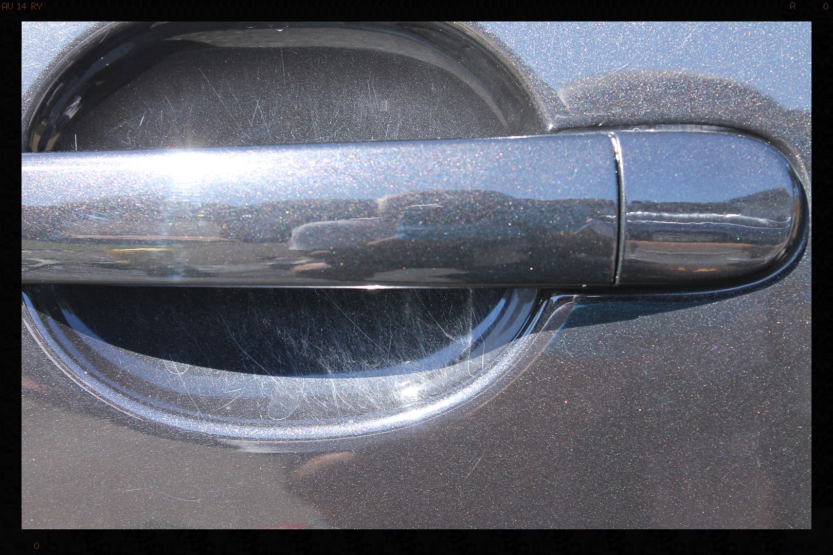

And how hammered the paint was - swirls, horrendous buffer trails, some bird dropping etching and plenty of RIDS cry:
