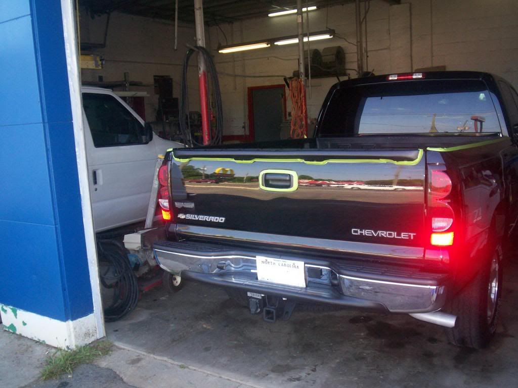

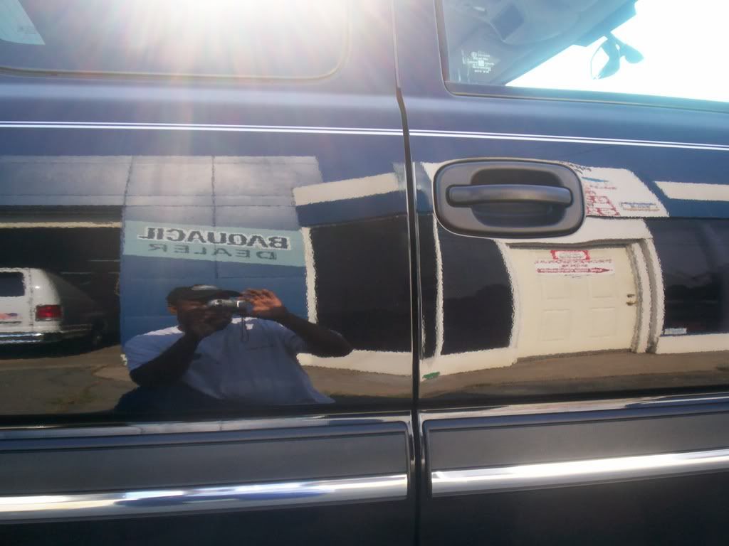

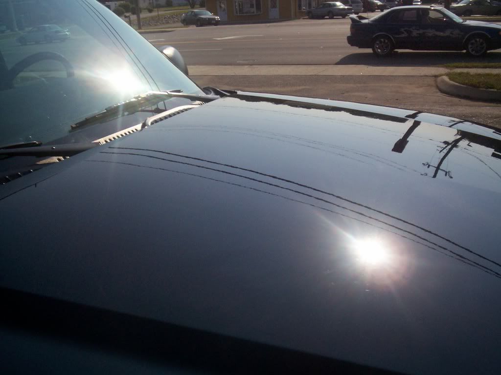

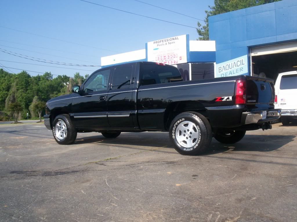

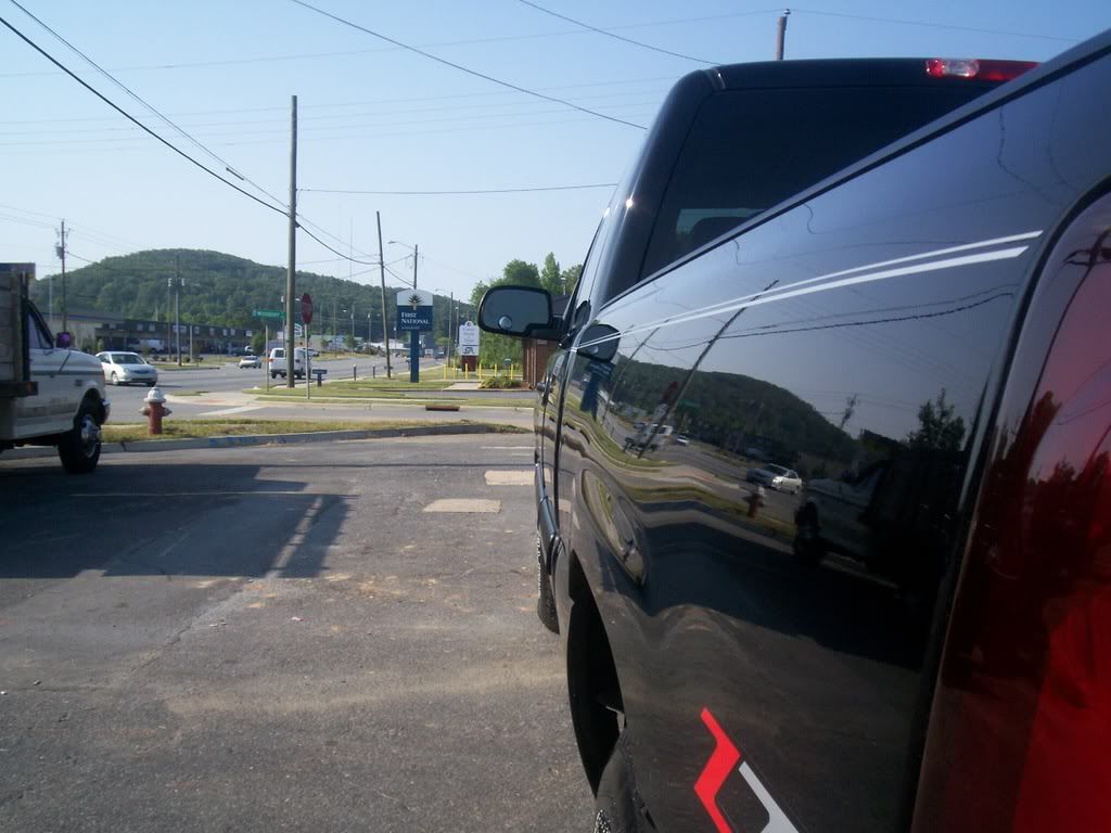

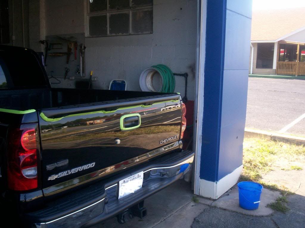

sup all sorry i dont have any before pics i had to jump right in and get to work.
this is a customer that i had done when i 1st started detailing about 1 1/2 yrs
ago. honestly i thought i didnt impress him enough back then because i didnt
know how to remove swirls that good but i must have done something right cuz
he got a new silverado and asked me to do a full detail on it. he had 2 requests, 1- dont
shampoo (hes in the carpet cleaning biz he said he going to steam clean it), 2-dont
use a rotary he liked how i did it last time. i told him no prob and we set out to work

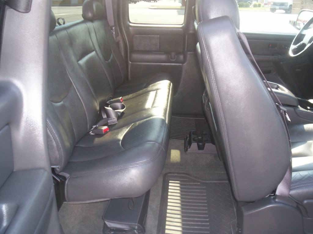

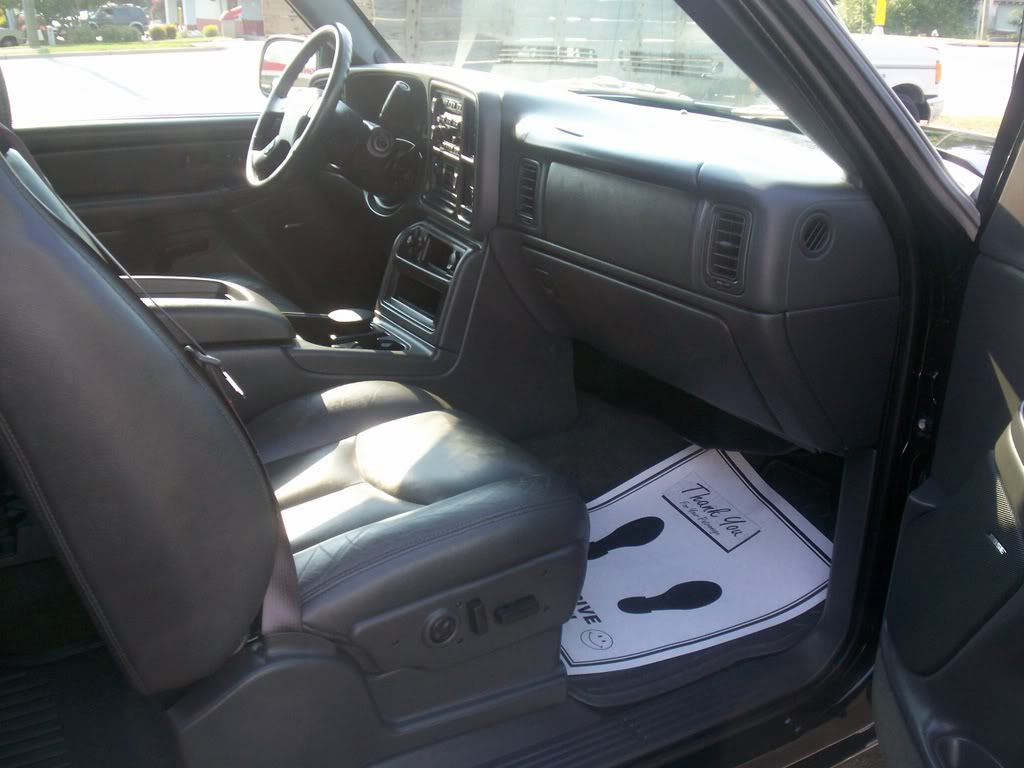

Process Interior
vacuum
wipe down with all purpose
dress with super shield then wipe off residue

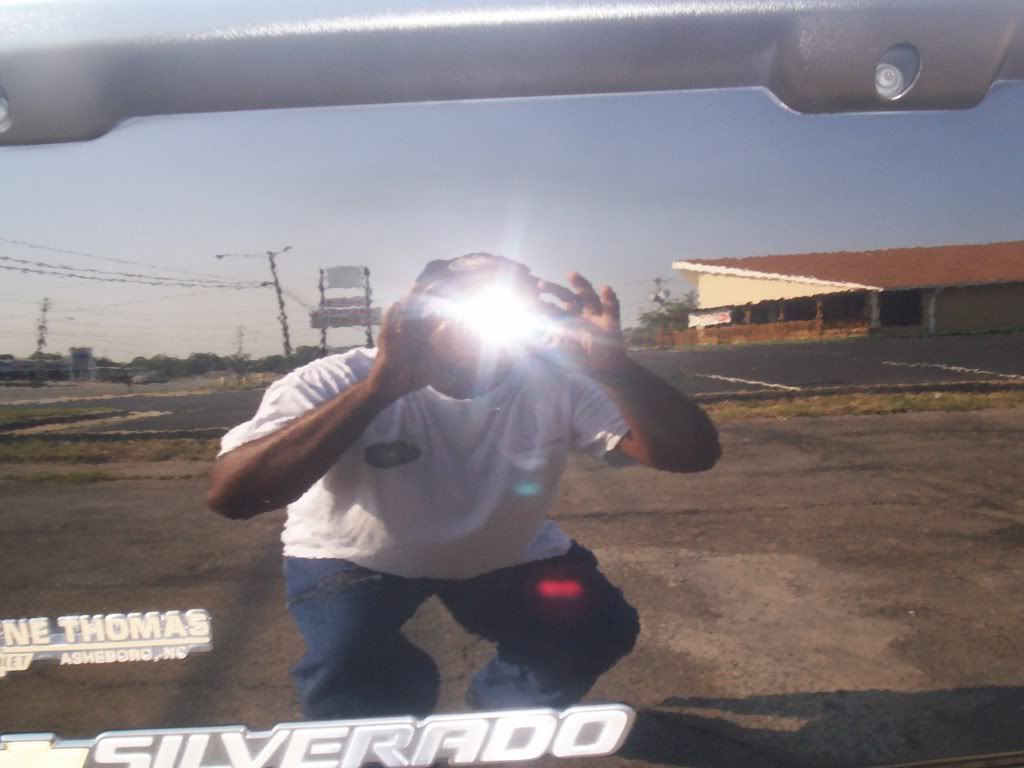

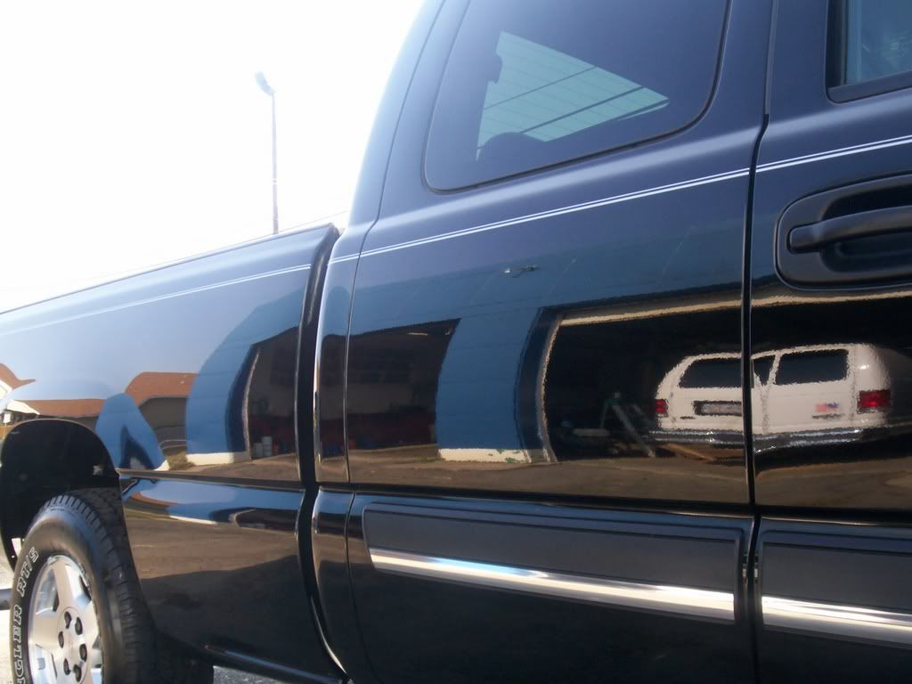

Process Exterior
wash & clay
IP via cyclo yellow pad
IP via cyclo green pad
3m fine cut compound via cyclo green pad
FPII via pc white pad @ 6
3m SR dark via pc white pad @ 6
Blackfire Gloss Enhancing Polish via pc black finesse pad @ 3.5
Blackfire APP via pc red finishing pad @ 3.5
trim renewed with malco shine it dressing
chrome polished with mothers chrome polish(dont sleep on mother's products)
fenders dressed with super shield
tires dressed with armor all detailer's advantage foam spray
windows clean and buffed with stoner IG
rims polished with honda spray cleaner and polish
whoooh thats alot
