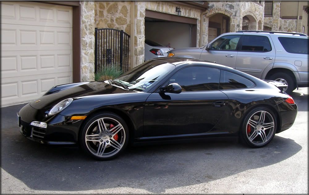

Black
scheduled for 2 step correction , was improper washed , deep scratches on rear quarter.
flex da with polish pad and sip follow by da with polish pad and 205.
duragloss 105 as protection.
Paint condition before: stain on door , severe swirls and scratches everywhere ( in pic the hood)
All pictures are after:
