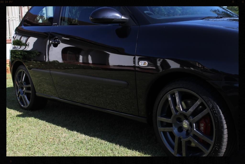

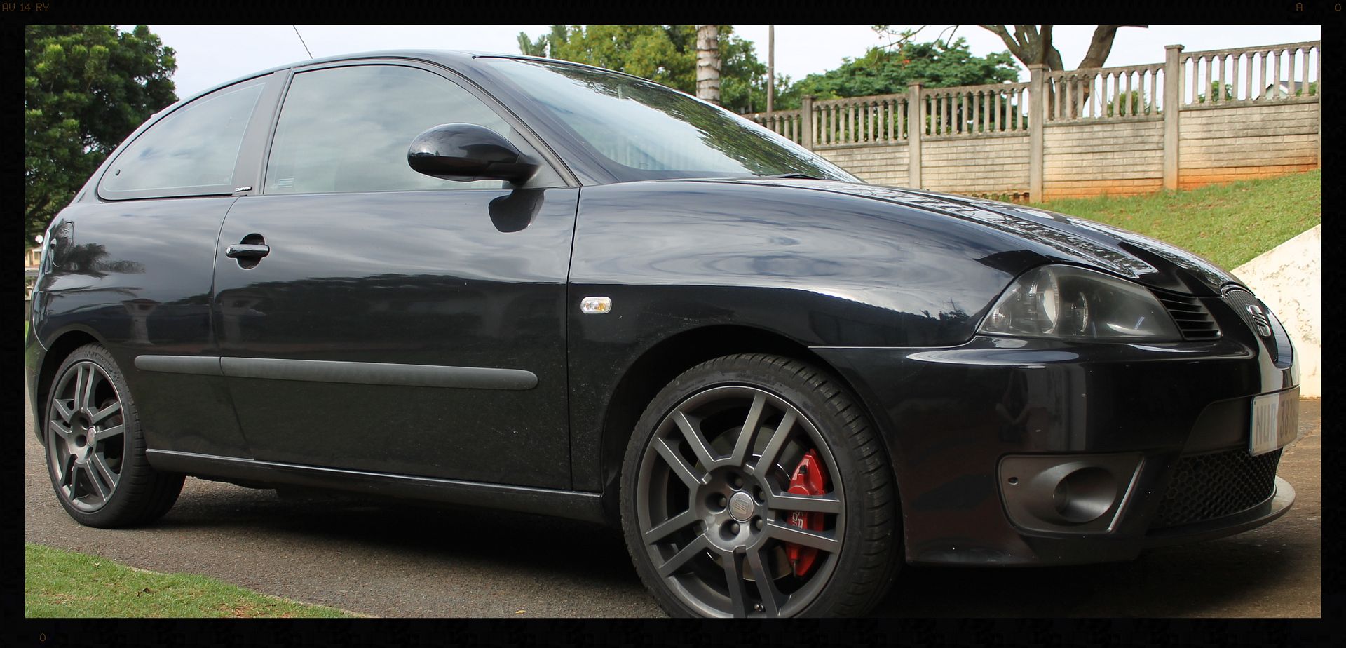

As far as paint correction goes, this detail was right up there with some of the toughest I have done - but this is also what makes it so rewarding.

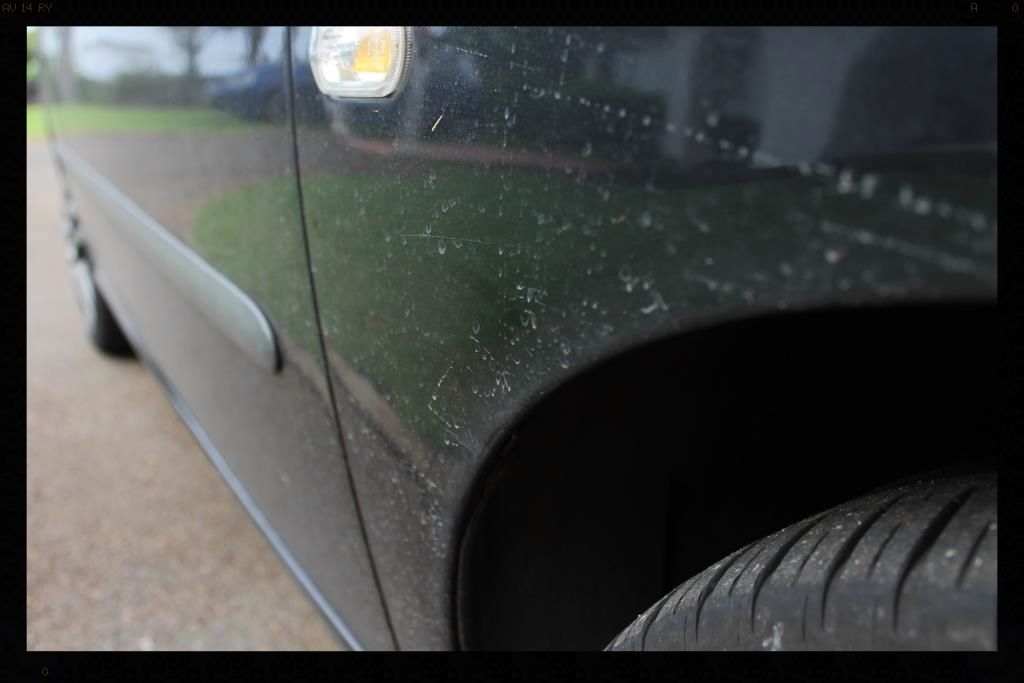

So this is how she looked on arrival.
There was the usual dirt

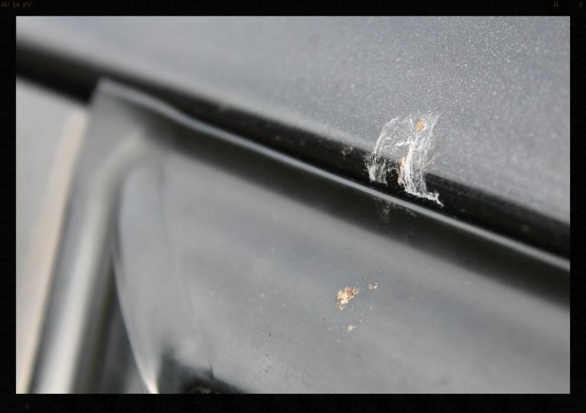

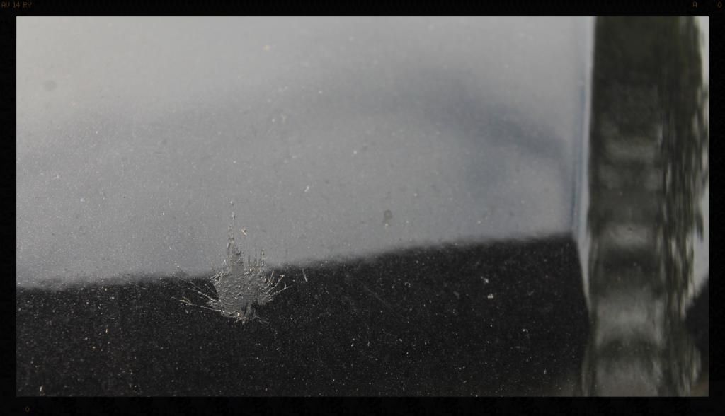

Some bird droppings

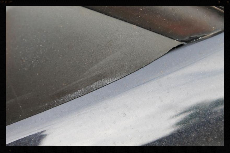

Small signs like this showing that the previous person didn't bother taping up

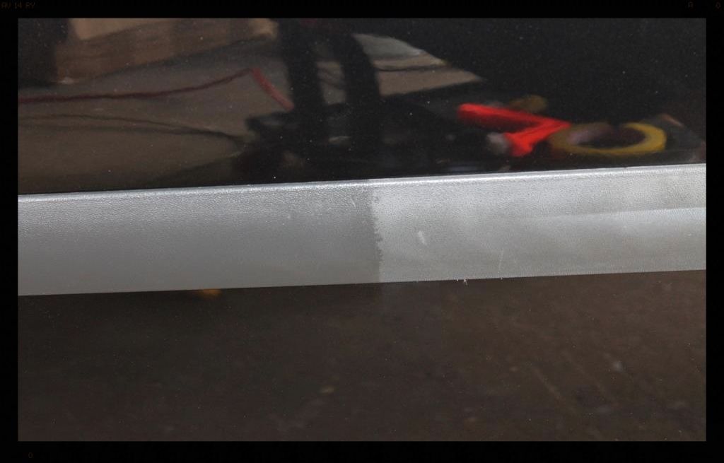

And then this was a first for me..... the caveman had simply polished straight over the side beading
:bang:

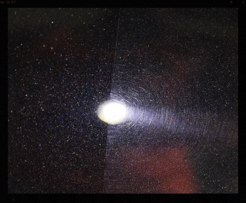

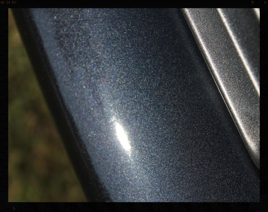

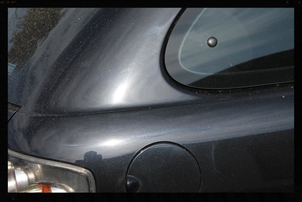

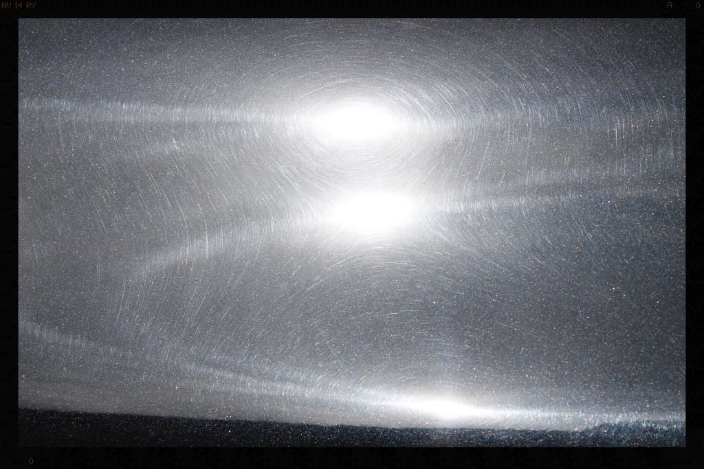

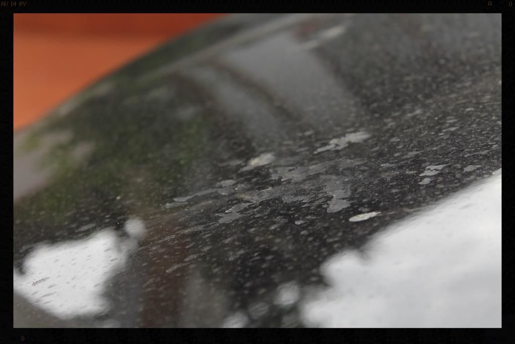

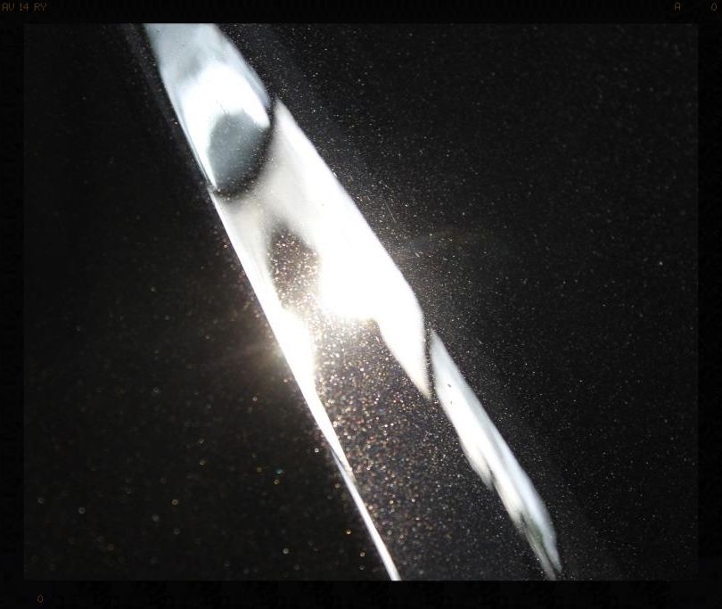

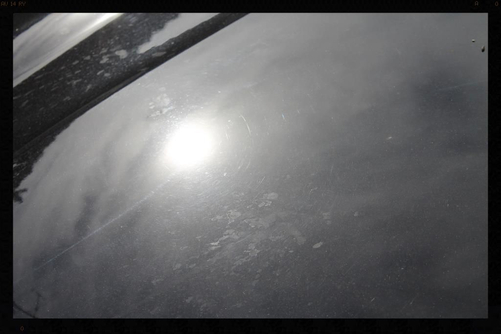

All relatively 'typical' so far.... so let's look at the paint, which for the record had the obligatory swirls, some deeper scratches, etching marks, sanding marks, pigtails and buffer trails....
Even through the dirty paint the sanding marks are visible

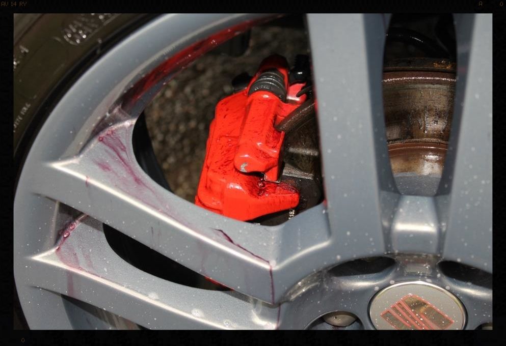

During iron removal

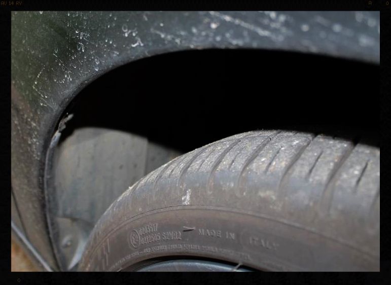

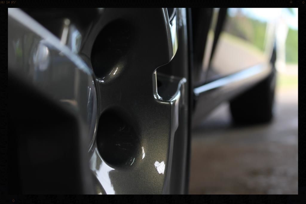

Arches, Tires, Wheels
-HP rinse arches, tires and wheels.
-Clean arches with a Cyclo APC using a Mothers Fenderwell Brush
-HP rinse (a lot)
-Clean tires with Valet Pro Billbery Wheel Cleaner @ 1:6 and a Mothers Tire brush.
-HP rinse
-Repeat tire cleaning
-HP rinse

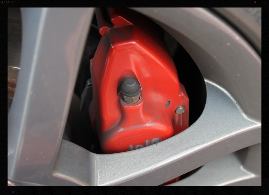

-Wash wheels and brake calipers with VP Bilberry Wheel Cleaner @ 1:6, Daytona and Daytona Jnr brushes and Valet Pro Boars Hair Brushes
-HP rinse
-Dry
-Remove tar using Autoglym Intensive Tar Remover
-Spray with APC and HP Rinse
-Dry
-Remove bonded and embedded ferrous contaminants on wheels and brake calipers with Autofinesse Iron Out, Daytona (big and small) brushes and Valet Pro Boars Hair Brushes
-HP Rinse + flood rinse
-Dry
-Polished with Meguiars Cleaner Wax
-Protected with Menzerna Powerlock
-Tires dressed with 3 coats of Optimum Tire Sheen (It literally had sucked the first coat in on the first tire before I had finished dressing the last one

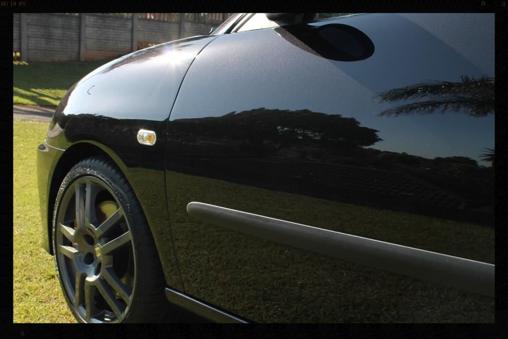

After

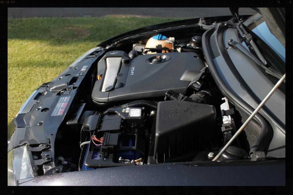

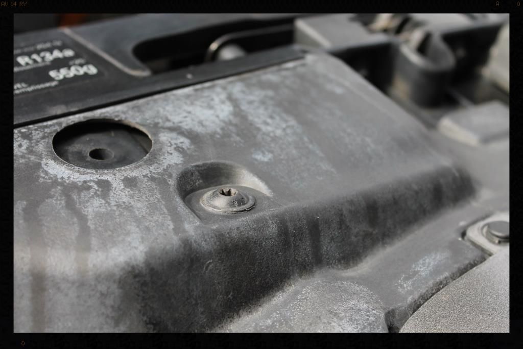

Engine bay
-Blow loose dust off with air blower
-Clean with Cyclo APC, MF Towels and various Brushes
-Clean/Polish/Protect (AIO) using AF Tripple by hand with a MF applicator
-Dresed with Autofinesse Dressel
Before
After

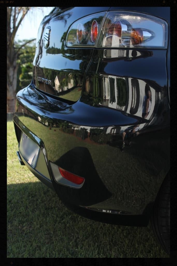

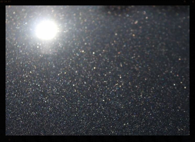

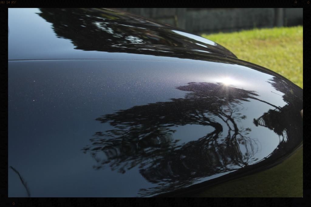

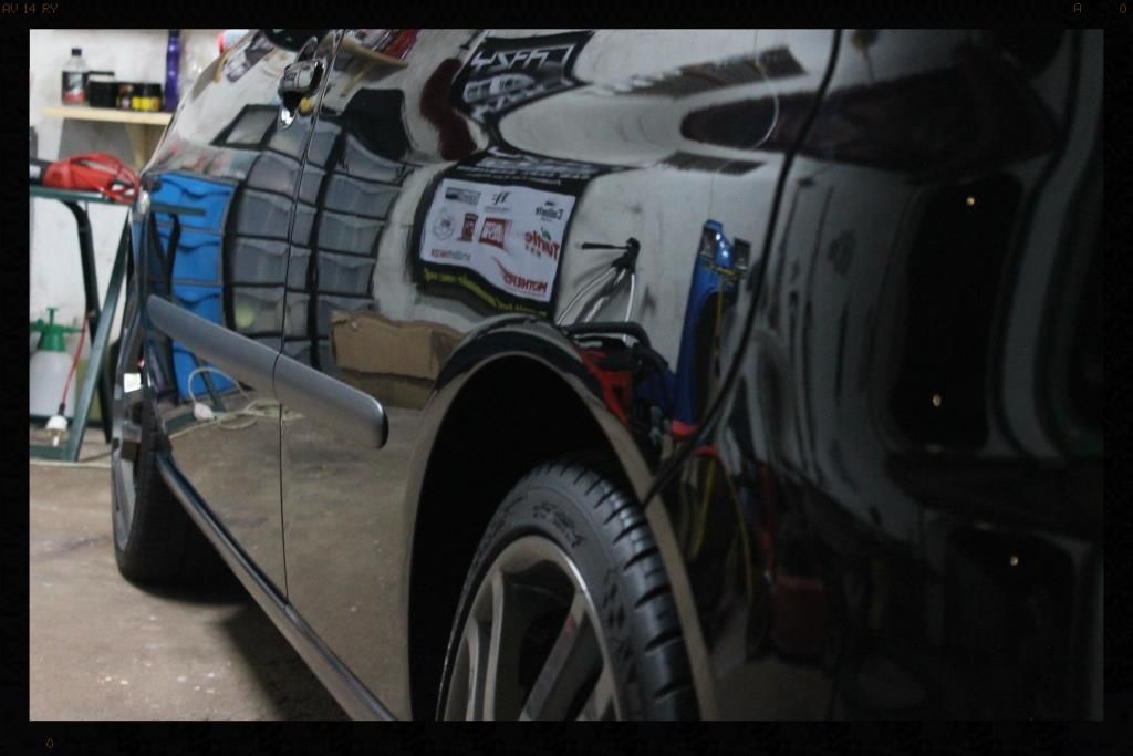

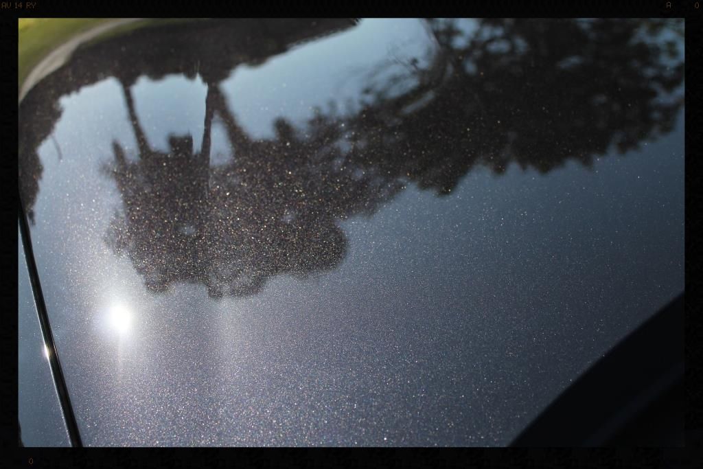

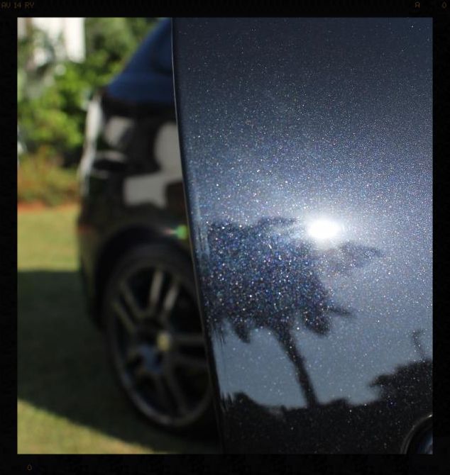

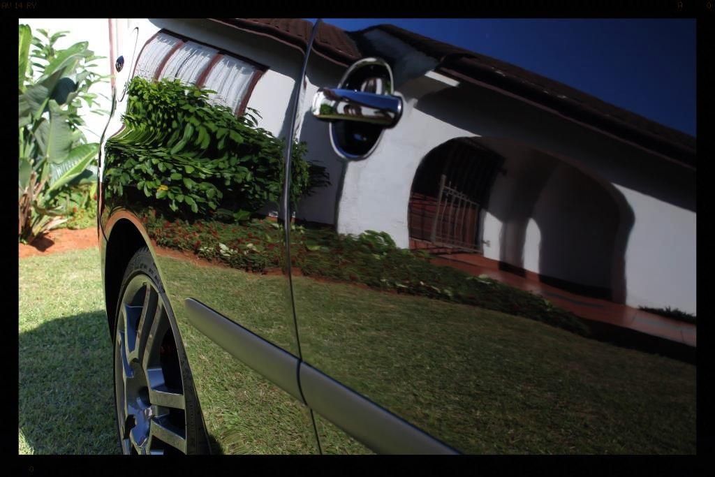

Paint correction
- Paint readings were all over the place, due to the repainting that had been done, the crappy sanding and polishing thereafter and the general 'wear and tear'. The lowest reading was 106µ and the max 264µ
- The initial cut required the Flex 3401 / Menzerna FG400 / Lake Country Purple Wool Pads and more than 75% required a second hit with the same combo
- This was then followed by Flex 3401 / Menzerna SF4000 / 5.5" Crimson Lake Country Hydrotech pads. For the smaller areas 4" Orange and White Lake Country CCS pads were used with same polishes on a Shield DA and for the remaining tight spots, polishing was done by hand using Meguiars Ultimate Compound
[/URL]

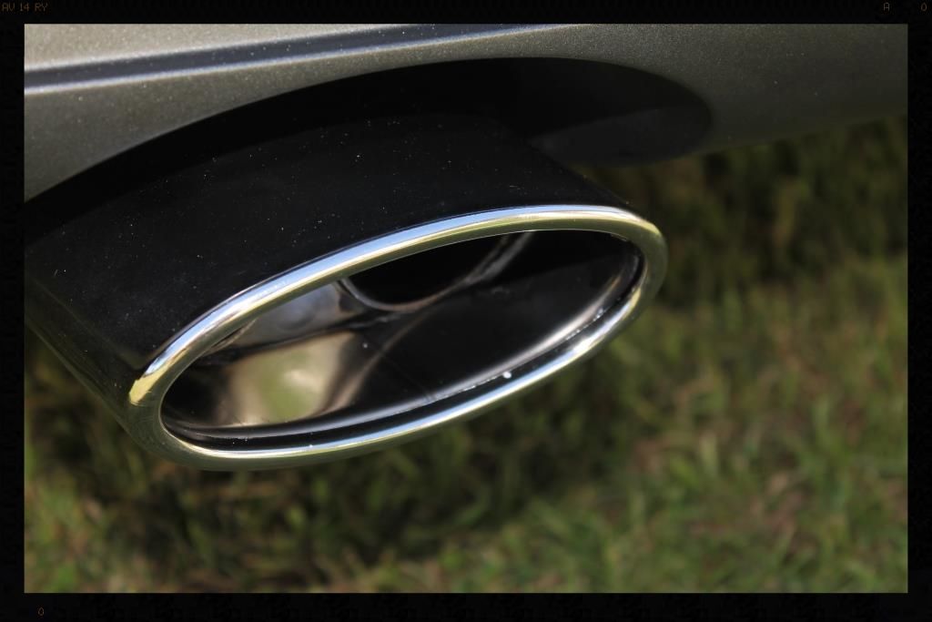

Exhaust tip
-Cleaned using Cyclo APC
-Polished and Protected using Meguiars NXT All Metal Polish

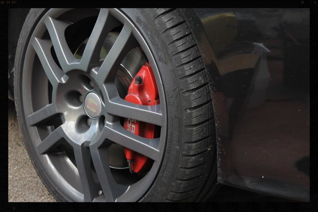

-HP rinse (a lot)
-HP rinse
-HP rinse
-HP rinse
-Dry
-Dry
-Dry
After

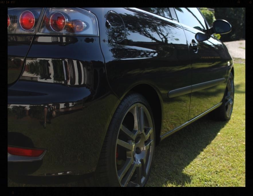

Before
After
