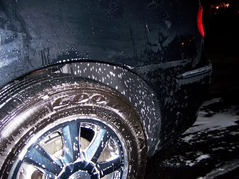

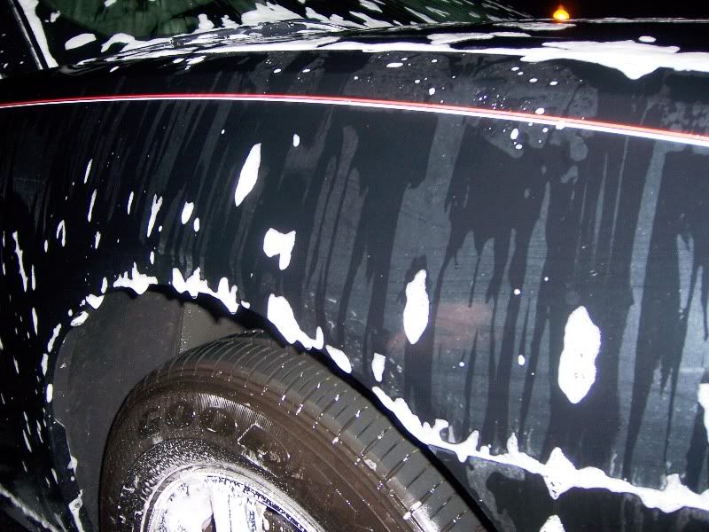

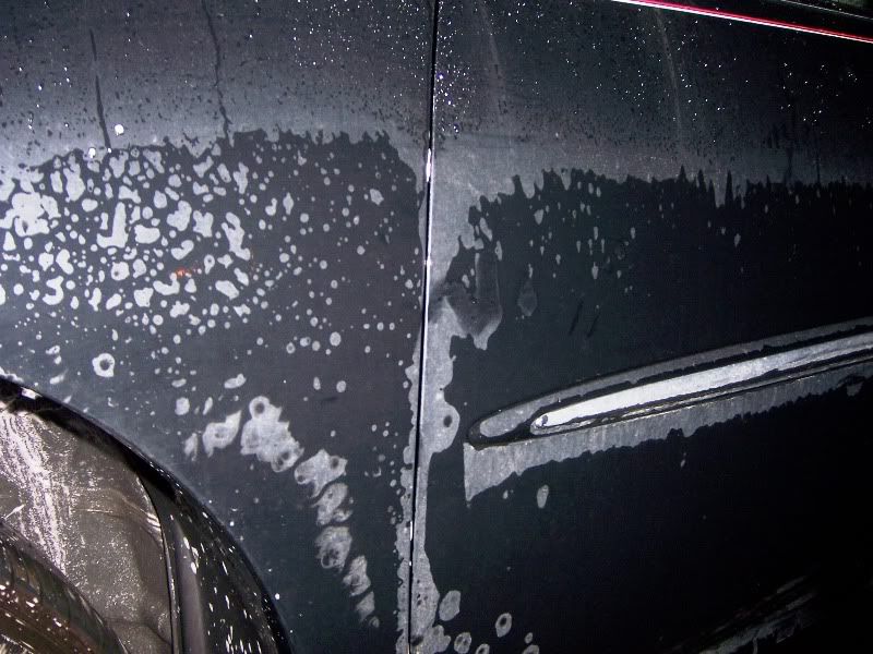

Here are a few shots as we got started:
Pre-Wash: Bug Squash/SS&S via Foam gun. We let it dwell for about 5 minutes. It barely dented the grime.
Wash:
SS&S mixed with a cup of white distilled vinegar in the foam gun. I foamed and greg washed the paint with a few mitts. The paint was already swirled/marred, so we went quick.
Optimum Clay on all of the flats. TONS of rail dust & other contaminates were in the paint. The flats felt like sandpaper.

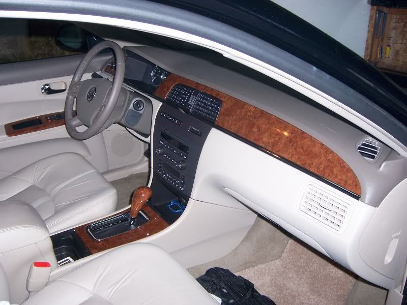

Interior:
Steam on carpet spots, interior glass, and stains on the hard plastic.
Everything (except the glass) wiped down with Meg’s Quick Interior Detailer.

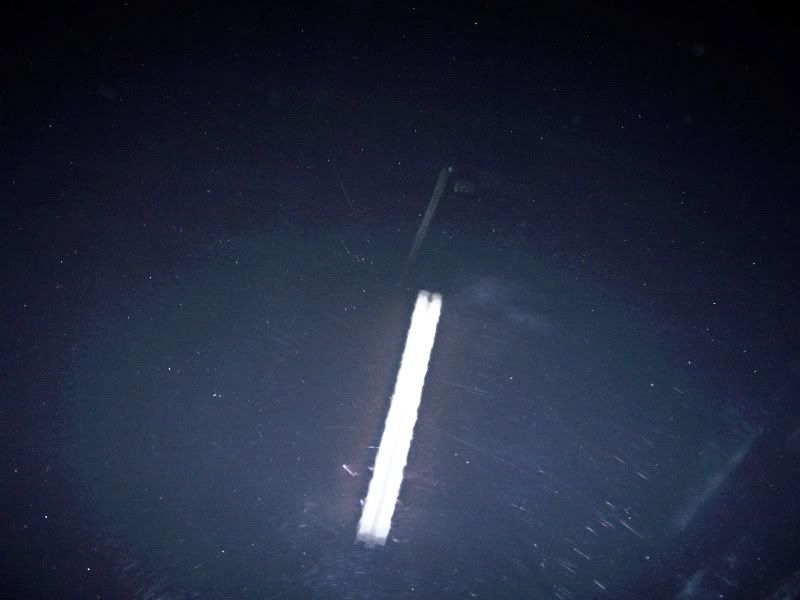

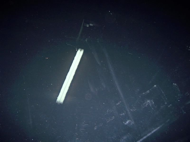

Here are a few pre-polish shots:

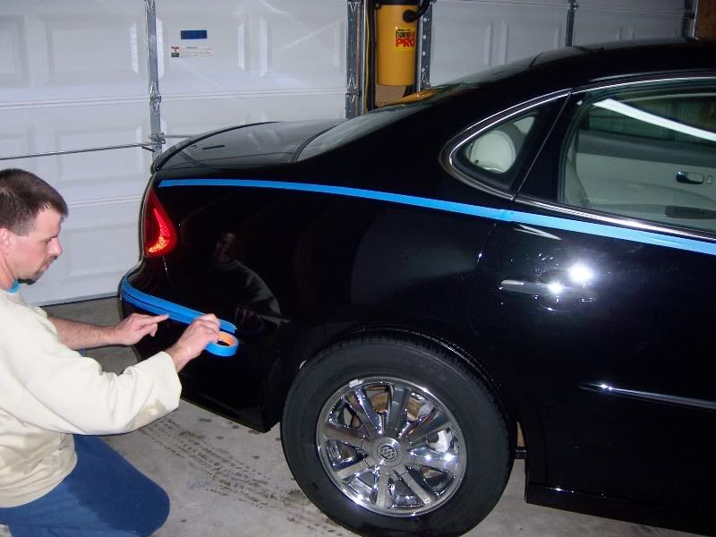

A shot of Greg taping up the beast:
Metabo 700-1400 RPM using IP (Green LC 7.5 light cutting pad)
PC @ 3-5.5 using ZPC (White LC 7.5 polishing pad)
This took 2 of us about 90 minutes. We polished out a side at a time before stopping to wipe down. The hood and a few areas needed 2-3 passes. We both noticed that as you start to break down ZPC, back down the PC from 5.5 to 3 and it ‘sets’ up and lays down a very nice looking gloss.

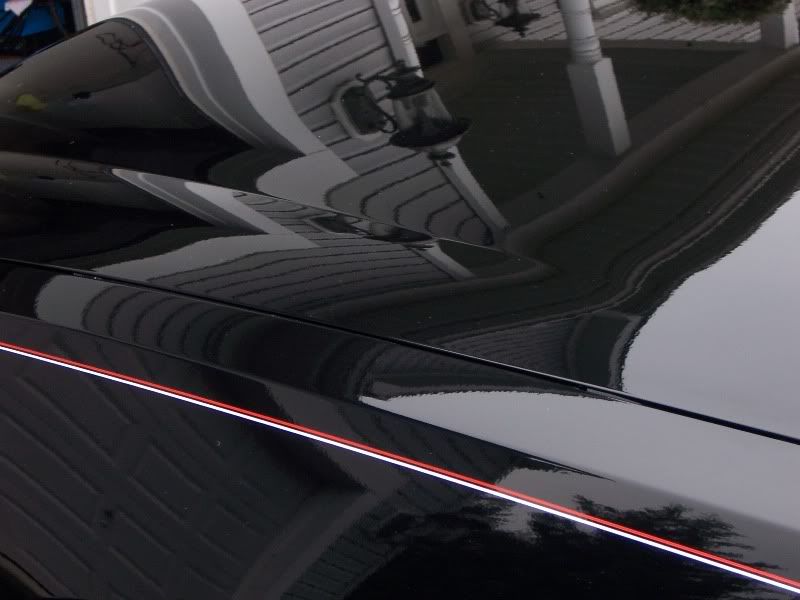

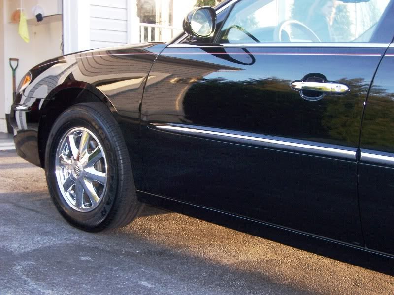

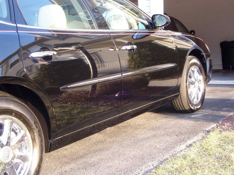

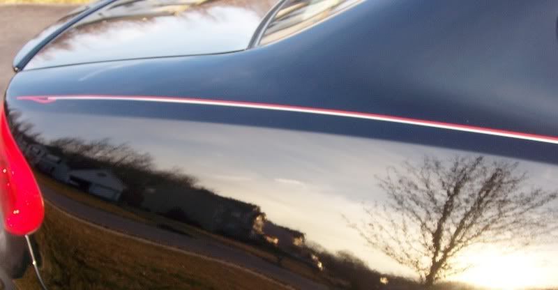

A few side shots:

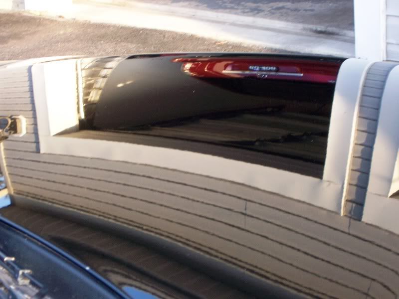

Hood Shot:

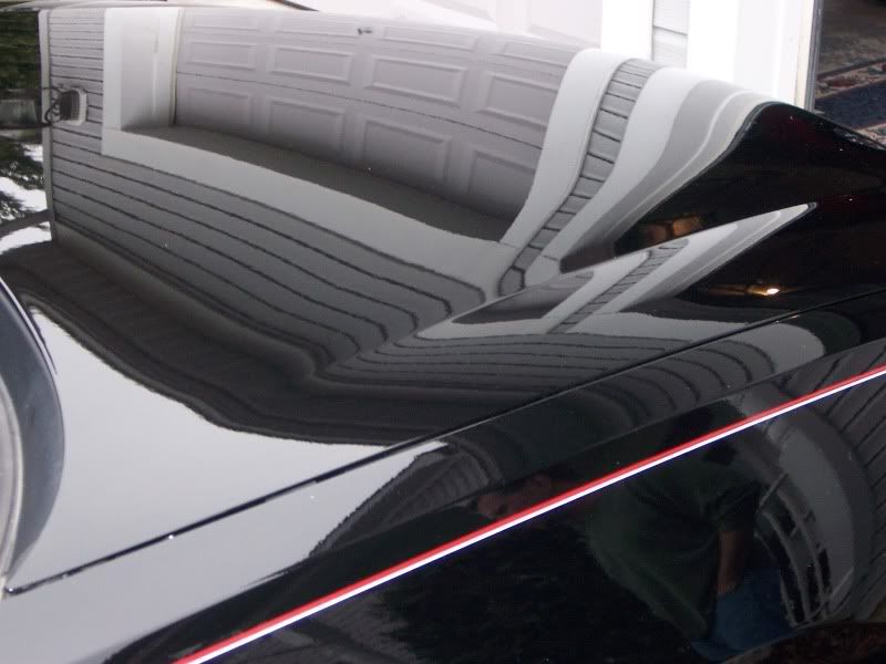

Nice Reflections:
WOW!!! :bow :bow

Did you dress/condition the interior?

Sean: The wells got NL. Tires NL x 2 (but it didn't stick), so I topped the tires with Turbo Wax Tire Gel.
The interior was done all steam (an EXCELLENT cleaner) + meg's quick interior detailer. Greg applied Z10 to the leather this afternoon, but that's after the shot on the post.

nyc_medic: Steam is a VERY effective cleaner on glass, carpet, and interior plastic. I use a steam buggy (el cheapo), but it does a decent job and it leaves the interior smelling fresh.
