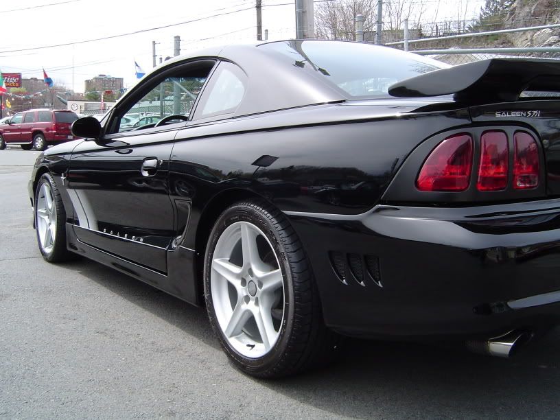

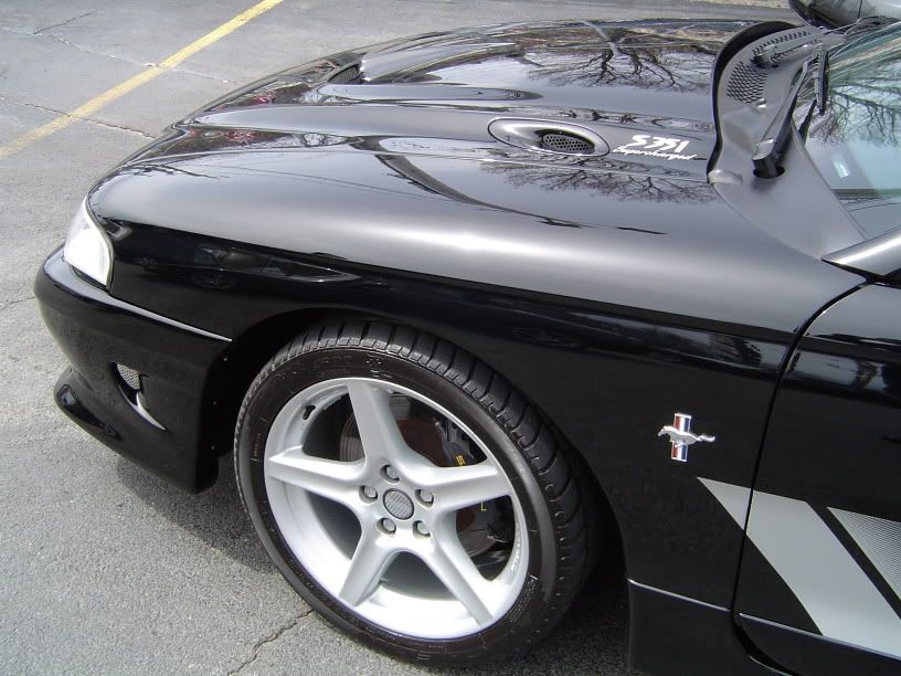

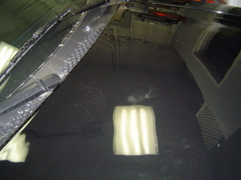

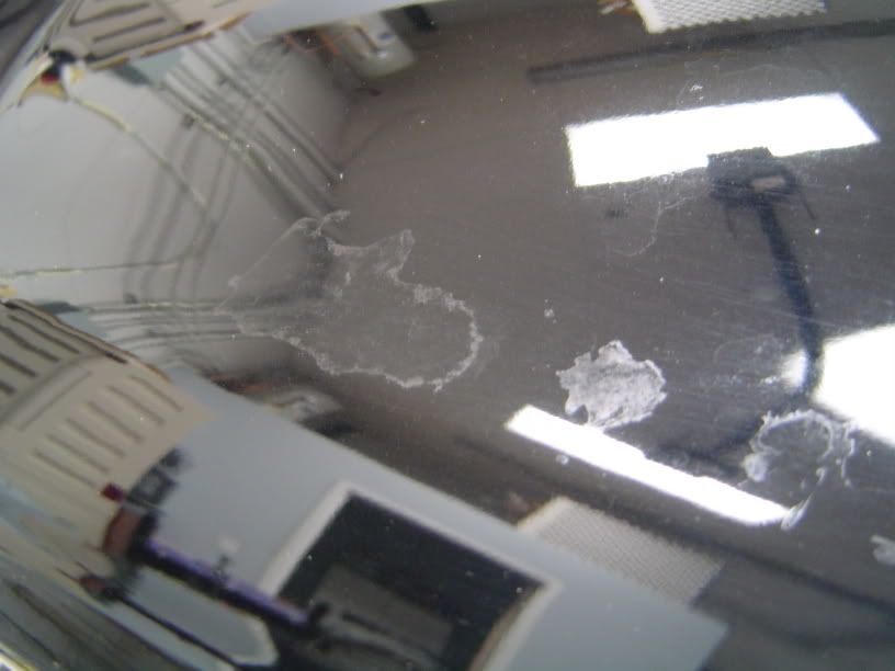

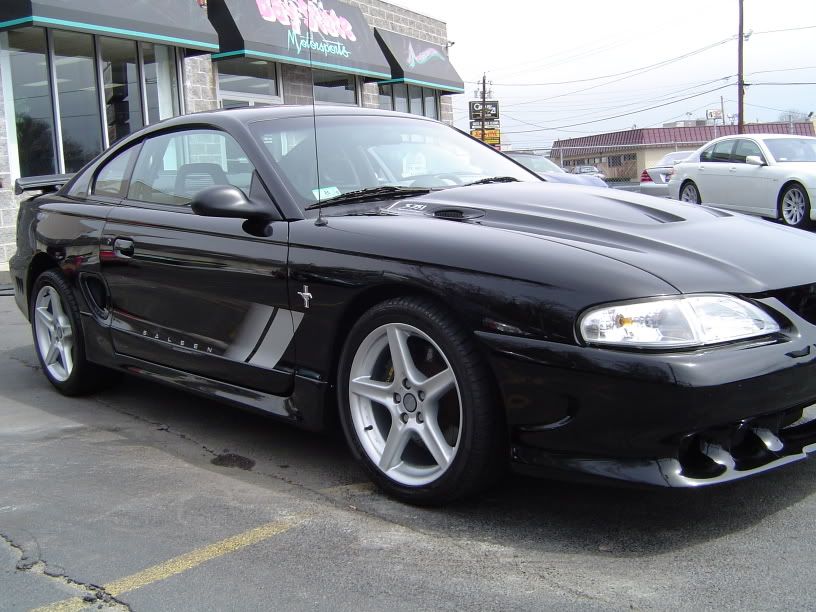

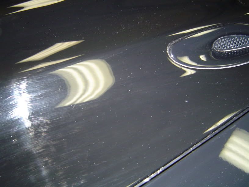

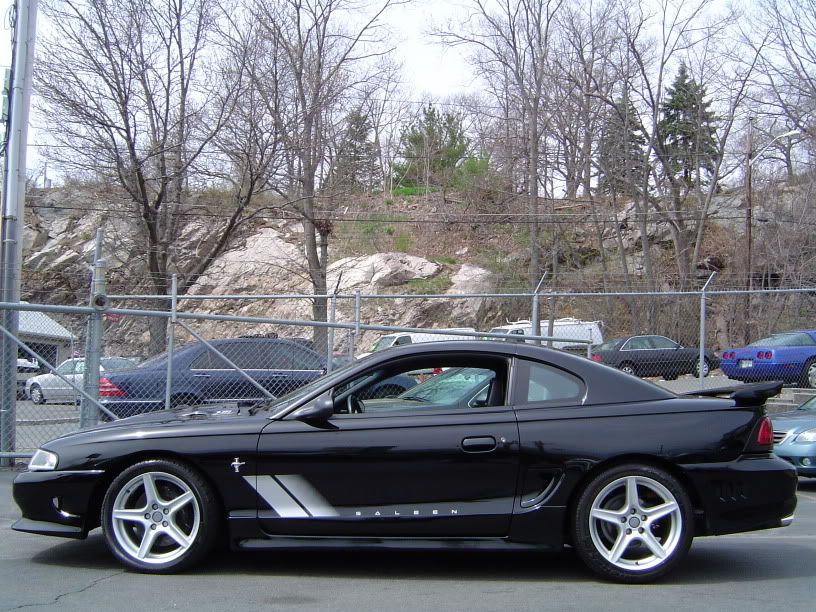

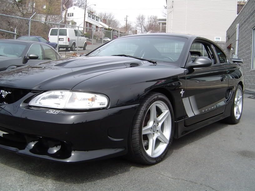

This car belongs to a buddy of mine. He sold the car on E-bay and needed to get it cleaned up before the transporter came to pick it up. The car had some weird spots on all the top surfaces from sitting under a tree. The rest of the car needed a good detail as well.
My process:
Washed complete exterior
Cleaned wheels & engine compartment
Clayed complete exterior
Compounded top surfaces with Powergloss using a foam cutting pad
Buffed complete exterior with Optimum Compound using a foam cutting pad
Buffed complete exterior with Optimum Polish using a foam finishing pad
Hand application of AIO
Hand application of Natty's Blue
Dressed tires & wheel wells with Super Blue dressing
Meguiar's Quick Interior Detailer on interior
Befores:
Afters:

The PG worked great. I used the Optimum after to reduce some of the hazing.
Wow :) I think I saw this car in the background of the corvette thread you posted today and I was like...I want to see the mustang! It may be a different one Im not sure, but either way it looks great! Do you use Super Blue for the trim as well? The before/afters of the windshield trim is amazing!
