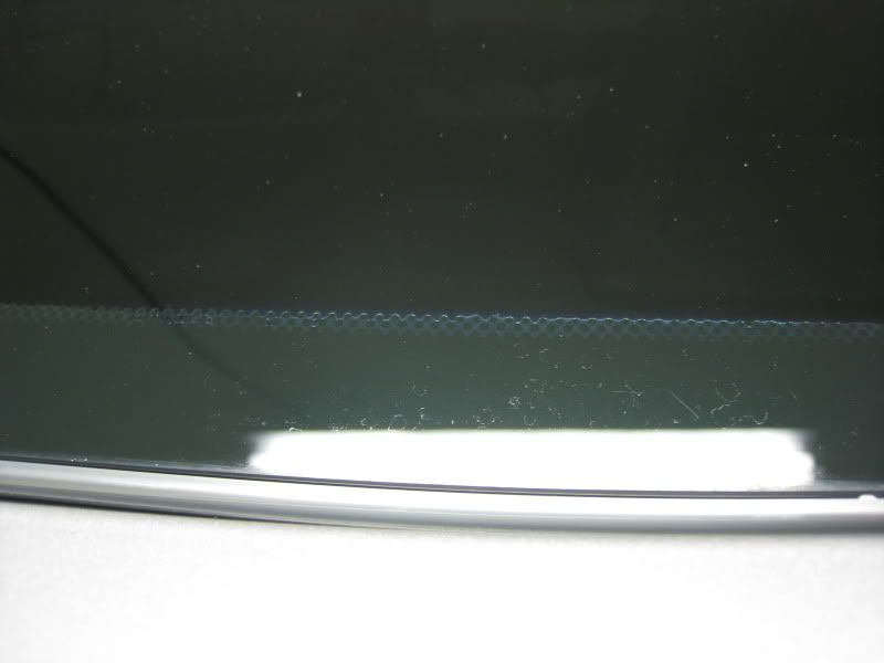

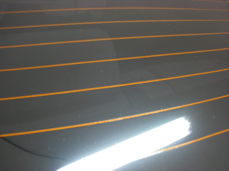

Hey guys,
I am glad autopia is back and running. :up
I got some of my products in this week (m105 & pads) and I figured I would give it a try. I was surprised at how well m105 and LC orange pad worked for me the first time. I hope its not because I worked on my g/f camry back windshield filled with water spots. I managed to get almost all the water spots off except on those darn edges. I did have a 3" backing plate but my g/f was jumping with joy at how clean her windshield looked. I scored some points according to her. Maybe I will got over the lower and top edges with the smaller pads.
I am really impressed with m105 and how fast it cuts. I used the KBM and primed my pad. I also made a newbee mistake by lifting my DA while running. I got M105 all over the car, it was a pain to get off. Oh well, live and learn, I guess.
What do you guys think? Here are some pics, good and bad...
Good
Bad (well kind of bad, but only because I was lazy to go over it with a 3.5" orange pad)
