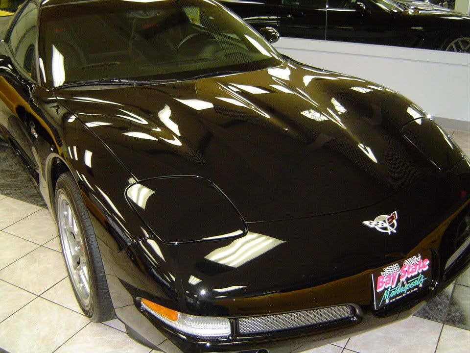

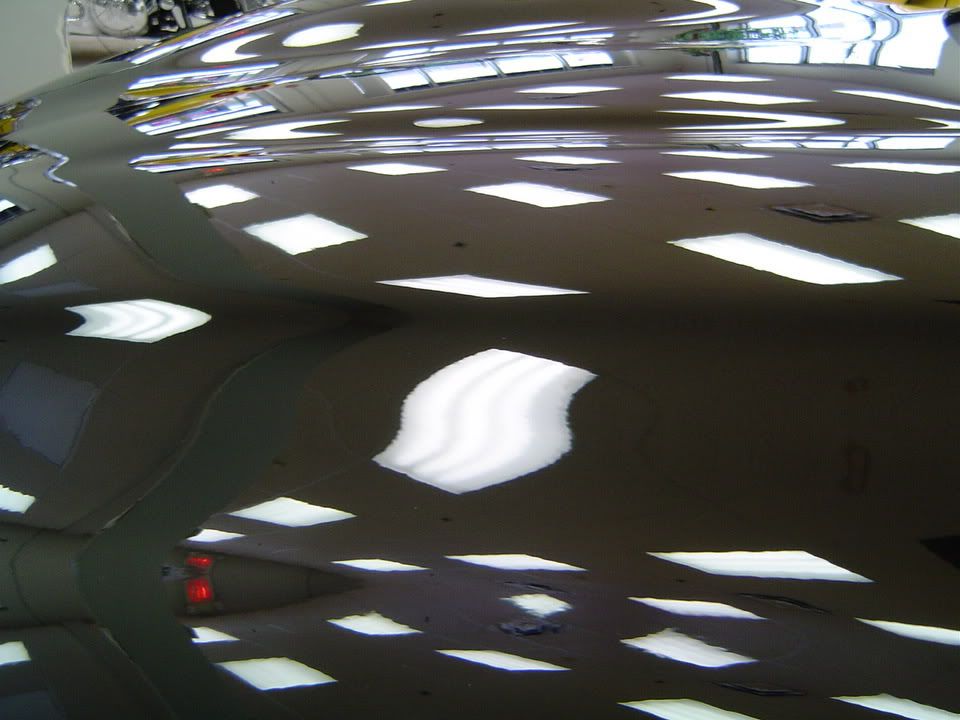

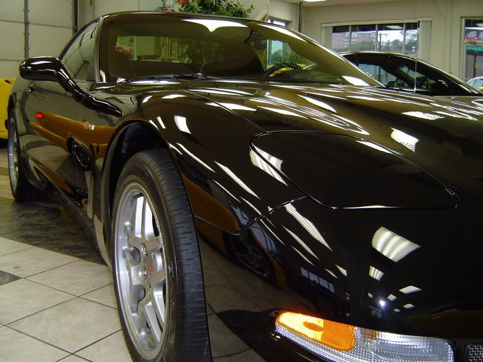

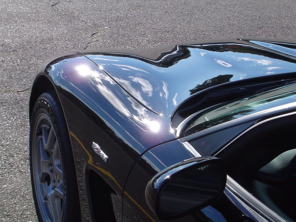

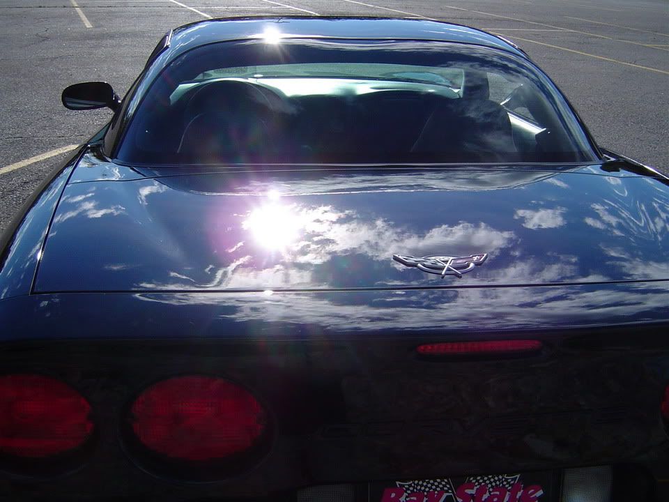

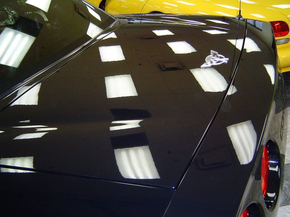

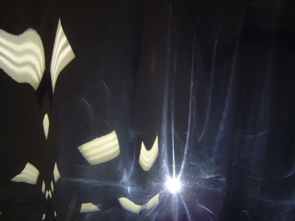

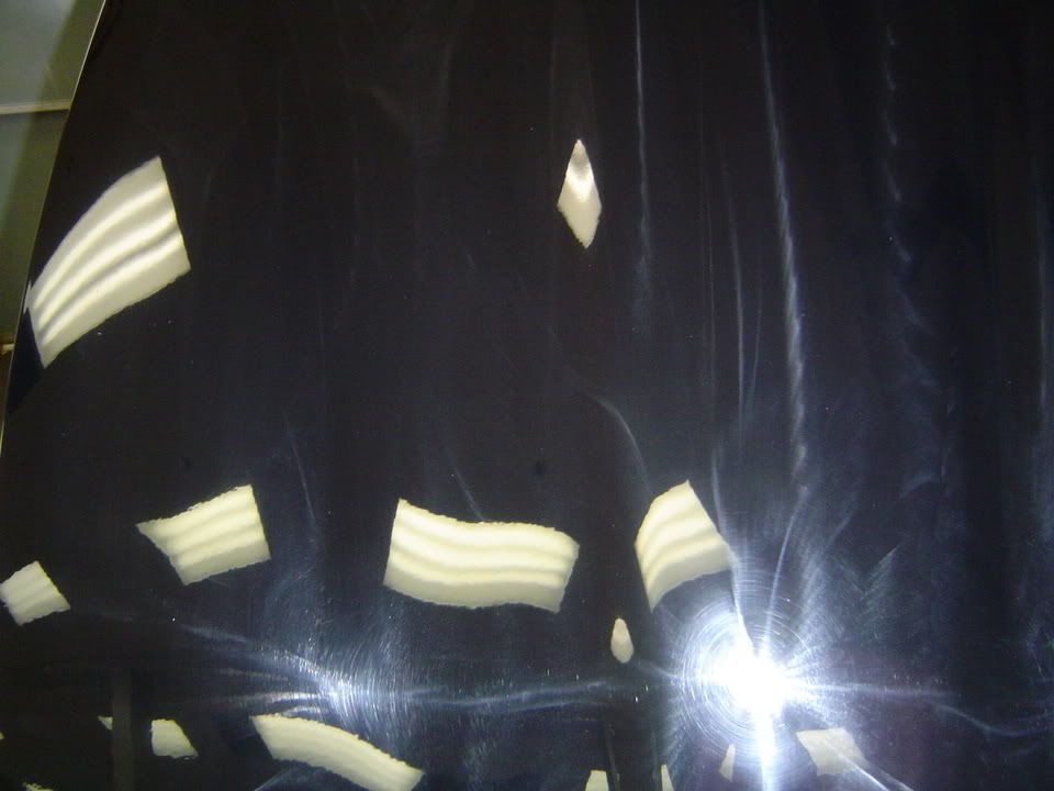

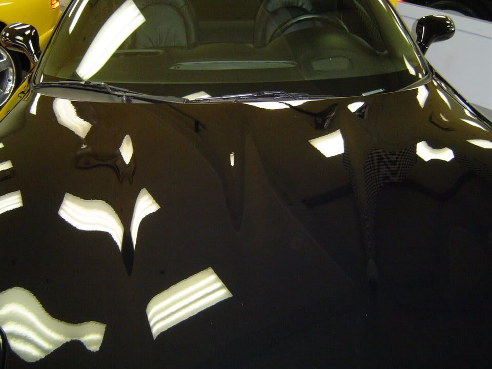

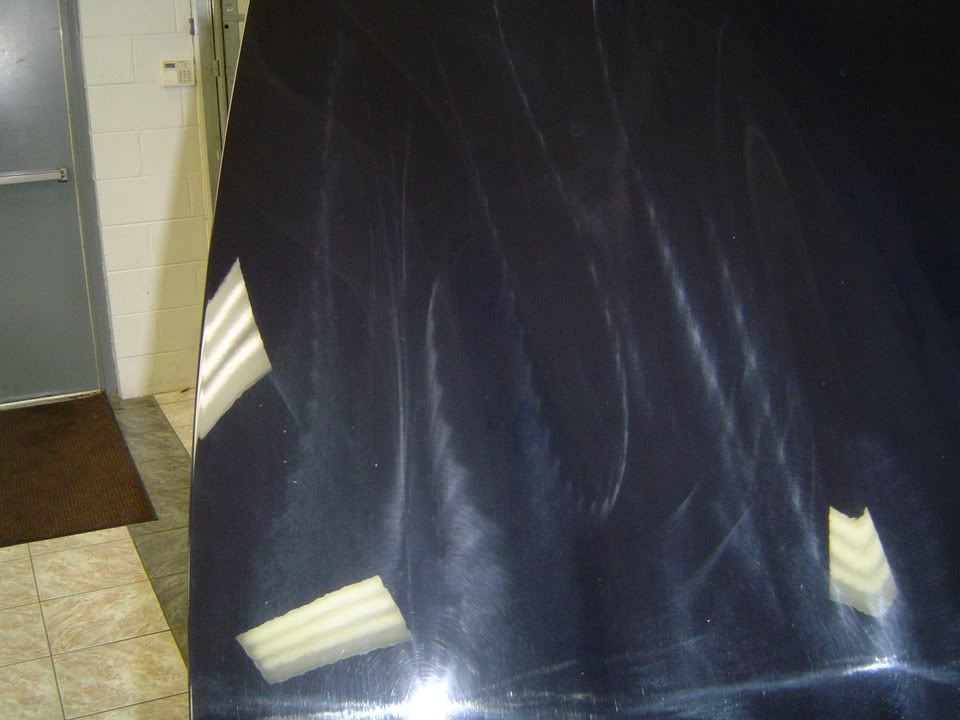

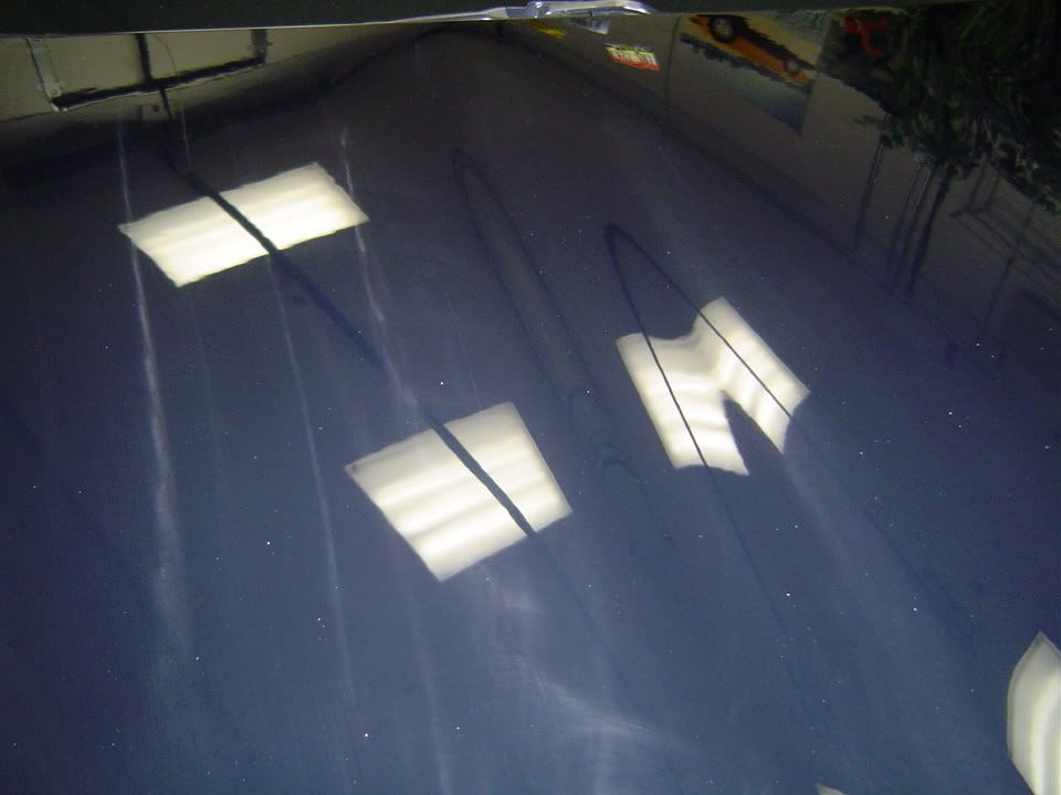

This is a 2003 Z06 Corvette which was my project for the last 2 days. This car was sent to a "detailer" before I started at this job to remove the acid rain damage on the top surfaces. All the top surfaces were wetsanded to remove the acid rain (which they did), but did a horrible jog compounding out the finish. I wish it hadn't been raining here for the past 10 days or I would have brought it out in the sun to show how bad the swirls really were. As you can see from the pictures the swirls were absolutely rediculous and I am amazed that someone could let the car go out the door looking the way it did.
The car was clean so I didn't bother washing it. I wiped it down with some QD and went to town. If it ever stops raining here I will bring it outside and do a good cleaning behind the wheels.

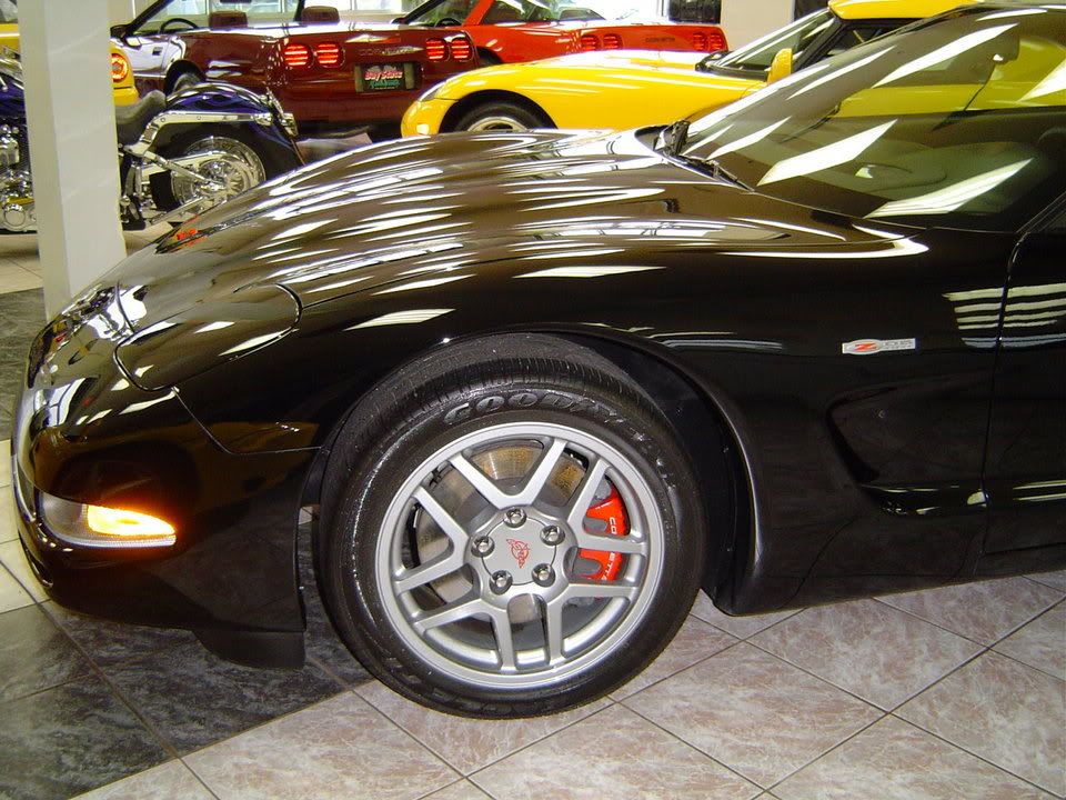

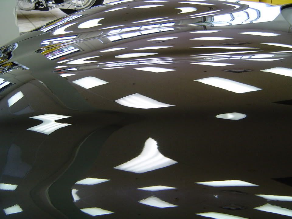

My process:
Compounded complete exterior with 3M rubbing compound by rotary w/ cutting pad
Buffed complete exterior with IP w/ polishing pad.
Buffed complete exterior with Optimum polish x2 with finishing pad
Hand application of AIO
Hand application of RMG
Hand application of EX
Hand application of Souveran
Here are the before pic's
:eek:
Damn......
Do some detailers just not have any pride in their work? That is one of the most disgustingly inept polishing jobs I have ever seen. Truly outstanding work bringing back the paint the way you did, looks incredibly deep, rich and wet!
Thank you very much! It absolutely just boggles my mind that someone can actually make money doing a job like this to a car. When the sun comes out here some day I'll have to take some pictures for the website, so I will take some good sun shots and post them up.
