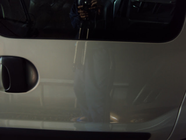

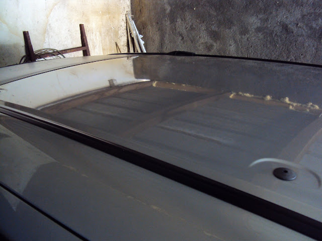

hi ;) ,
Sweep Test : 45 minutes ...
buff : ok .
Touch : not a caranuba wax .
Beading / Sheeting : look diff?rent
Protection : first time i use so i dont know
Photos : 24h after waxing
clay : 3M / born slippy
cleaner : meg's DC1
glaze : IMP HG 3M last a night
Auto balm : sealent paste
#1 :
#2 :
#3 :
#4 :
#5 :
#6 :

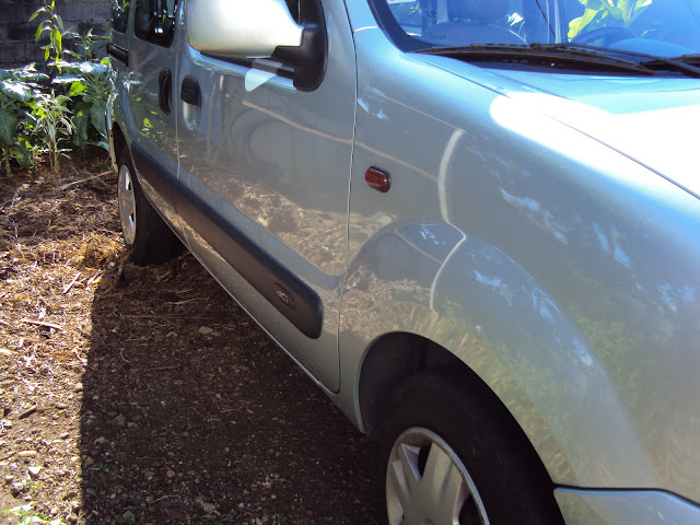

outside pict : + 24h ( so more than 48 after waxing )
#7 :
#8 :
i really happy with this color , my MMM Rosa don't do that...
