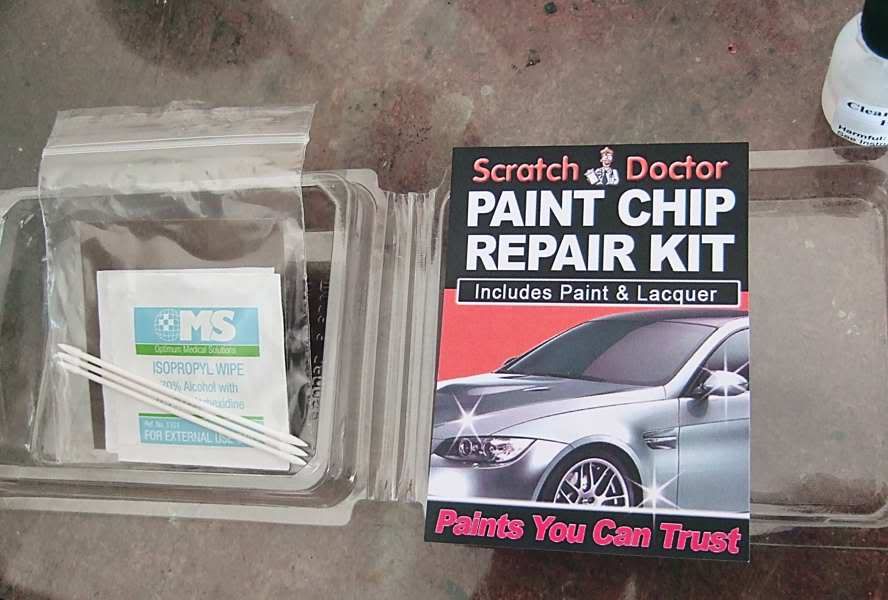

It's getting harder and harder to buy real touch up paint in a bottle. Everyone is pushing those friggin' paint sticks, Mr Predator. Maybe you know this already. I ended up ordering from some guy in the UK via eBay. I think it was $14 delivered. I couldn't find it anywhere else, not even the traditional places in the USA I've purchased from before.
The UK vendor is "the scracth doctor" or something to that effect.

Just used that kit a few days ago, I'm now requesting a refund and looking for something to remove the layers of paint so I can start with a paint pen kit.
