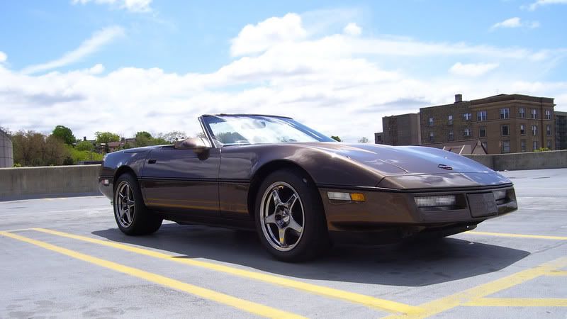

This is NXT topped with Aquawax on my 87 Medium Brown Metallic Corvette:
That photo was taken on a nice day, and before I used Duragloss as my sealant. I used NXT Paste to use it up.
