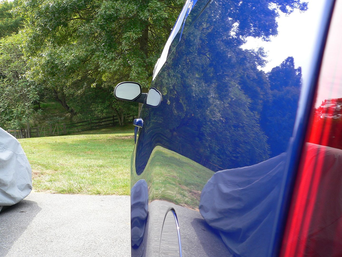

Bought a new 2013 avalanche last week. Luckily the dealer did not induce any surface imperfections. The paint is flawless. I got the bright idea as soon as I got it home to apply P21S 100% wax. While it does look fantastic this truck sits outside 24/7 and is my daily driver. That got me to thinking. What better time to apply opti coat? Paint is already perfect. So I have the opti coat sitting here and was ready to apply. I whipped out the dawn (did not have the blue standard dawn, all I have is the yellow version) and gave it a heavy wash to strip the wax and get it ready for the opti coat.
Low and behold the dawn does not seem to have removed the wax???????? It is beading like gang busters after the dawn wash!!?????????? So my question is...............what is the best product for me to use to get rid of the wax? The dealer did not tell me if they applied anything or not so I am unsure if they applied some kind of sealant. I want to get this thing opti coated next weekend. I was thinking carpro eraser or griots paint prep? What do you autopians think?

Thanks for the help guys. I went out and got it stripped down clean. I forgot I had a bottle of power clean! Still had some not so well defined beads but the paint was tacky if you ran anything across it. Once dry I went full on with the opti coat. Truck looks great! I think I used about 7 or 8cc out of the 20cc vial. Does that sound about right for a truck this size? I did not do any trim with it. I use ultima tire and trim guard plus on my trim.
