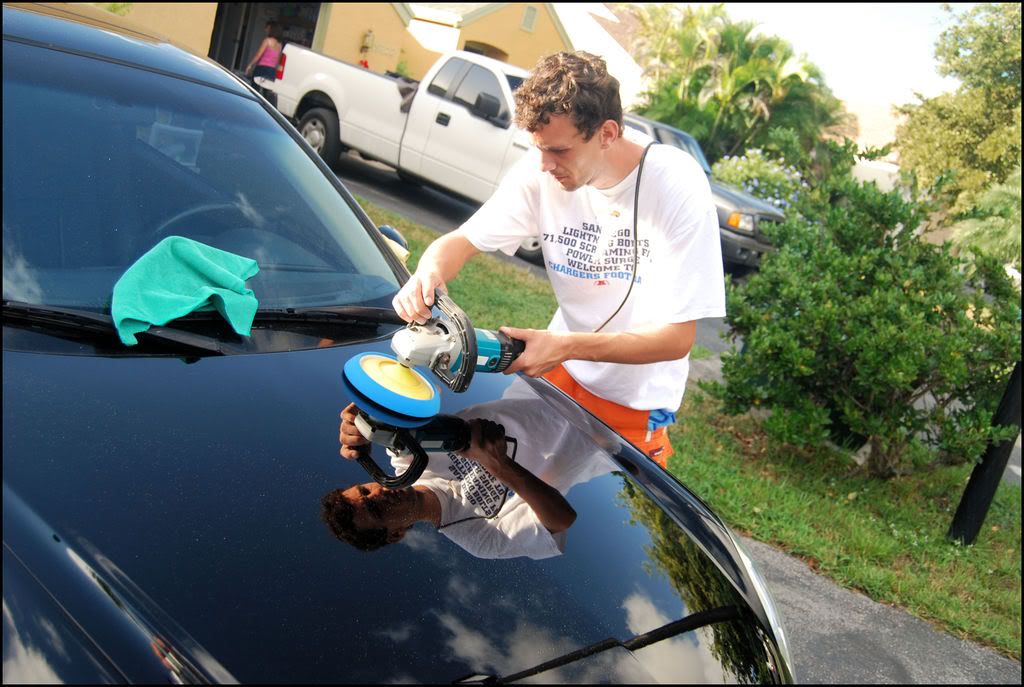

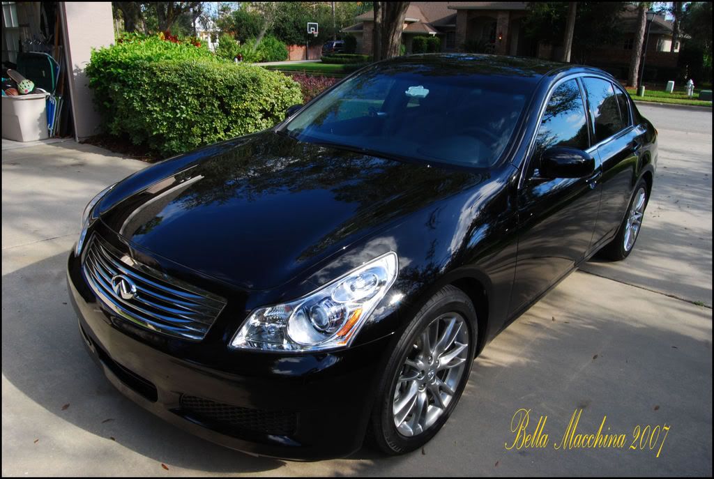

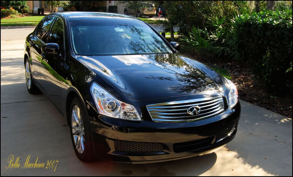

First up is a G35 Sedan that I did for a forum member yesterday. This ’08 Nissan had the typical soft Nissan paint, though it wasn’t as bad as some of the previous G35/G37’s I have done. The goal was to make this car look like a new car deserved to look.
Sorry for the lack of before pictures.

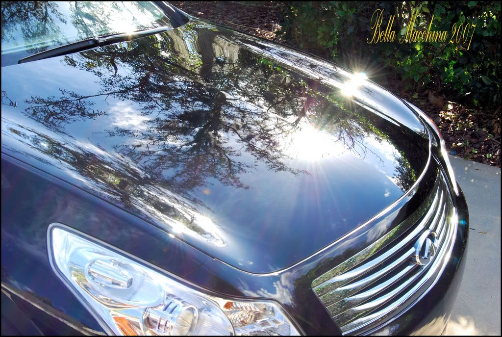

Car was polished with several different steps and required a little creativity to finish it out hologram free. Because of the natural marring ability of the paint, we settled on Collonite as an LSP, over a RMG. This provides a great look on the perfectly prepped paint.

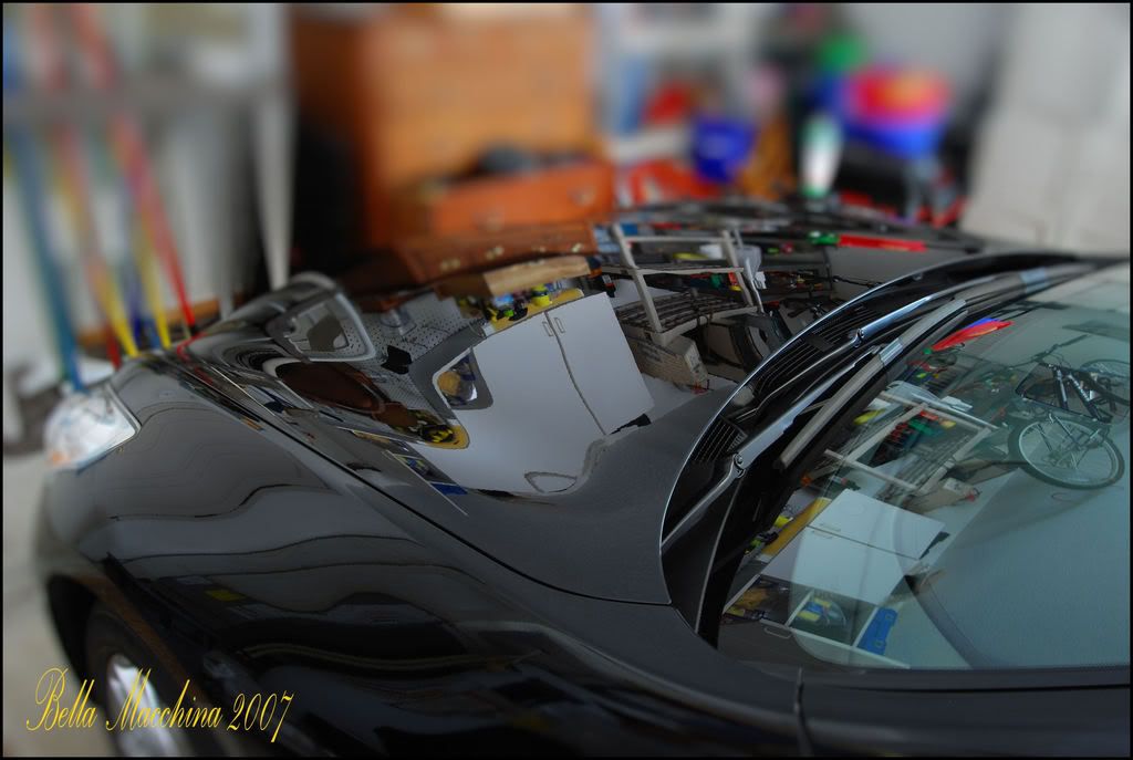

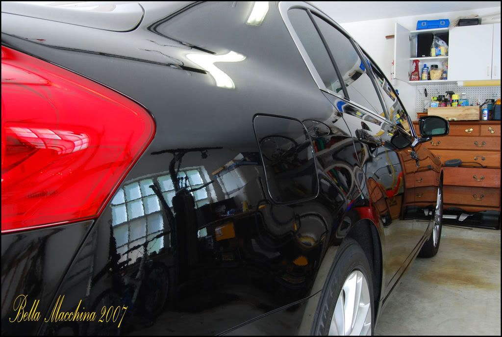

In the garage after LSP application…
Perfect!
Some of the photos are over exposed slightly, because the sun was playing peak- a- boo with the clouds so my lighting was all over the place. However, I think a lot of the pictures came out great!
