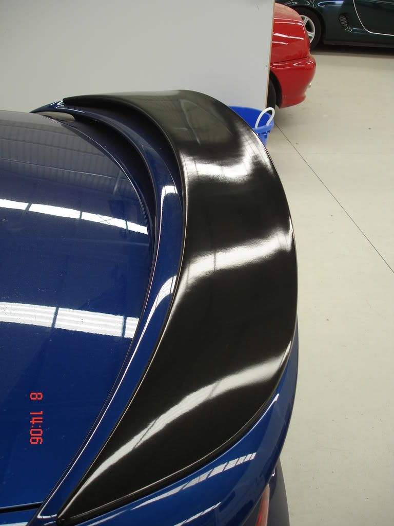

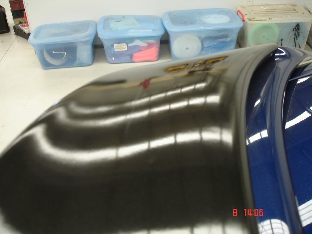

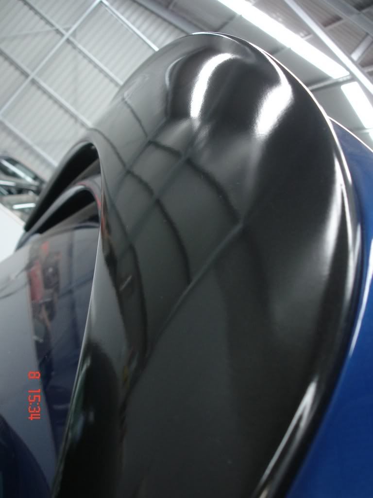

Right, here are pics of my bi plane spoiler's top spoiler after glare and permagard
Whole process was trim dream, fireglaze, glare pro polish and permagard, all by hand with LC 4 inch pads.
Sealed with glare.
Remember, this is unpainted and from the factory have absolutely no reflections and is very light brown with gold specks. (i've burnished out the specks as I didn't like the look)
All these products used are non abrasive and the ingredients and the heat from the machine burnishes off the rough feeling dead looking top layer and enhances the shinier and silky smooth layers below.
Video of wing video - Photobucket - Video and Image Hosting

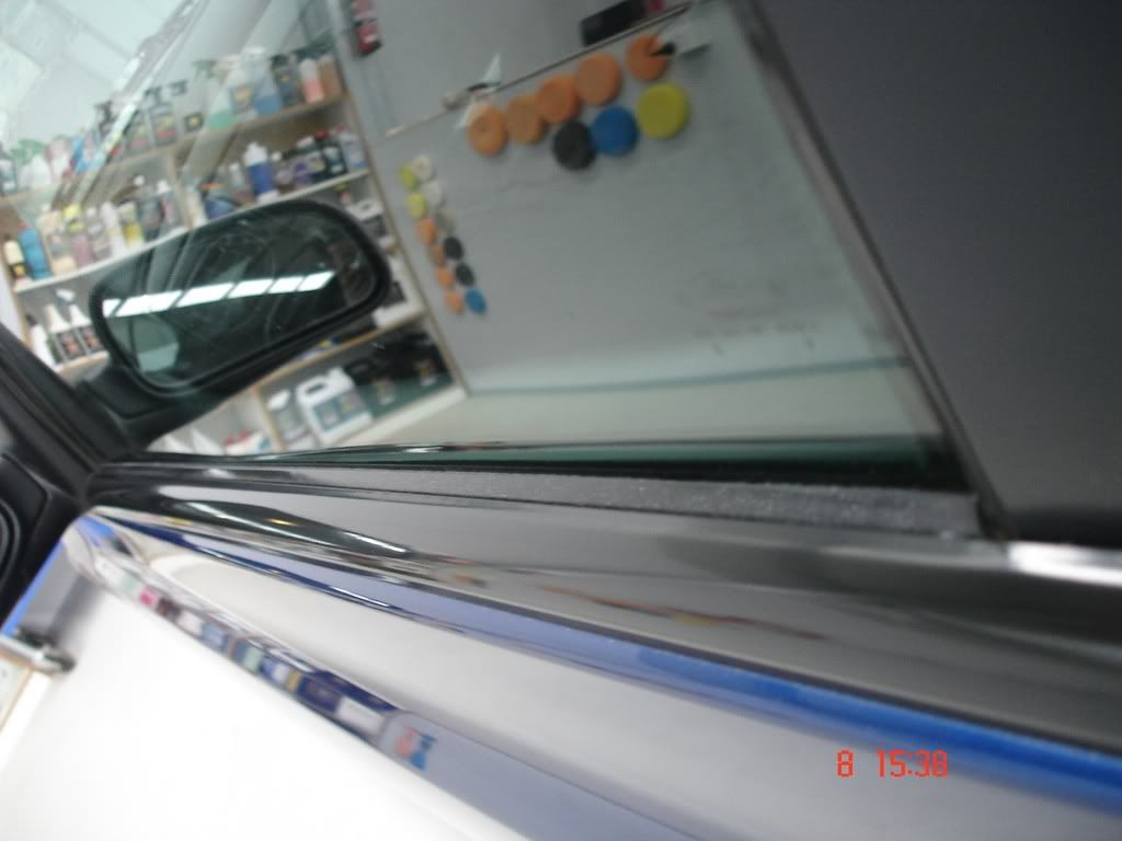

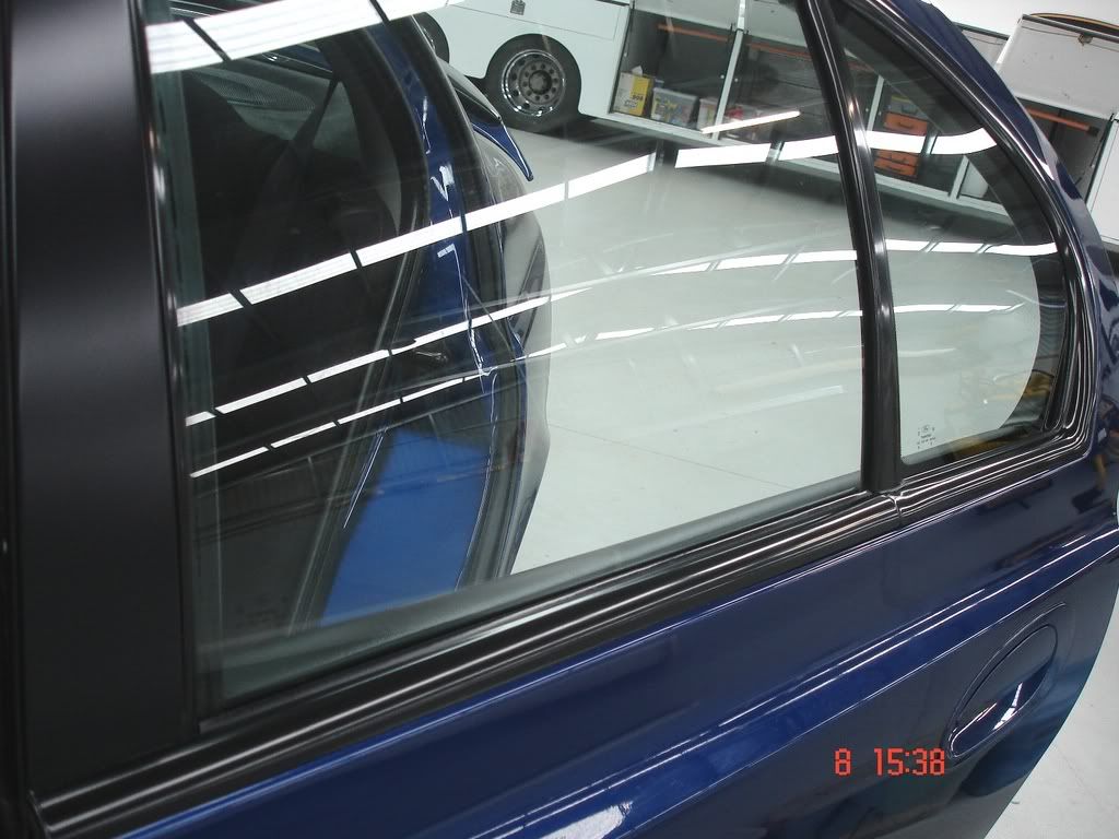

Now to exterior trims
Lower ones were hard and flat brown when I got the car in 04, dressed them until 06 when I first created trim dream
A few months ago I applied trim dream v3.02 (runnier version than V2 or V3.01) and followed with fireglaze DS.
Sealed with DS
Two weeks ago : Glare Pro Polish with LC white pad and Permagard PD5000 with LC black and blue
yesterday, Aussie Gold showroom glaze spray on shine with LC blue for five minutes on each piece)
Sealed with Glare.
It's really hard to capture the true shine with a camera.
