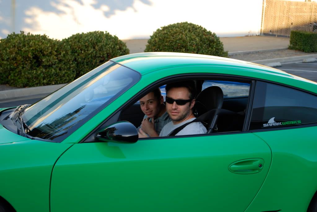

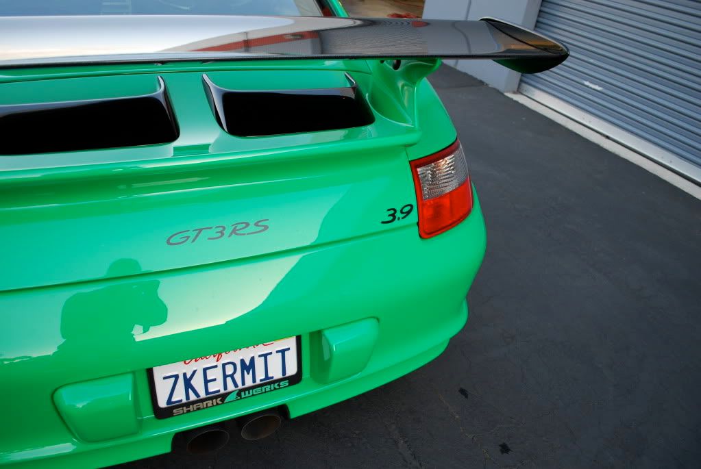

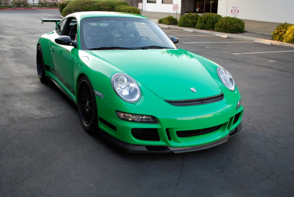

I really enjoyed my time out in CA, honestly a beautiful place with some great cars to boot. The highlight for me was the drophead coupe, just an overbuilt car on so many levels. However my ride in Alex's (Sharkwerks) 3.9liter GT3 RS was pretty damn fun, and on the verge of sickening....8800rpm shifts all day long:devil:
