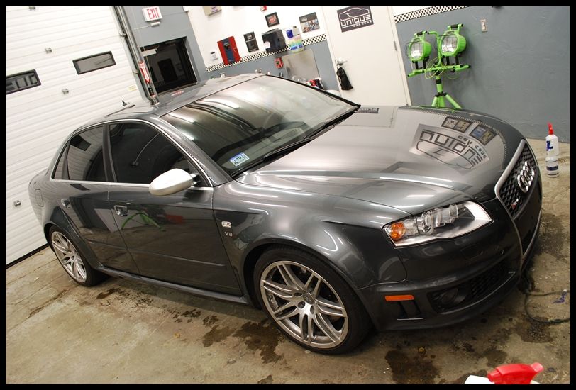

This Audi RS4 is a few years old and has been very well maintained since it was new. The owner was interested in having the existing paint protection film (clear bra) removed and wanted it replaced with a better quality film with additional coverage.
</SPAN>

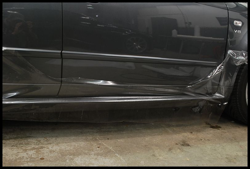

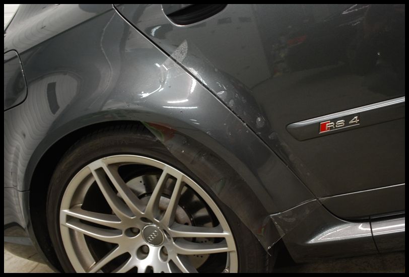

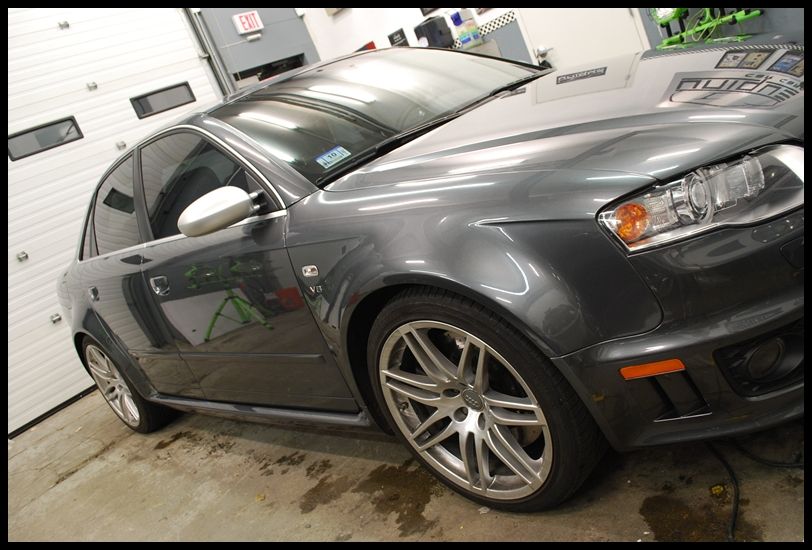

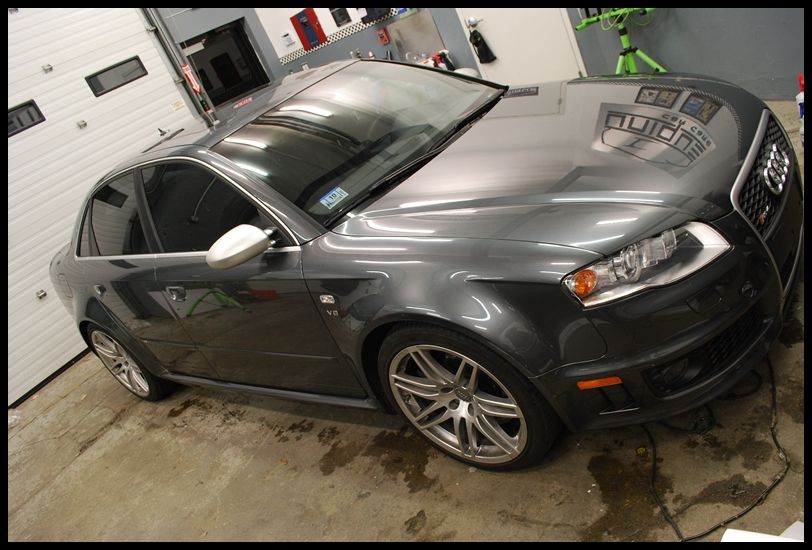

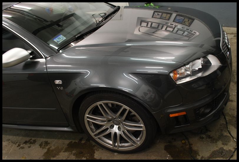

Although the film did its job protecting the paint from stone chips, the original clear bra was starting to get cloudy and turn yellow, so it had to go! Our plan was to remove the existing film and perform a fully custom install to the entire front end of the car including the complete hood, complete fenders, complete front bumper, side mirrors, headlights, A-pillars, rocker panels and rear quarter panel splash guards.
</SPAN>

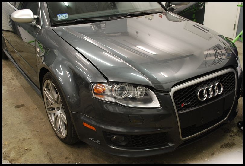

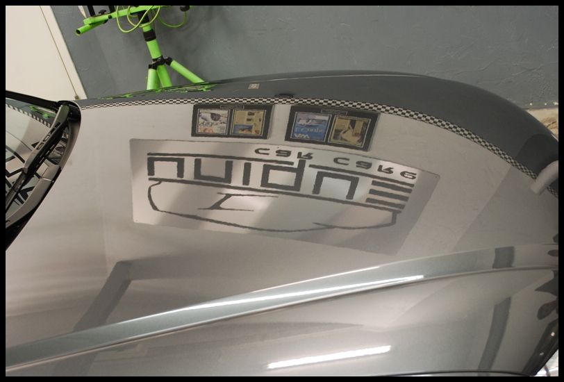

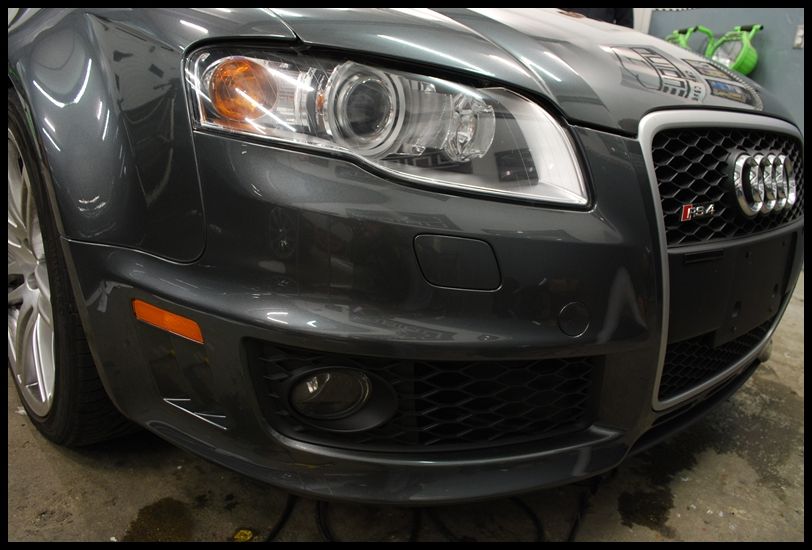

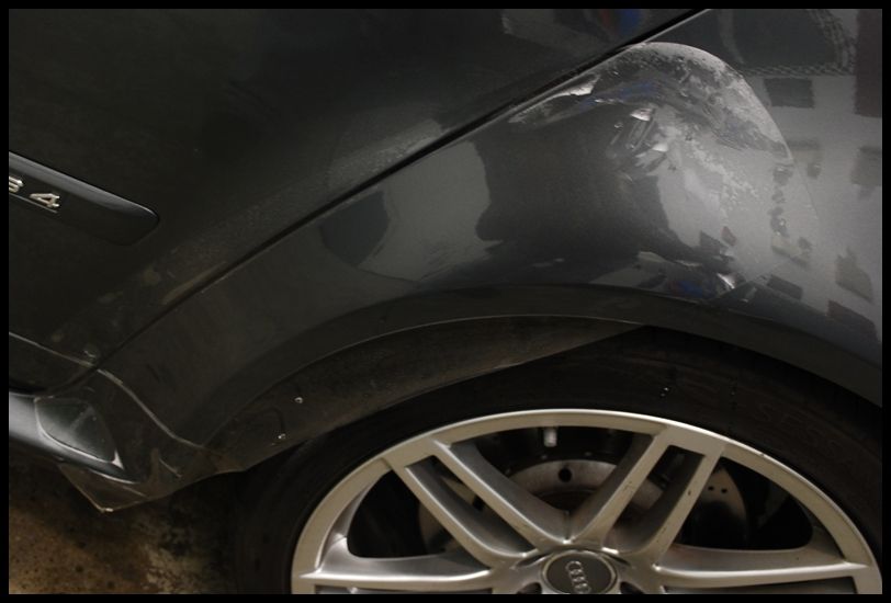

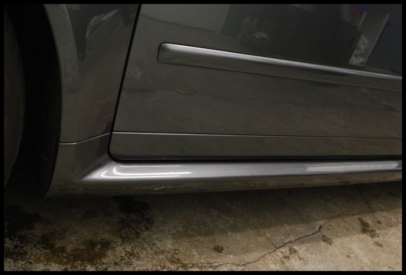

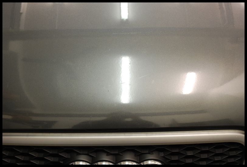

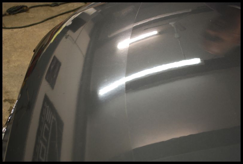

As you can see in the pictures below, the existing film was starting to get discolored and was very dull compared to the factory paint finish.

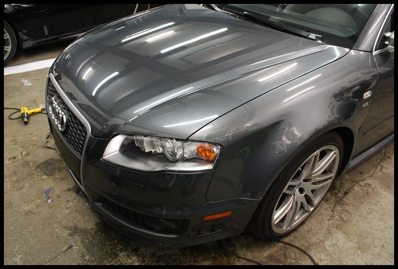

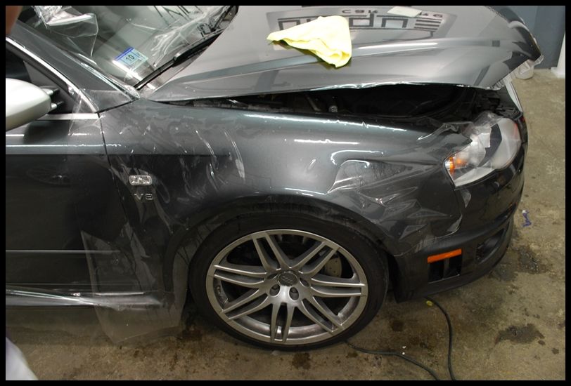

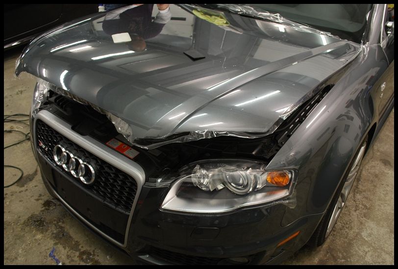

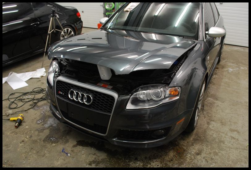

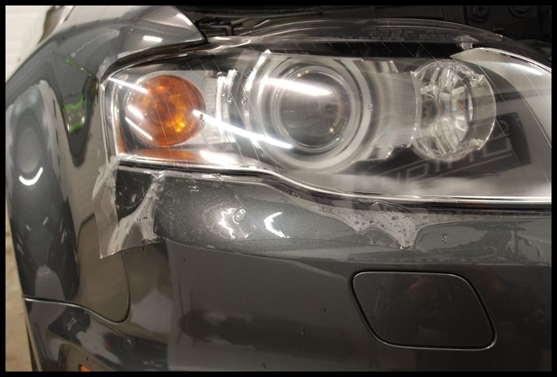

The first step was to remove the existing film by heating it with a heat gun in order to warm up the adhesive and make removal easier. Some of the adhesive remained on the panels, which was easily removed with some acrylic solvent.
</SPAN>
</SPAN>

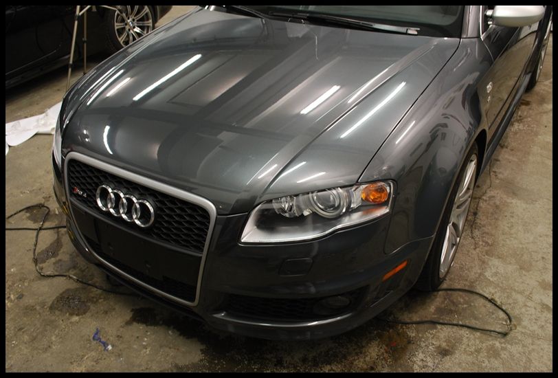

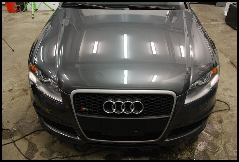

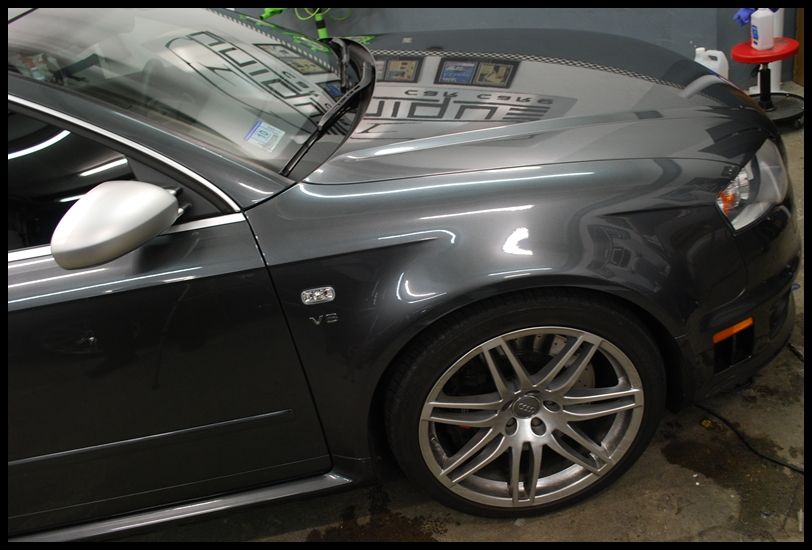

Once the film was fully removed and the paint was free of remaining adhesive, I clayed all paint surfaces being covered in film to ensure there weren’t any bonded contaminants present. It is very important to have the paint as clean and perfect as possible before the install to ensure there is a perfect foundation for the film to adhere to. Once clayed, I followed behind and polished all areas to remove any light scratches and paint imperfections.
</SPAN>
</SPAN>

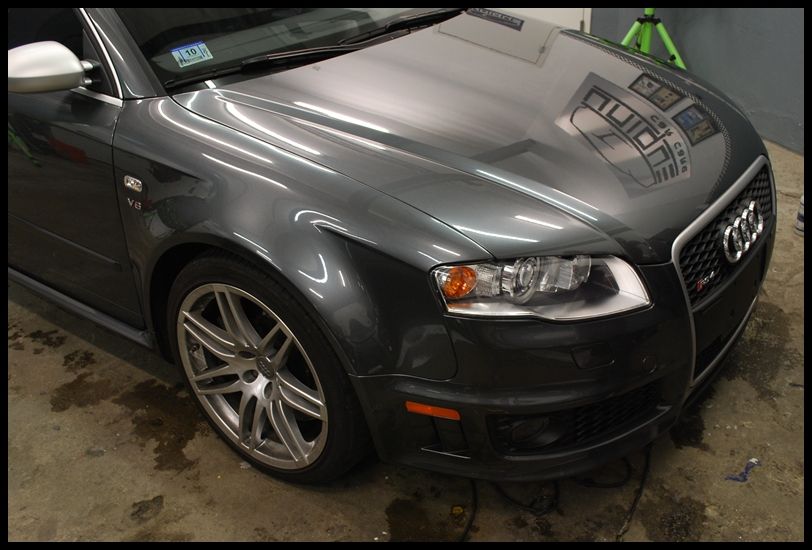

Full polished and ready for the install…

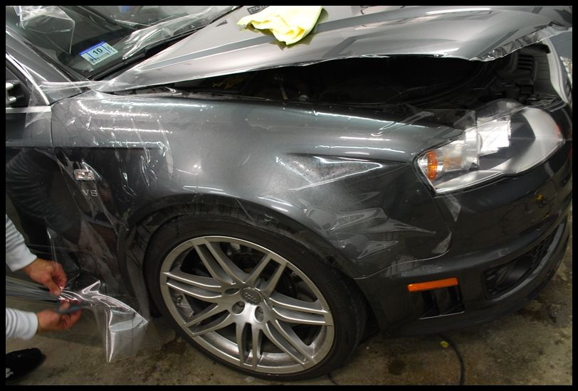

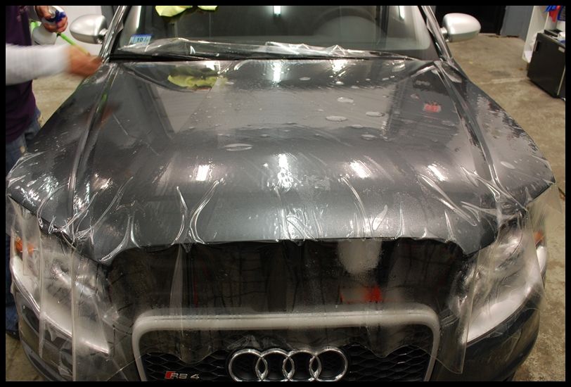

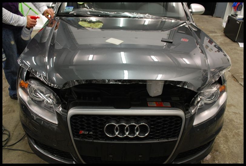

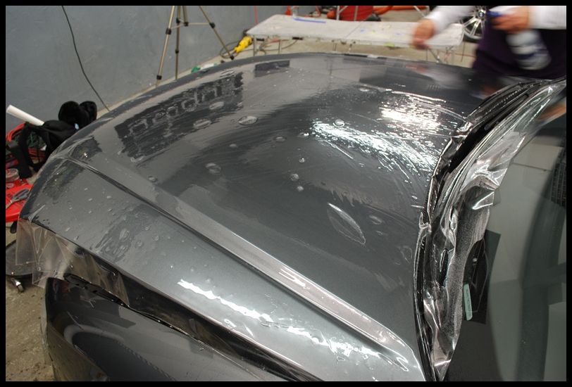

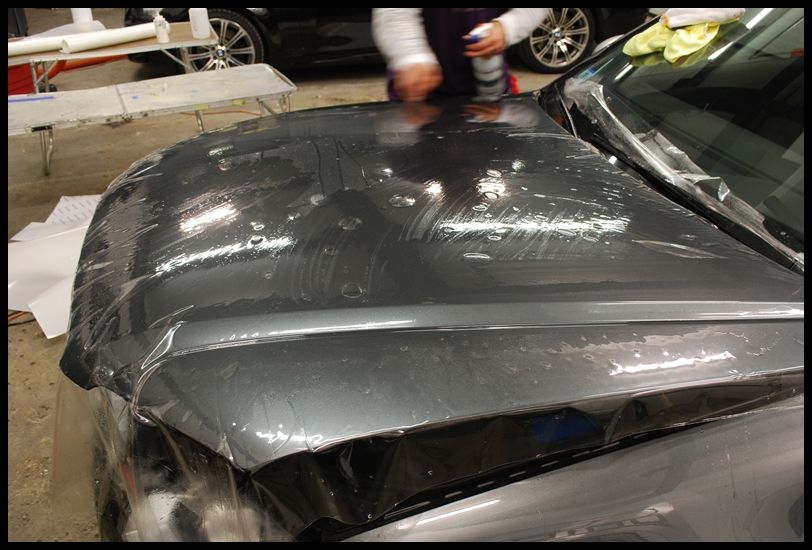

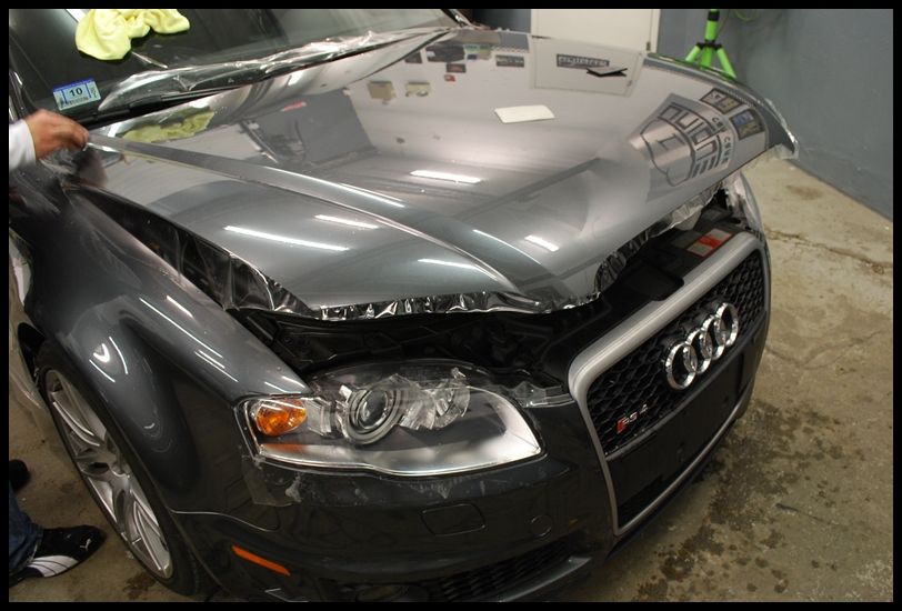

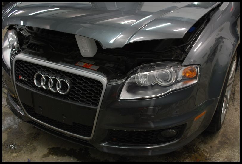

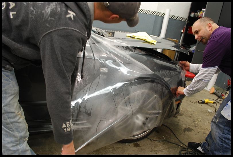

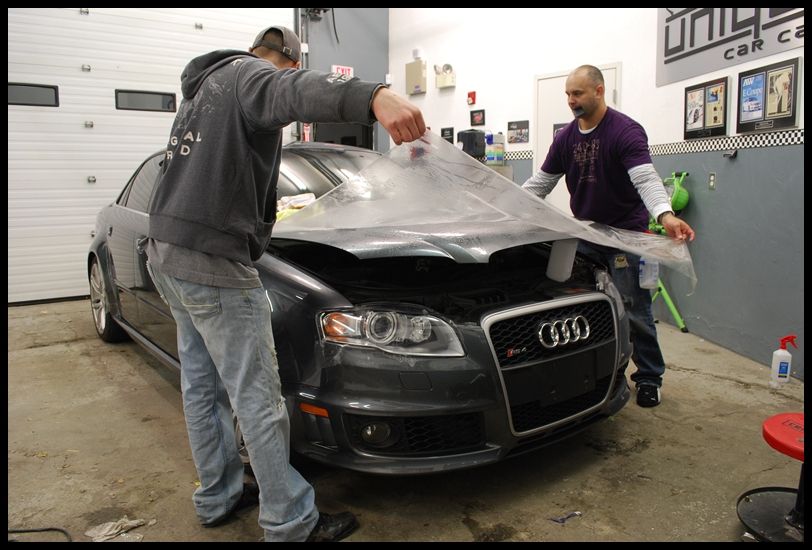

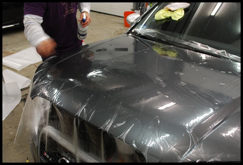

Now that the car was fully prepped for the install, we started by installing the hood using bulk film in order to cover the entire panel without having any seams. By using bulk film instead of pre-cut pieces, we have the ability to trim the edges about 1/8 inch longer than necessary in order to wrap all edges over for the clean and invisible end result.

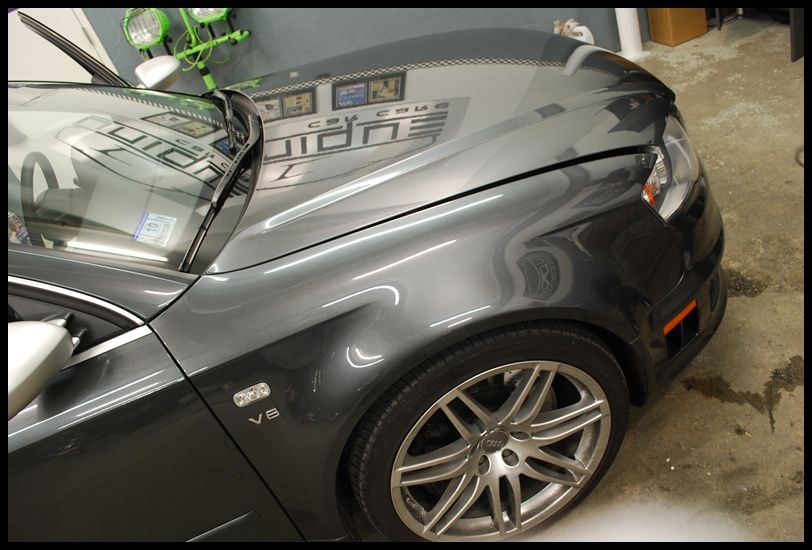

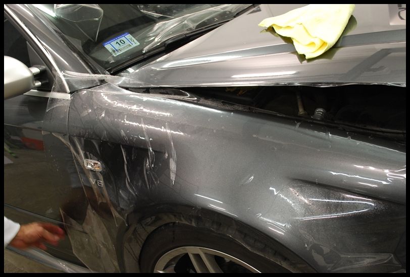

Full fenders…

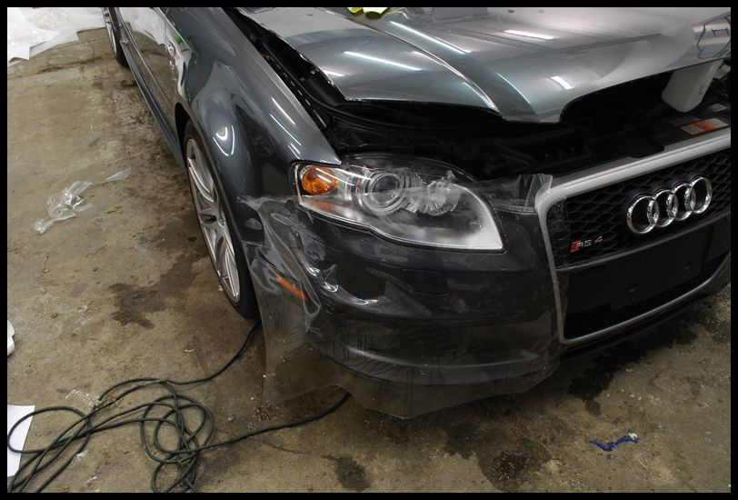

Full front bumper coverage…

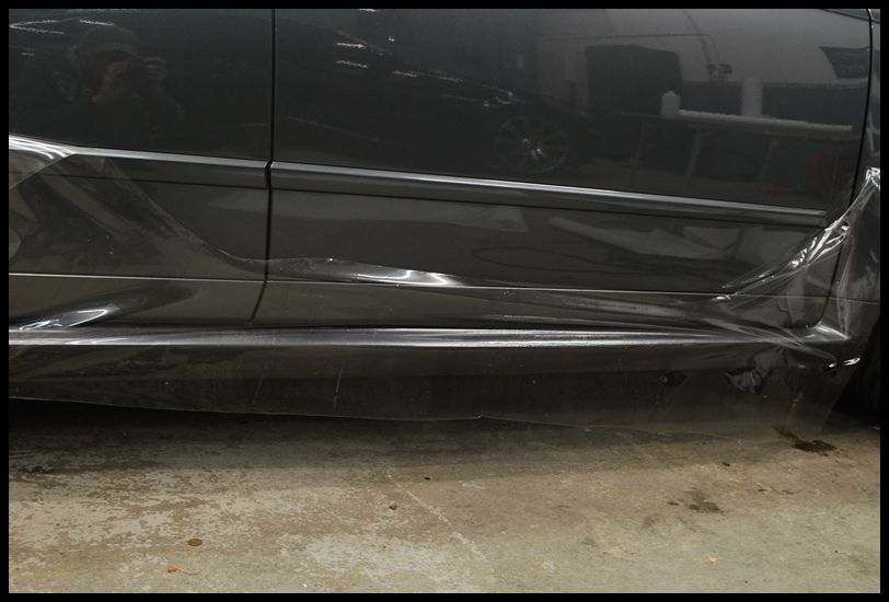

Rocker panels completely covered…

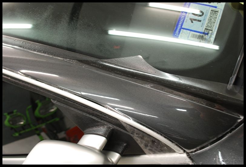

A-pillars covered…

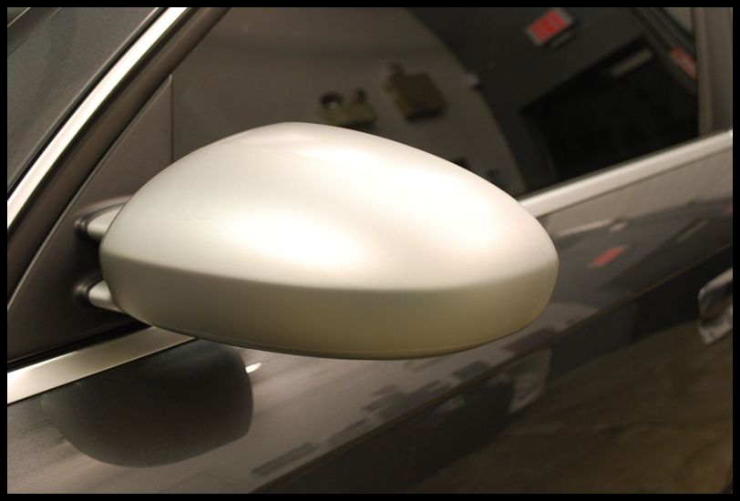

And last but not least, the mirrors were covered using matte film in order to maintain the matte silver finish of the mirrors…
