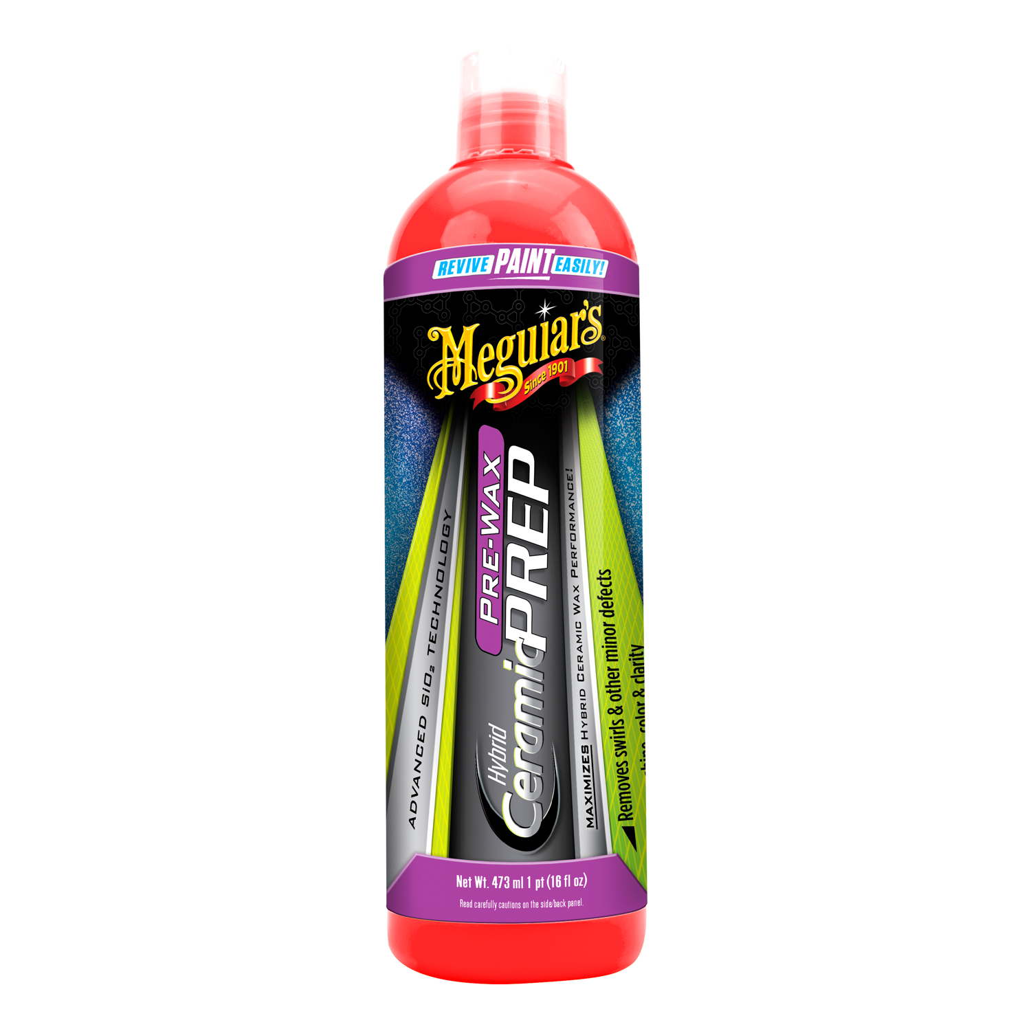

Well I am bumping my own thread I started on Coating Decontamination Pre-wash Soaps and am asking if anyone has bought and used Meguiar`s new consumer line Hybrid Ceramic Pre-Wax Prep G220416 soap. It is available only in the 16 ounce bottle.
In the above post #12, roscopervis in Europe suggested using Meg`s Wash Plus (Reference: https://www.autopia.org/forums/car-...r-car-wash-plus-2.html?highlight=discontinued), but this product has been discontinued, so I am wondering if this is a "replacement" in Meg`s Hybrid Ceramic line-up for this product.
By the way, thanks for the above posts from all my fellow Autopians on this particular subject about coating pre-wash soaps.

It is not recommended to be used as a primer for a coating as it contains their ceramic wax properties. This was mentioned on a Meguiar`s video.
Sorry, my bad about "misinterpreting" this prep polish as a prep soap.

Thanks for the catch of my fat-fingered transposed "40" in the Meg`s part number for this prep polish. I do than a lot, not knowing how to type AND my Captain Obvious dyslexia.
