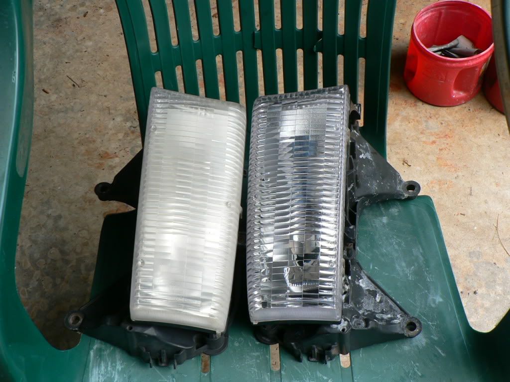

The headlights on my Dakota weren't really 'headlights', more like 'things that glowed in the dark'.
I spent maybe 30 minutes with some 2500 and 3000 wet sanding and then a 105/205 pass.
