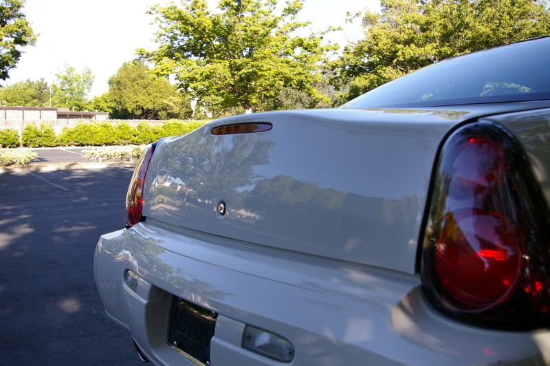

When I debadged my car I used dental floss cause it's coated with a waxy material. After I got the badges off I simply pushed/pulled and peeled the remaining double sided tape off with my fingers. Once it was all off I proceeded to polish the remaining residue with VM. Here's a current pic of my debadging job, it's sporting HTEC followed by OP and finished off with CG 50/50 with CG Synthetic QD as a topper and I must say, I love this combo and the outcome on my car.
This is what it looked like before:
Here's two with my badges removed using my method posted above....
The "Accord" and "EX" were on the pass side trunk lid above and below the tailight. I didn't take the "H" off because it's in with pins

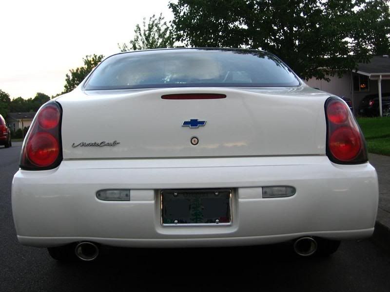

Accumulator said:
rfk76- That really looks a *LOT* better :xyxthumbs
I concur
Now I just gotta put the PC/rotary down and get my sideskirts and Nascar wing painted body color. I'm just painting my OEM skirts, but my wing is aftermarket. I already sanded it down, I did that the day I got it (at least three months ago), maybe I'll go buy the primer and paint this weekend since it's gonna be so hot, should help the paint dry quicker which will help the process go by faster. And once I get that done that'll be motivation for me to take the skirts off and get them painted so I can put the wing on.
YoMike said:
Dental floss will work also.
Yep, wax coated floss. Just warm-up the badges first. You can use naptha or 3M Prep-Sol to remove the adhesive, or use the 3M adhesive removal product as well.
Whichever chemical you use, just make sure you glaze it so the paint does not become soft from the chemicals.
Deanski
rfk76- Sounds like you still have a fair amount of work to do :D
MotorCity- That looks good too!
I think I'd want the "H" on there anyhow. The way the trim strip is notched for it would look weird without the "H" IMO.
I left the "Flying M" on my MPV's hatch even though they were welding up the holes for the other badges anyhow, just looked better IMO. I took *all* the stuff off the S8's trunk lid and while *I* like it, most would say it's not as attractive looking as my wife's A8 where we left the Audi rings; sometimes a *little* badging looks better than none at all, other times it looks better with the "nosed and decked" look, just depends on the vehicle.
I left the "H" on because I love Honda's and don't want to be mistaken as otherwise..
The chrome trim peice was something I actually added on just a couple weeks ago..
I have seen them before but never with the little dip as you mentioned for the "H".. to me that dip chaged it from an aftermarket looking peice to a factory one.
But back on topic, the steamer I used worked wonders.. with not using the adhesive remover it was one less chemical I had to use on my finish
