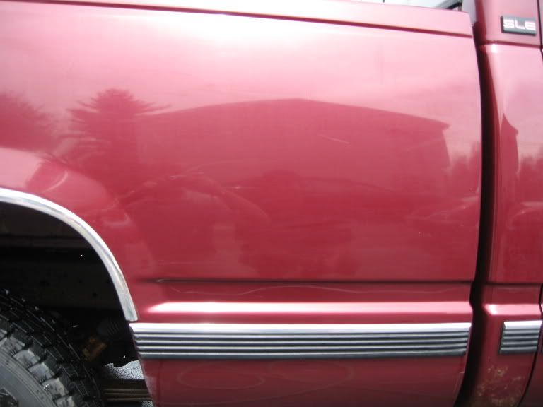

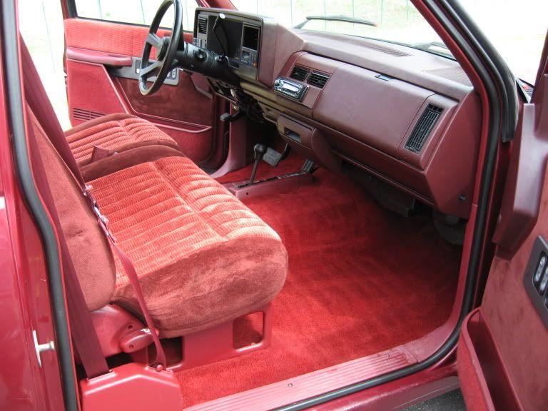

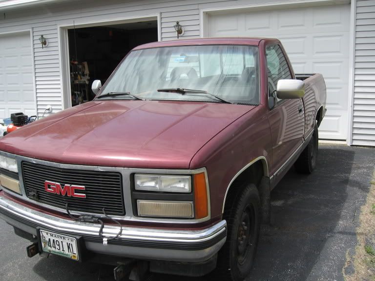

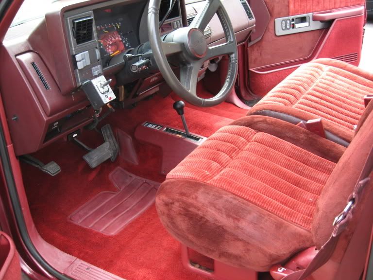

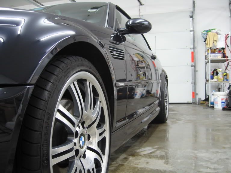

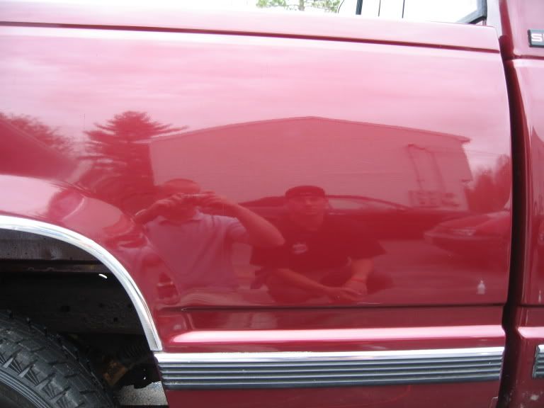

Ok my last one for awhile I promise. I did this plow truck today, I wish the sun was out for the after pics of the exterior the color really came back really nice. The truck interior/exterior took about 4 hrs. The other pics are of the same guys M3. I had crappy lighting so I didnt take any befores of the nasty swirls on the M3. The reflection pics are of me and my little brother (in black) I was trying to teach him a few things.
Process for the truck interior:
-Vac, hp air, vac, pre treat, extract
Process for the truck exterior:
-pro swirl/polish with rotary
-pro clear cut with PC white pad
-pro swirl polish with PC white pad
-pro sealant with PC black pad
Process for the M3
-pro clear cut with the PC white pad
-pro swirl/polish white pad
-P21S
-2nd coat of P21S the next day
