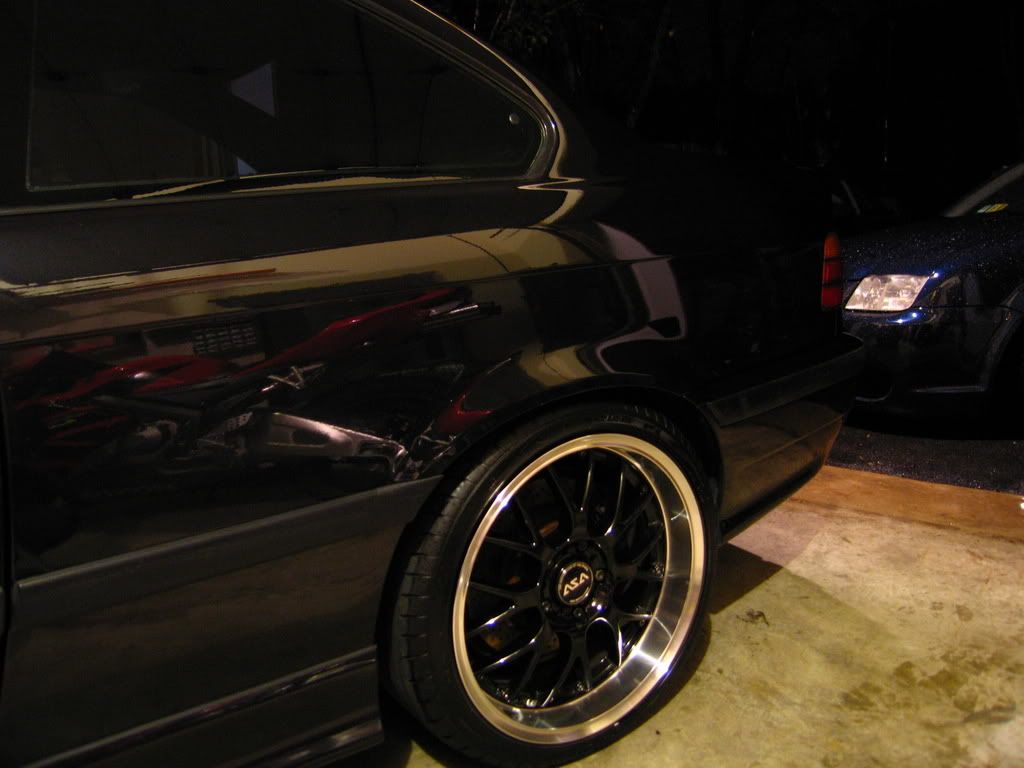

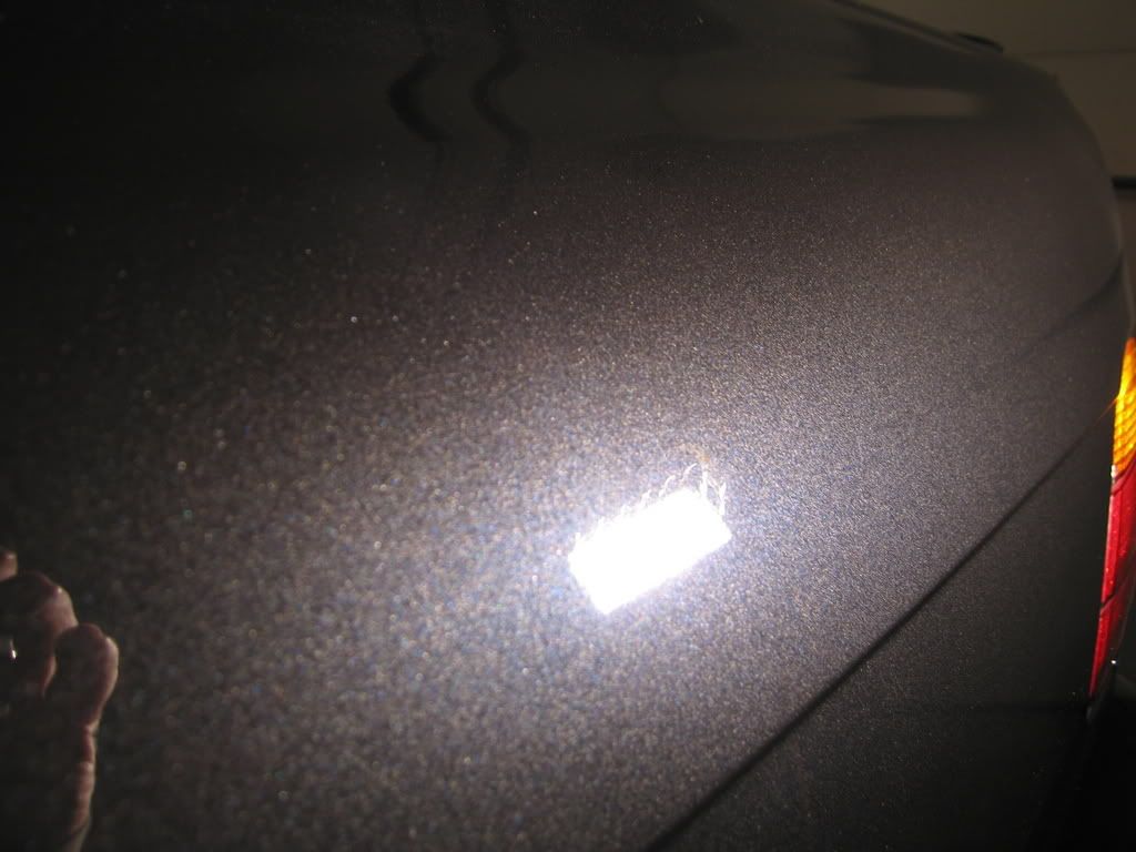

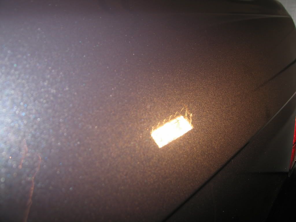

This was in pretty bad shape. The idea was to get it look really nice. Swirls, holograms removed, most scretches are also gone but not 100% of them. The owner was coming home from Afghanistan yesterday. His friend (my boddy) did this a s a surprise for him.
Clear was rock hard. Man, all these BMWs! :D The outcome was pretty good I think. Rained right after I finished the interior/engine, and didin't take any befores. You shpould have seen the paint. I though the color was flat black.

Exterior before

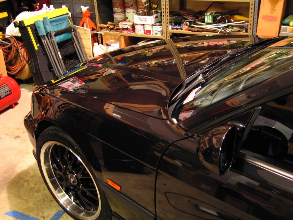

Holy shiny interior batman. :cool:

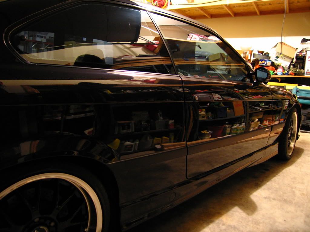

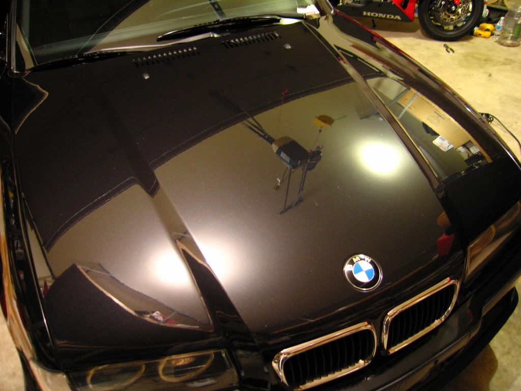

You did a nice job busting those swirls, paint is very reflective now.
What was your process? :goodjob
GREAT job on the paint! What did you use on the door handle trim? Back-To-Black?
Interior was too glossy for my taste (but I have to do 2-3 Bimmers a week for resale and the owner wants flat appearing leather).
Here's a typical interior finish in our shop.
Nice One...the owner should be very happy.
Totolant
Beautiful job on the paint. :)
Like the others, the interior is a bit shiny for my tastes but I've had customers like that look, so I give it to them.

Oooops! I forgot the after pictures for comparison.
process:
onr
clay - hardly anything :think:
new OHC/1500/2100rpm yelloworange lc pad
och pc/yellow/orange lc pad speed 6
poli seal (first time) pc tol orange pad speed 6
CG's extreme top coat xxx carnauba pc blue propel pad speed 3
FK1 #108 on tires

Door handles get polish/sealant in my details.
