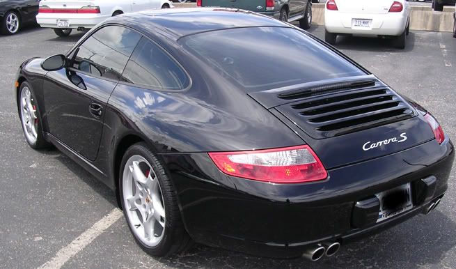

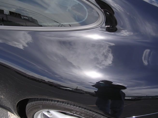

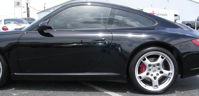

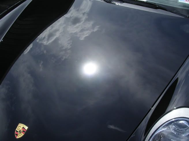

This was a Porsche with some light marring so I did a 2 step polishing process. First step, rotary with a finishing pad and OCP and then used my Cyclo again with OCP and 2X OCW.
Light interior cleaning also.

Rotary with a finishing pad + OCP? Which finishing pad? Why did you have to hit it with the cyclo afterwards?

Thank you Merci and Greg.
I used a white finishing pad, 100 ppi at around 1200 rpm's. I used the Cyclo with Lake Country Blue pads to clean up any fine buffing swirls. I gave it 2 coats of OCP because of some smears I got on the paint because of sweat....man it was humid today in South Texas!! :faint:

I only find one thing wrong with these pictures: their size!!! Please make them all the same large picture. We love studying them. :) :getdown :getdown :getdown

Yea, not sure what happened there :nixweiss
But as requested I fixd em!

BTW, aren't those Carrera S/4 wheels a PITA to clean? 5 spokes are great, but what's the deal with all those holes in 'em?

I can from personal experience tell you the rims are a huuuge PITA to clean :) I have the same 19" Carrera S wheels on my '05 Boxster S (crappy pic quality)

Yea those wheels can be a huge pain because just when you think you have them clean you then move the car and suddenly :doh ...you missed a crevice!!
While those Porsche wheels suck (but the look great when clean) they are not as bad as the new Turbo wheels!!

I find the best way to clean them is get a waffle-weave type MF towel, dip it in the suds, (after a pre-spray with wheel cleaner) and use my index and middle finger, wrapped in the towel, to scrub out all the little crevices, starting from the inside out.
I've got all the scars, however, to prove that i clean the inside curvature of those wheels every wash :)

Ever try a cylindrical BHB for the recesses in wheels like that? Some of our vehicles have deep tunnels for the lugs/valvestems and (other than using swabs) I can't clean 'em without the BHBs. The BHBs rinse clean so they beat the swabs IMO. Just a thought (gee, how often do I think of something to suggest to *you* :D ).
