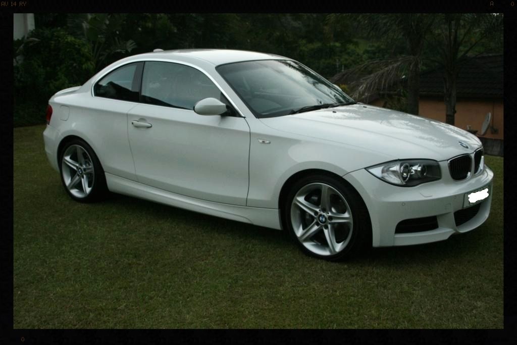

A few pics of what the car looked like on arrival.
Not too bad without the sun shining on it

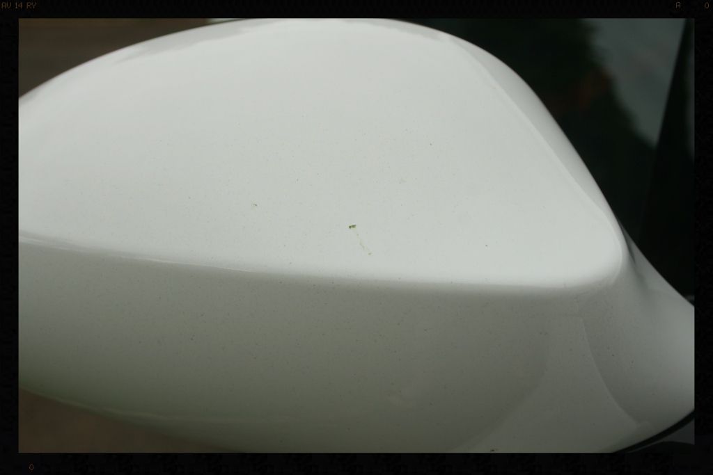

A lucky landing....on the glass. It is much harder for the uric acid
to etch into the glass than it is in paint.

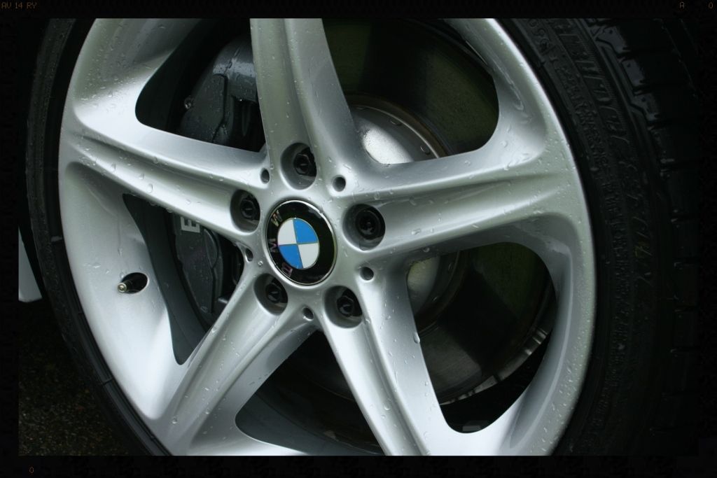

So what do wheels that have done less than 3000km look like. They look pretty clean.
But looking closer
Barrels had a fair amount of dirt.
Faces had a little too

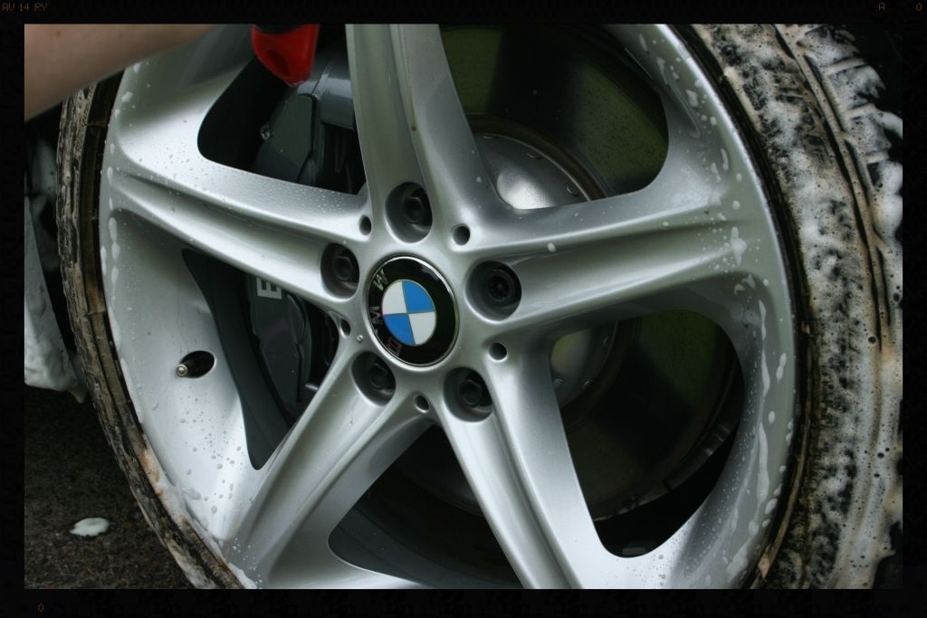

So let's clean some tires
The tires were sprayed with Meguiars All Wheel and Tire Cleaner.
As you can see before I even start agitating it using a Mothers Tire Brush it starts to pull the dirt, road grime and antiozonant out of the tire
After brushing though the dirt really starts to come out
After a HP rinse, the tires are now clean. This will ensure when the tire dressing applied it will be able to properly bond with the rubber.

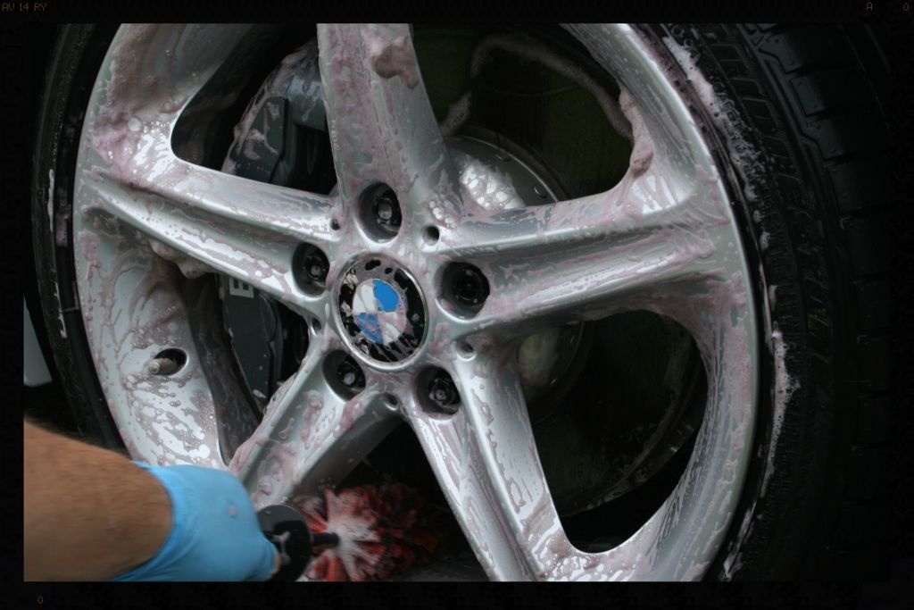

I then used Cyclo APC 5:1 and a Daytona Jnr brush to clean the wheels. This was followed by Autofinesse Oblitarate to remove any tar residue and then Cyclo APC 5:1 again, to clean any remnants of the tar remover off the wheels to ensure that the the iron remover would not be hindered from making contact with the wheels through this 'film'. I used the Daytona Jnr to 'work' the Autofinesse Iron Out over the barrels, behind the spokes and the faces of the wheels.
The wheels were then HP rinsed before being clayed with Autoglym Fine Detailing Clay and Carways Mist and Wipe as lube.

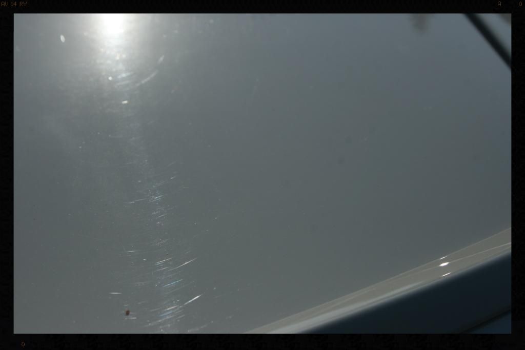

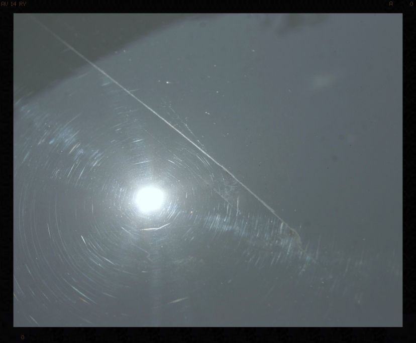

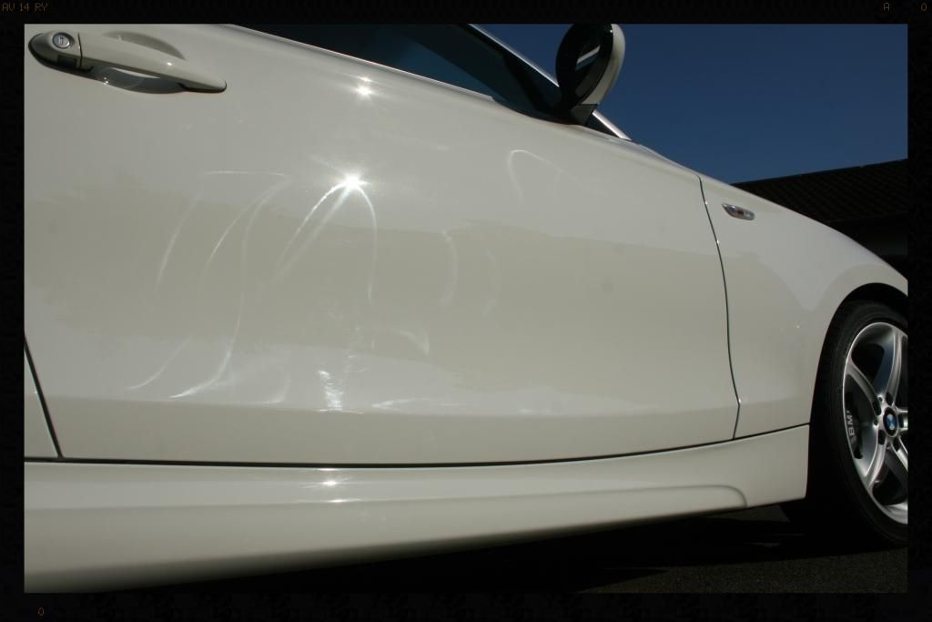

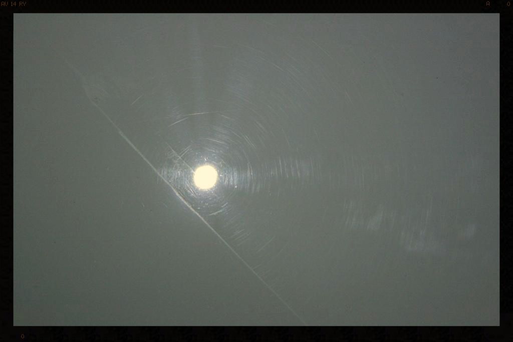

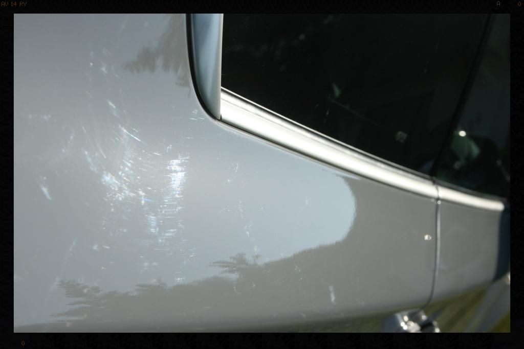

By this time the sun had come out and I managed to see what was really going on with the paint and unfortunately, all the usual defects were present.
Swirls
And buffer trails
And even some etching
A 1-step correction had been agreed on and so my weapon of choice on this German beauty.... was ze German polish, Menzerna PF2500, coupled with a Lake Country 5.5'' HT Tangerine pad on a DA worked at speed 5 with a really slow arm speed.

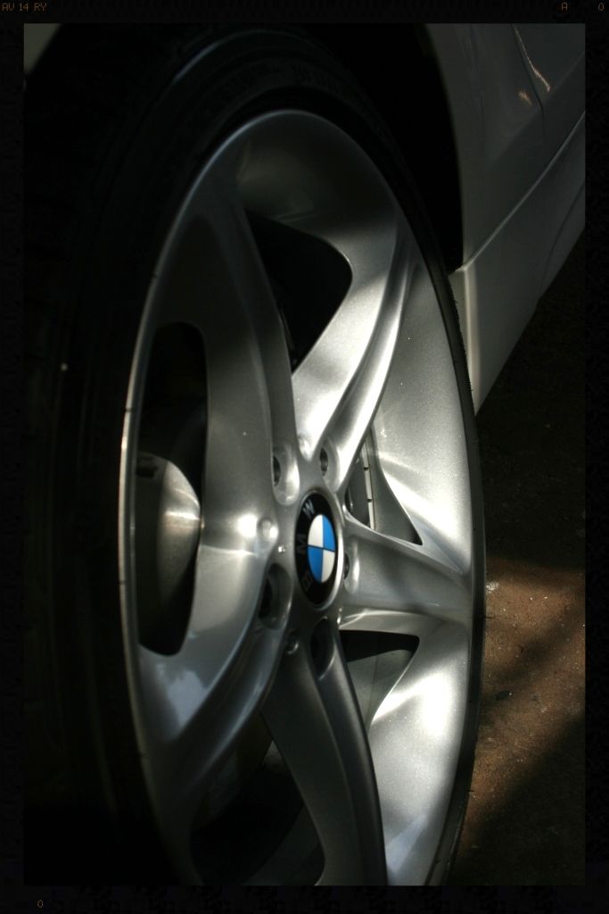

Powerlock was applied to the wheels and tire dressed with Optimum Optibond Tire Gel. For some reason I just really like this pic of the wheels with the natural light from the garage window shining on it.
