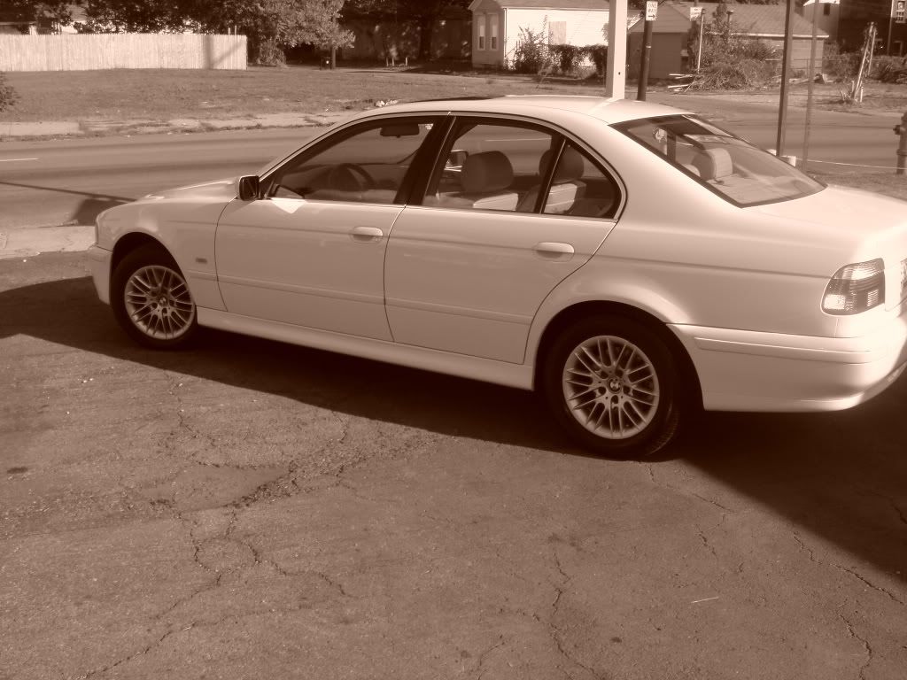

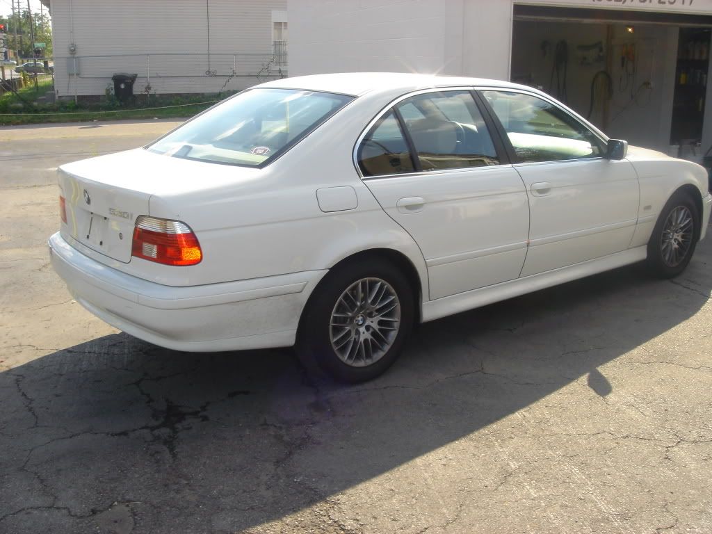

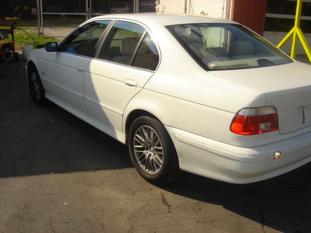

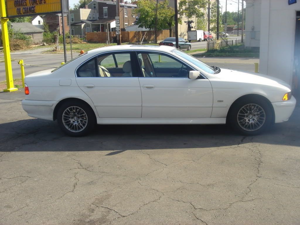

2002 BMW 530i white/beige
not in bad shape but dirty, the front bumper is being replaced due to how many battle scars it had, cheaper to buy and paint than to pull off, bondo, sand, and paint.
wash/clay sponge
wheels/tires- detailplus wheel cleaner/degreaser
engine bay foamed/rinsed and dressed with quickshot

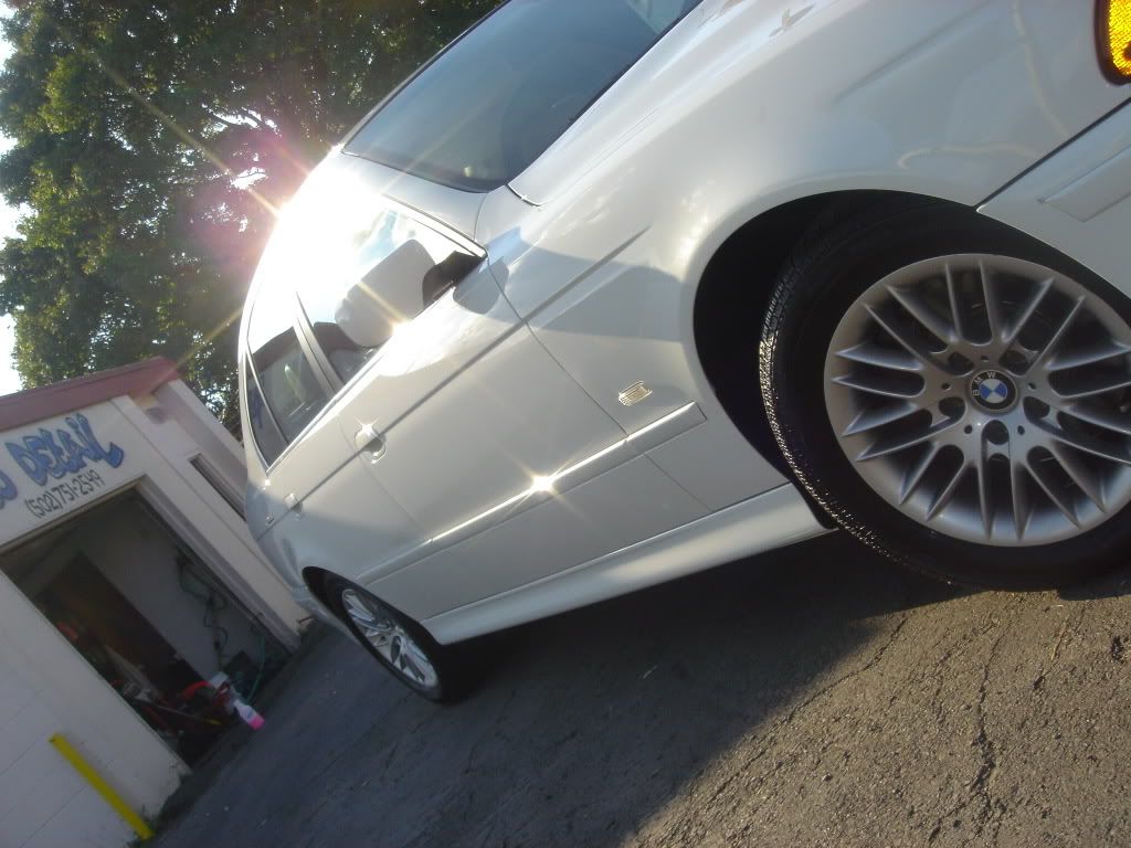

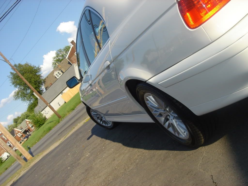

makita with light cut pad 1300/2100 meg diamondcut
prokem carnauba sealer by hand
BEFORE EXTERIOR

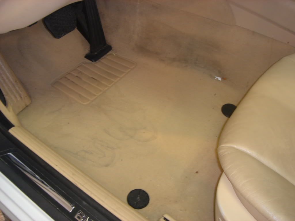

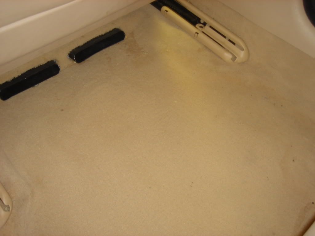

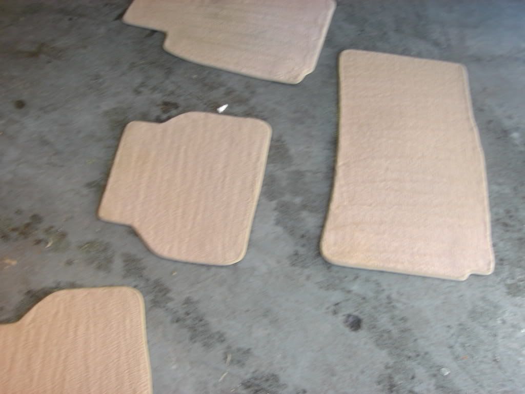

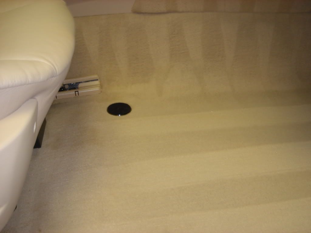

FLOOR MATS BEFORE

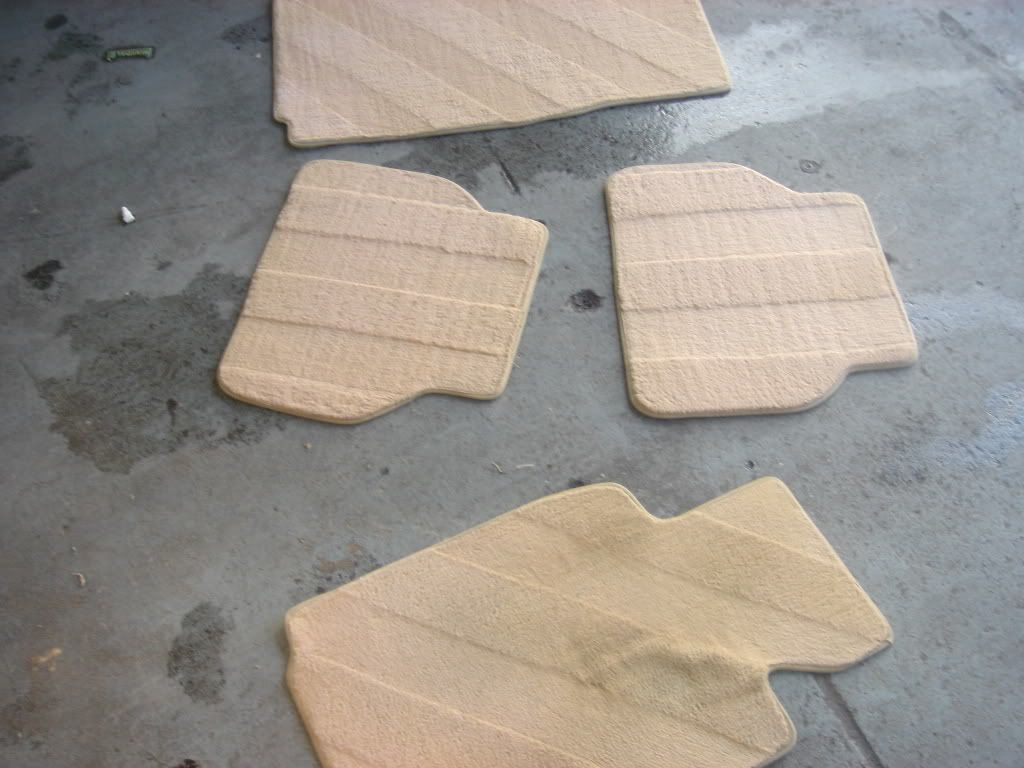

FLOOR MATS SHAMPOO AND RINSE
FLOOR MATS EXTRACTED..AFTER

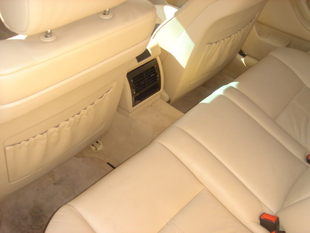

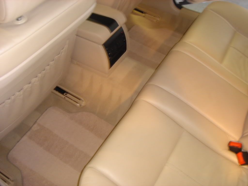

Car looks great especially the improvement on the interior.
Just curious.....what did you use on the interior seats?
I use an APC that my chemist and I came up with, similar to a product called blue maxx, but more concentrated and less caustic, a gallon goes a long way, cut 5:1 for interiors, I also used Mr Jinx on spots that may need a bit of dwell time
mr.ikon said:
Nice clean work. Man i really need to sharpen my skills without the use of an extractor. Thats CLEAN!!
I vac, shampoo,extract(tennant 1110) then wipe with terry cloth to get nooks and crannies, then brush or vac in the lines
Awesome work imageautodetail ! great correction on the interior looks new again, and that seat shot looks like what i did today on a MB E320 ...............:bow
That looks killer. Very wet white.
You did an outstanding job on the interior, you definitely locked the owner into standard maintainance.
I do follow ups via emails and the seat shots are always a good way to completely disgust your customer into a more frequent rituial of maintainance. This lady said " the inside isnt that bad just needs to be wiped down and vacuumed" The before/after pix that I send also take away any pains from my invoices
