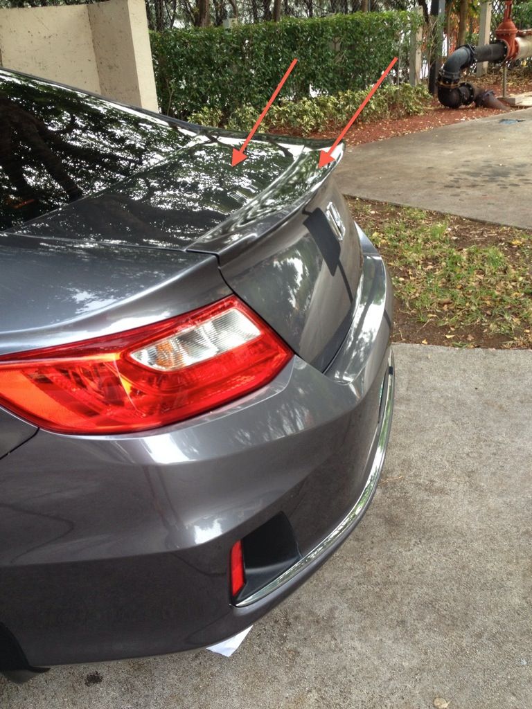

Just added this spoiler to my new car and there is marked diff between the gloss of the trunk (sheetmetal) and the plastic spoiler. I am a veteran detailer so I understand to get a real match, the answer is to re-spray the spoiler with more clear and polish and buff. I have done that before.
But looking for a short term "cheat" to get max gloss now until I can re-clear it later in 2013...any and all advice appreciated. Right now I only have access to A GG6...no rotary...
thanks

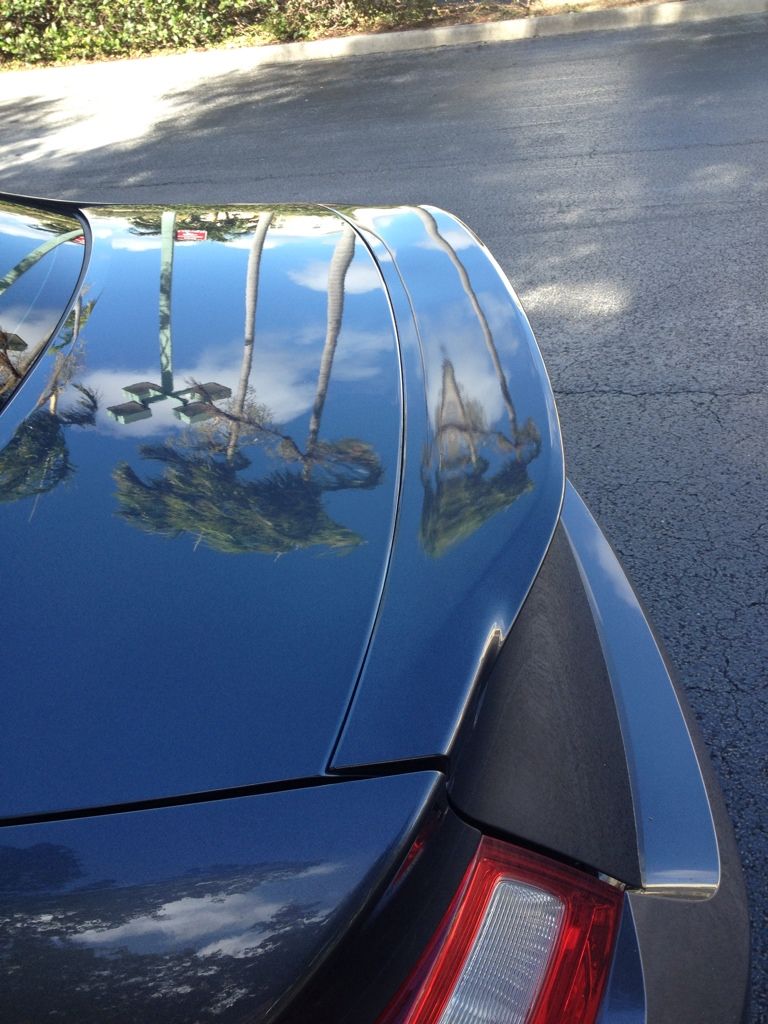

thanks- will report back tomorrow....as soon as I saw my UC on the shelf I thought that was the one I would use....
Dan -
Just worked on it for 30 min....UC, then UP, then 4500 with orange and black....
I can get it "better" with the UC - and even the 501 - and now it is close... but it needs a rotary and wool I think - seeing if I can borrow one....
