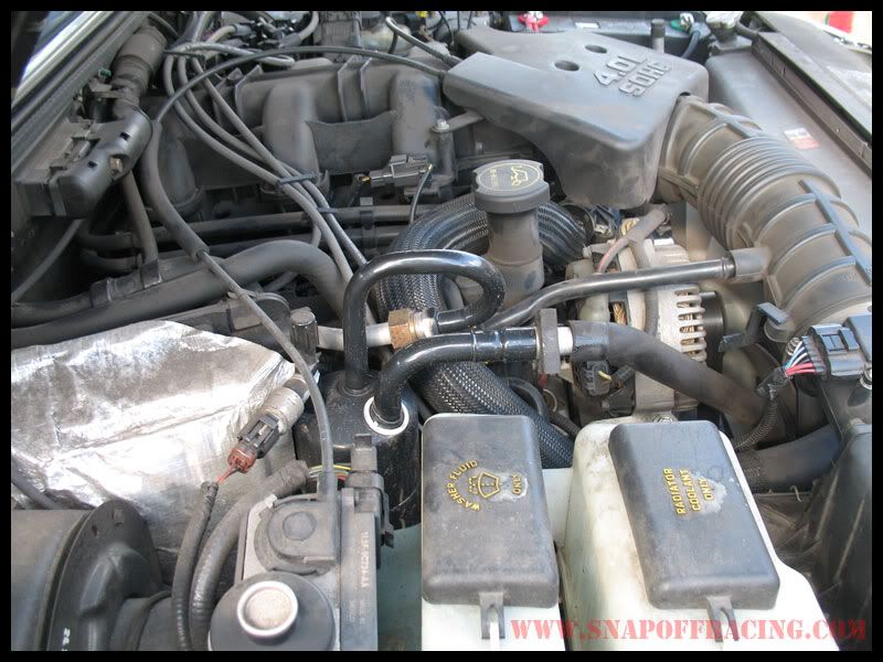

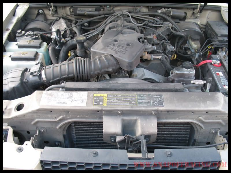

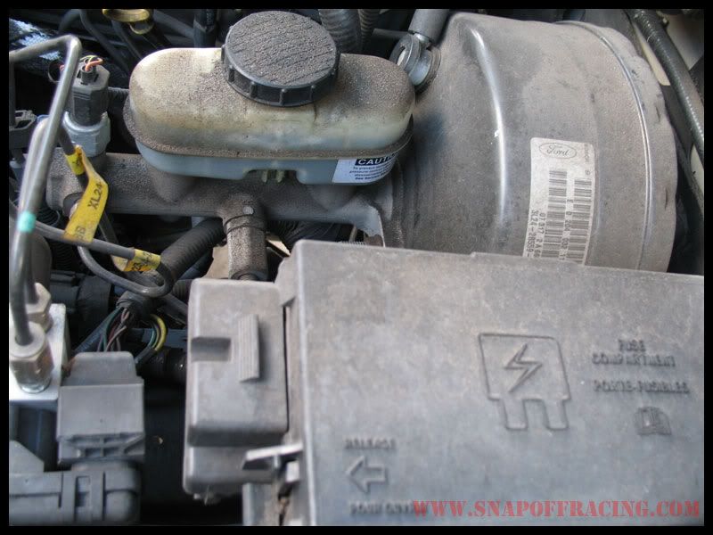

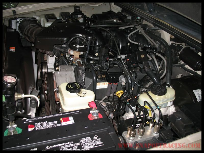

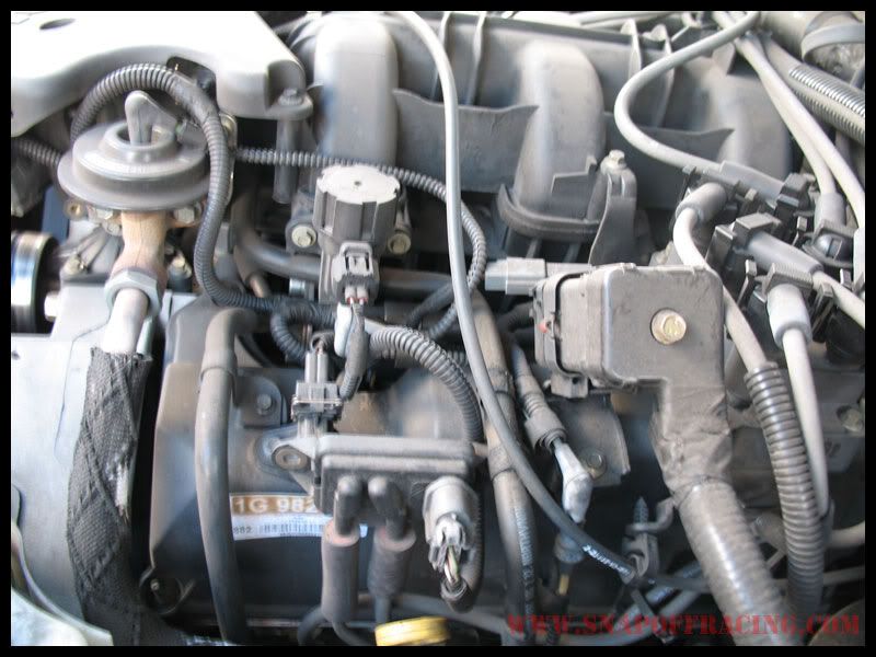

Before:

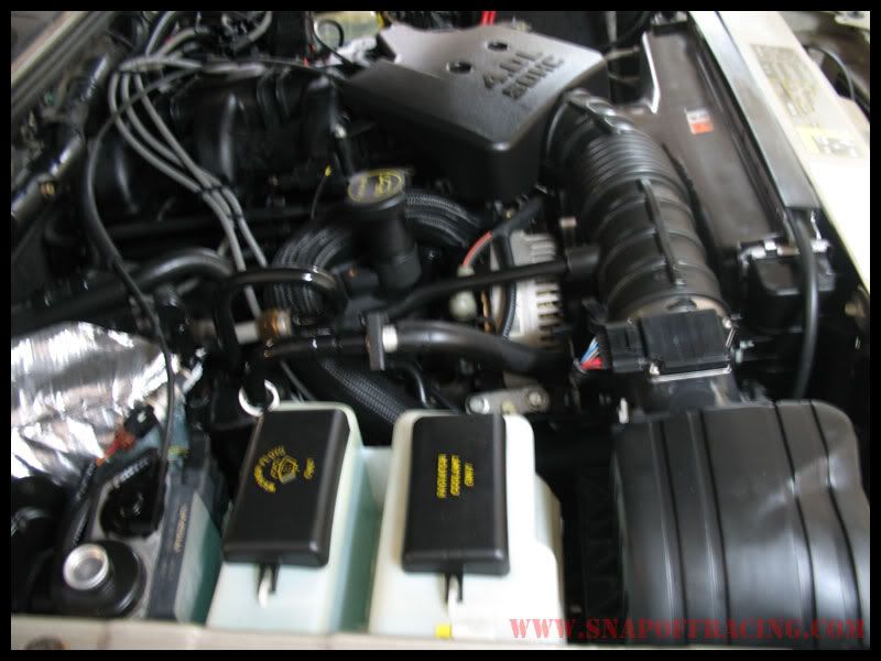

After:

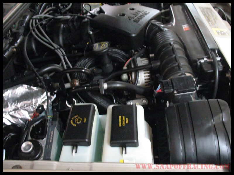

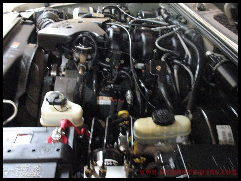

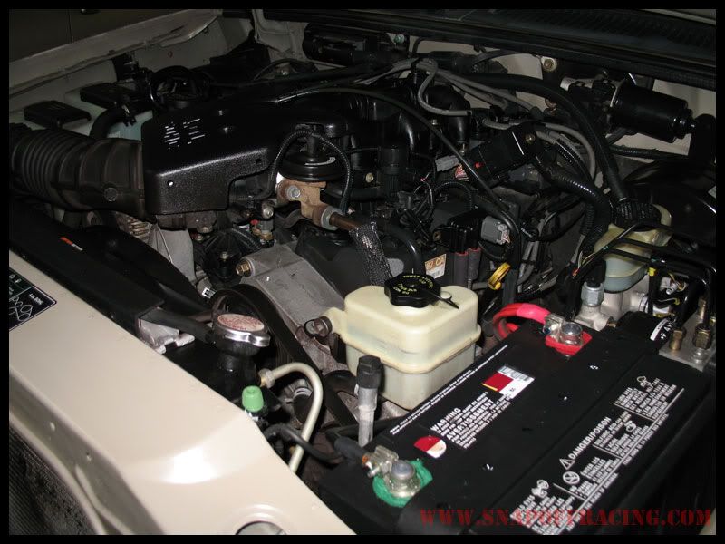

Here and engine bay I did with CD2 after cleaning it with the same method as above beside spraying the tire gel
