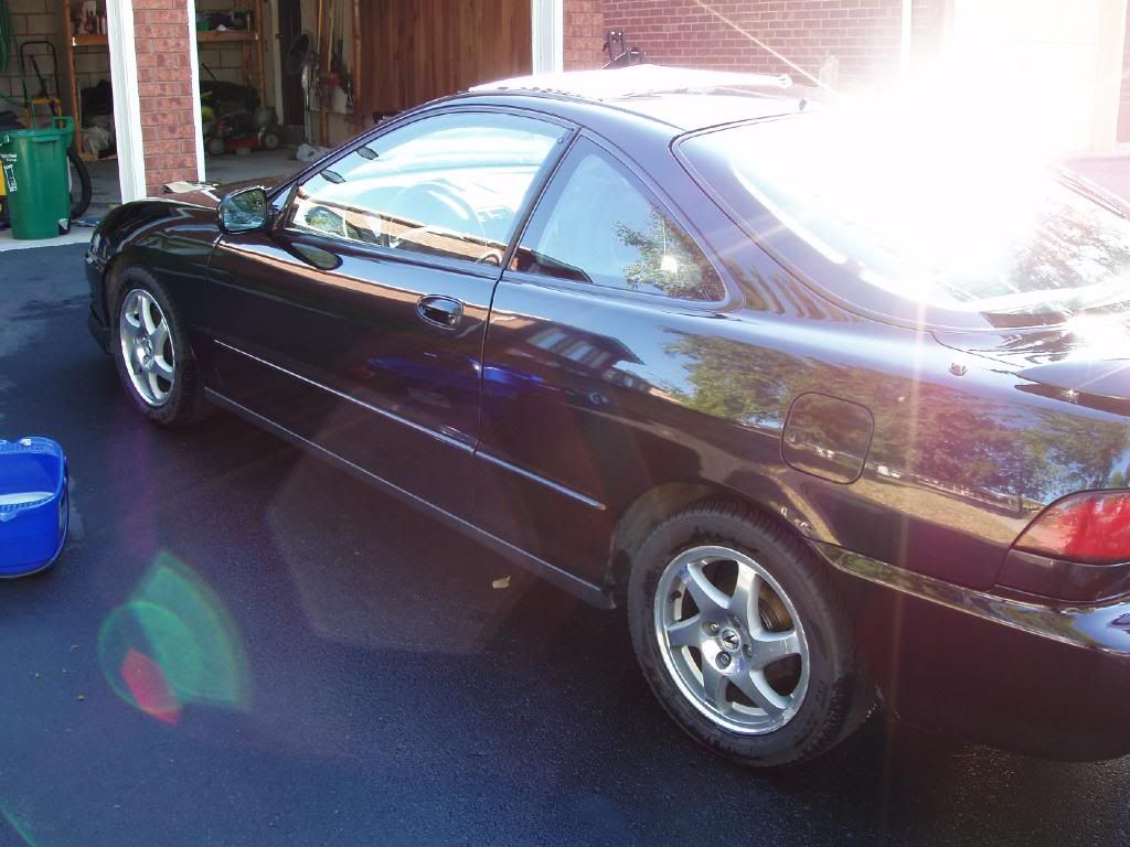

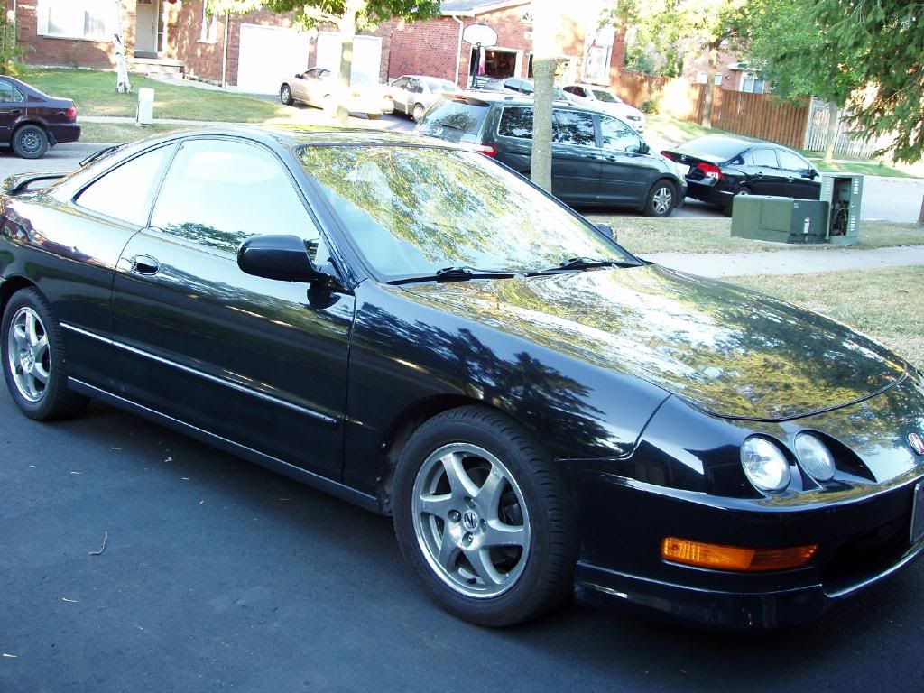

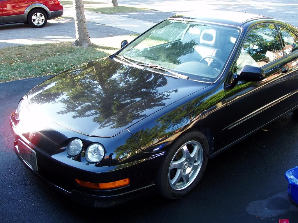

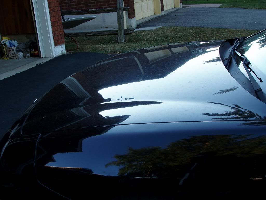

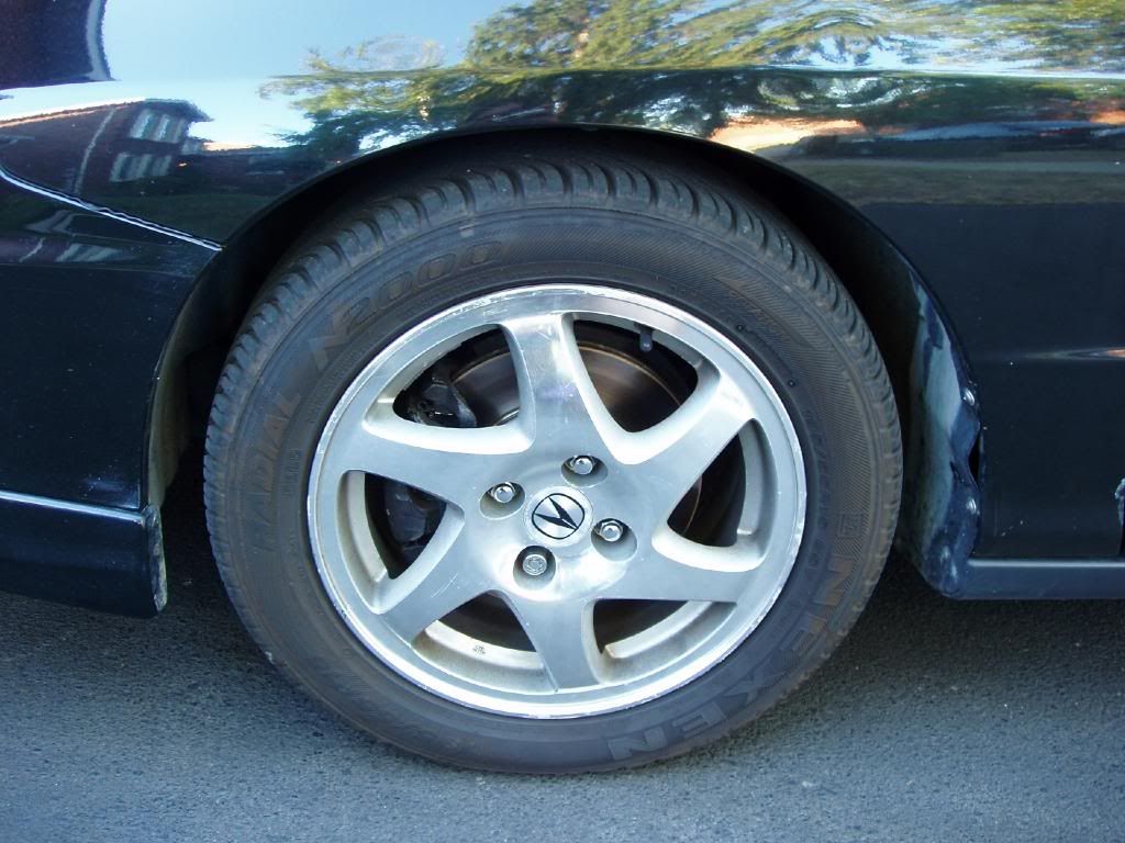

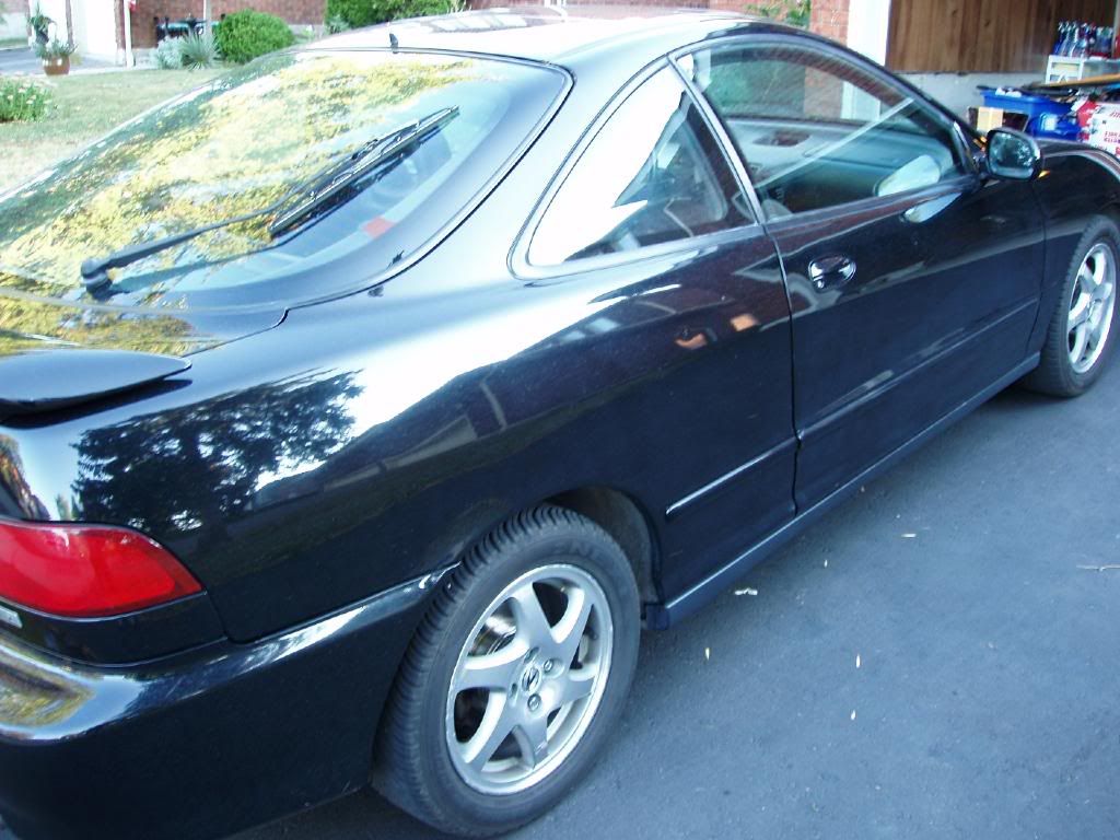

Here is a 2001 Acura Integra GSR, owned by a good friend of mine who had picked up the car a few months ago. The car was in absolutely mint condition from a mechanical perspective, but appearance-wise was another story. I drove the car with my friend a few weeks before I detailed it and was blown away at the performance for a car that has over 165xxx KMs. The previous owner sure kept the paint clean (didn’t need claying), but left behind some terrible swirls.

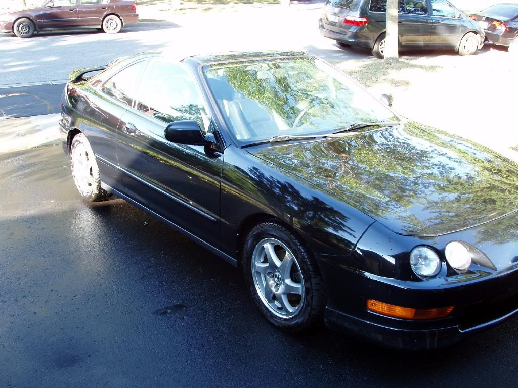

Before wash.
Process:
Wash with Meg’s GC via 2 bucket method + sheepskin
Dry with WW MF

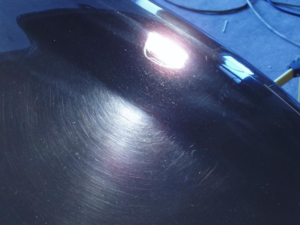

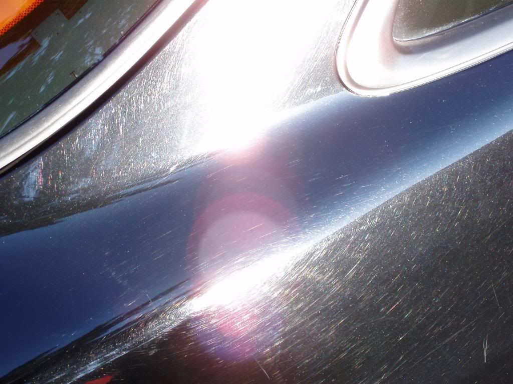

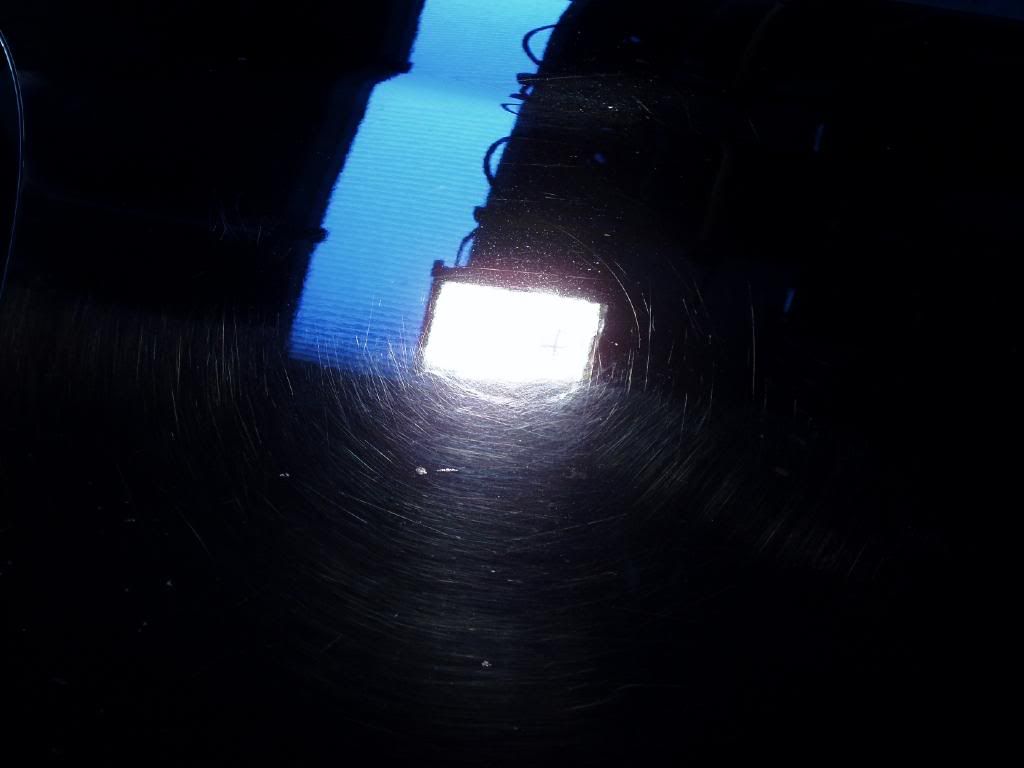

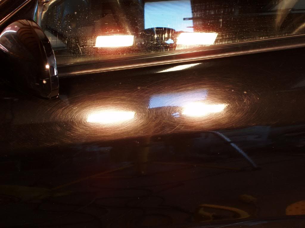

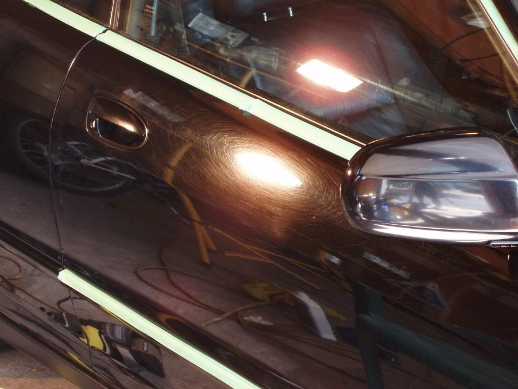

And here is a little preview of what I was going to be dealing with…
So I pulled the car into the garage and went to work. I recently picked up a rotary and have been eager to keep learning how to use it, so I pulled it out and did the hood.

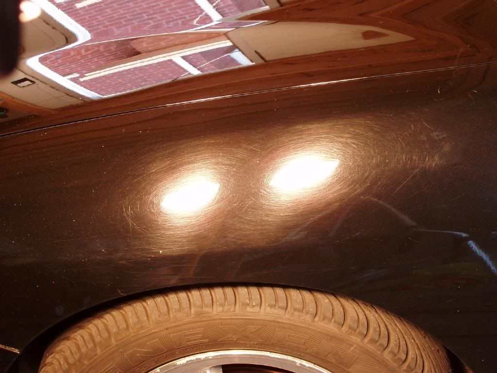

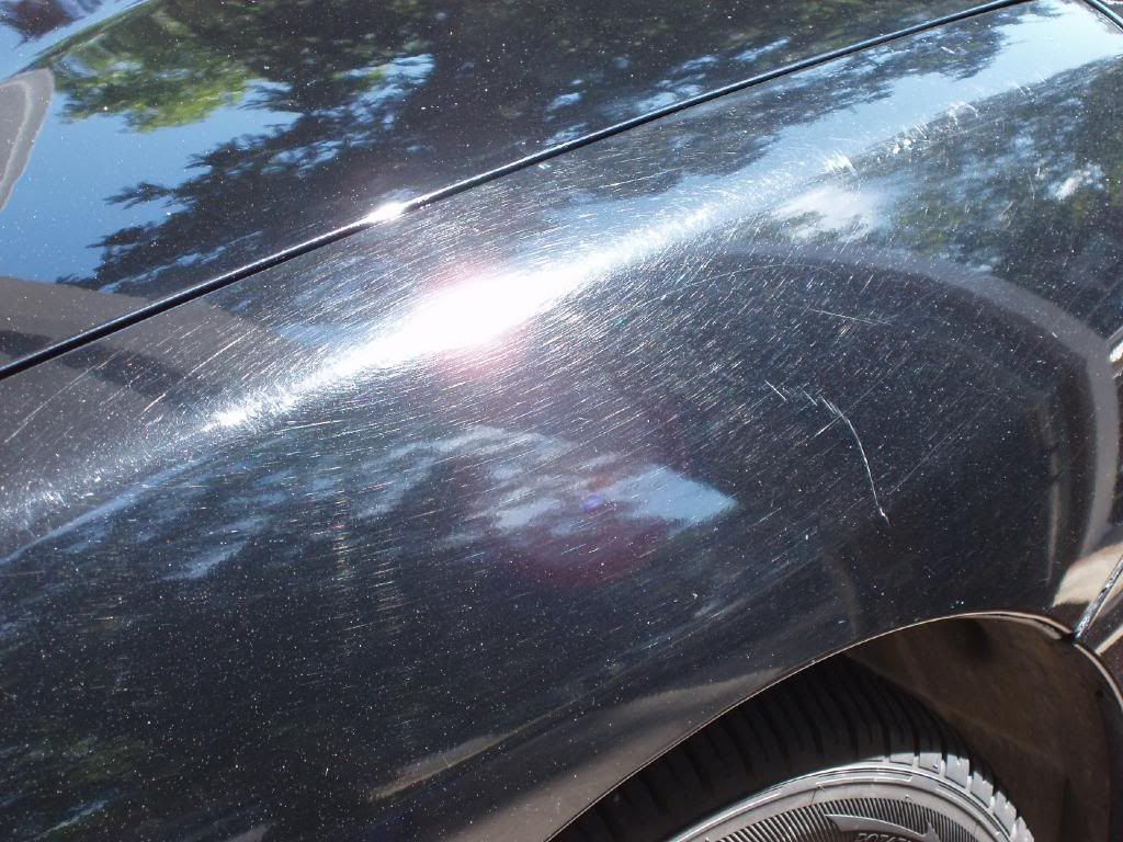

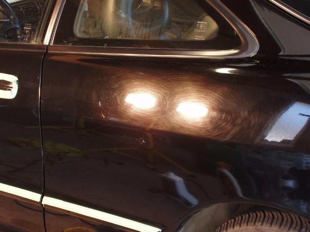

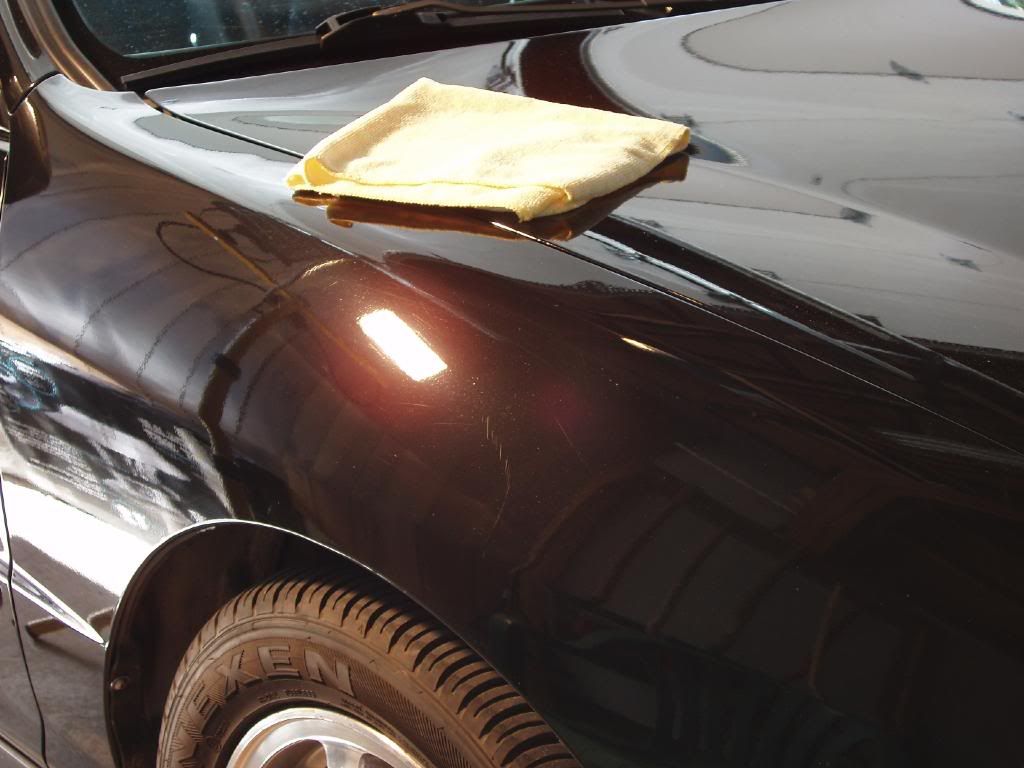

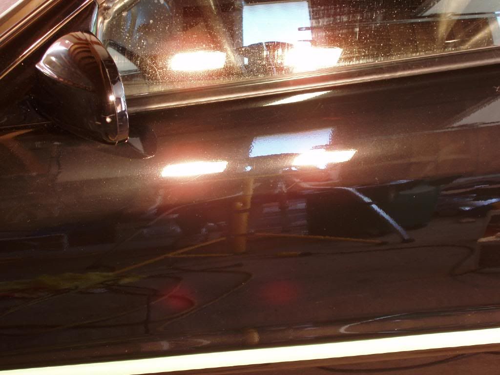

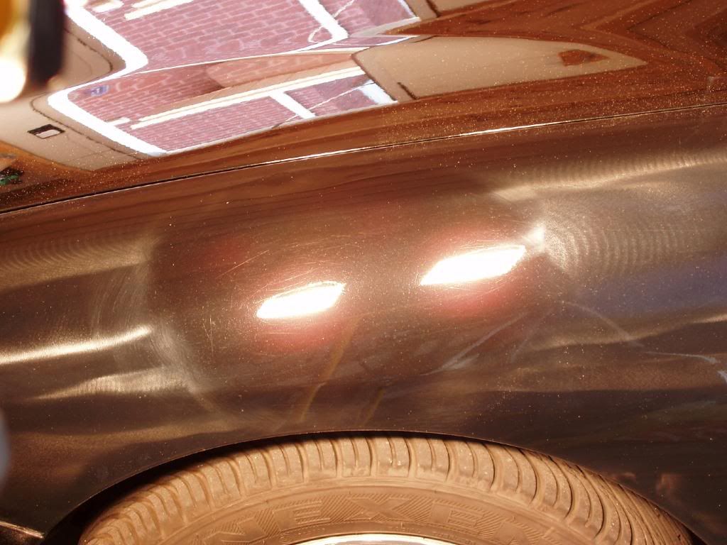

Driver’s side front fender:
During…

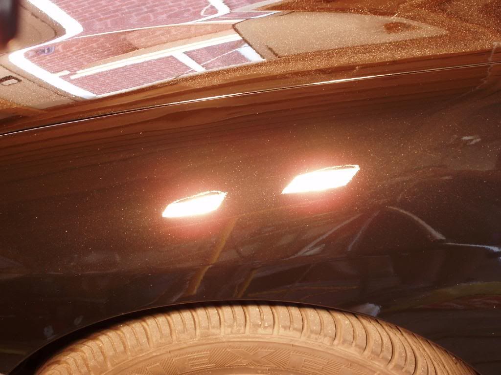

…worked it in a bit longer, then followed up with PO106ff to see what the result would be, and viola…

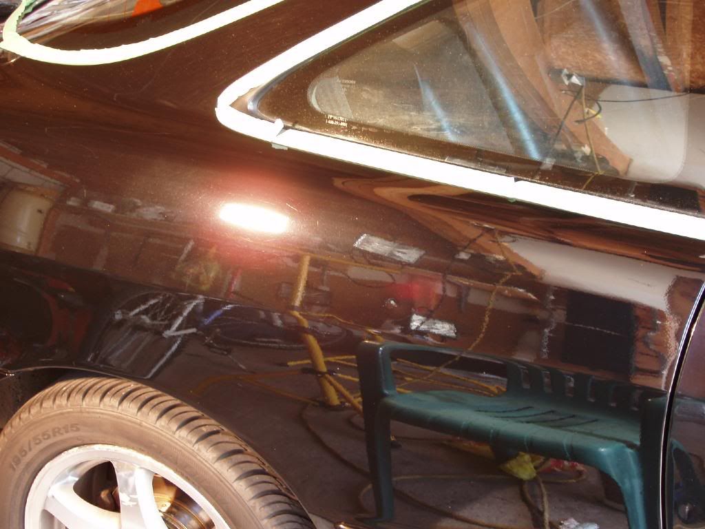

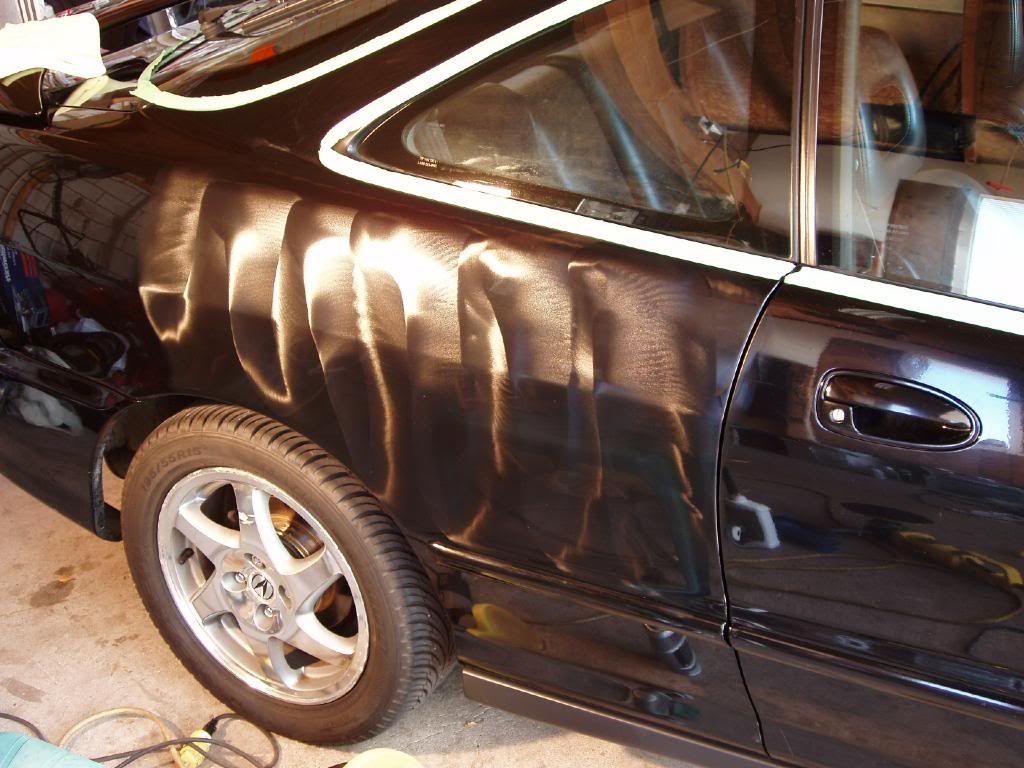

So now with some results that I am happy with, I proceeded to do the rest of the car. I PCed most of it and on the flat surfaces like the hood and roof, I did it with the rotary to get some more practice.
The rest of the After pictures are after compounding

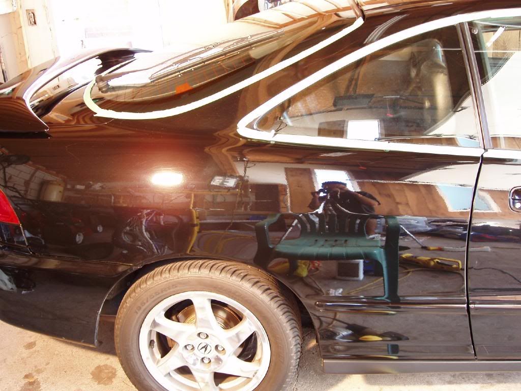

Rest of car…

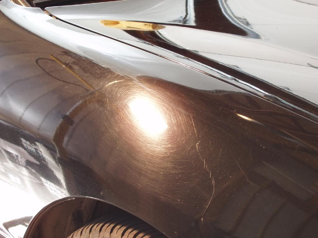

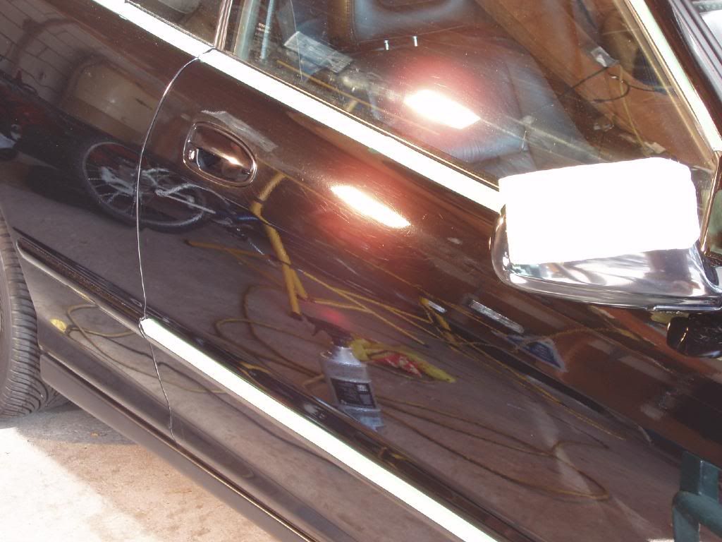

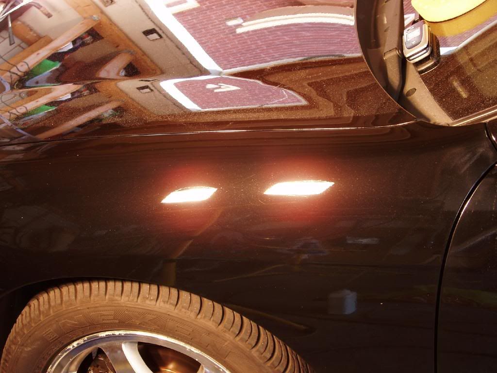

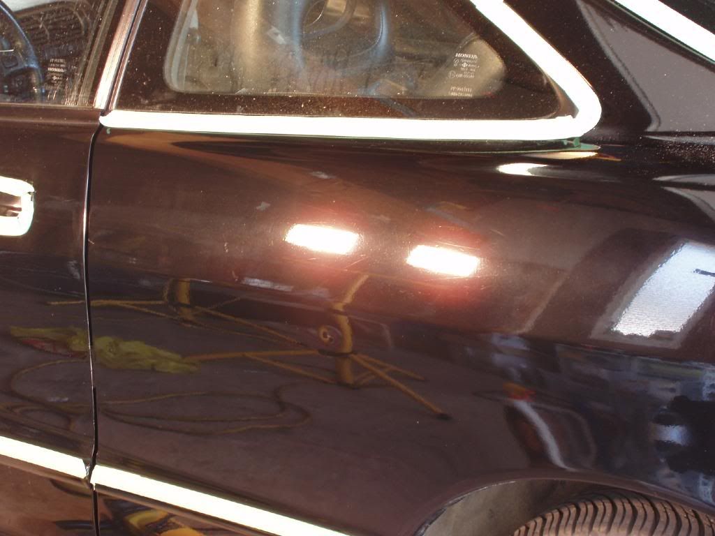

Passenger side fender preview:

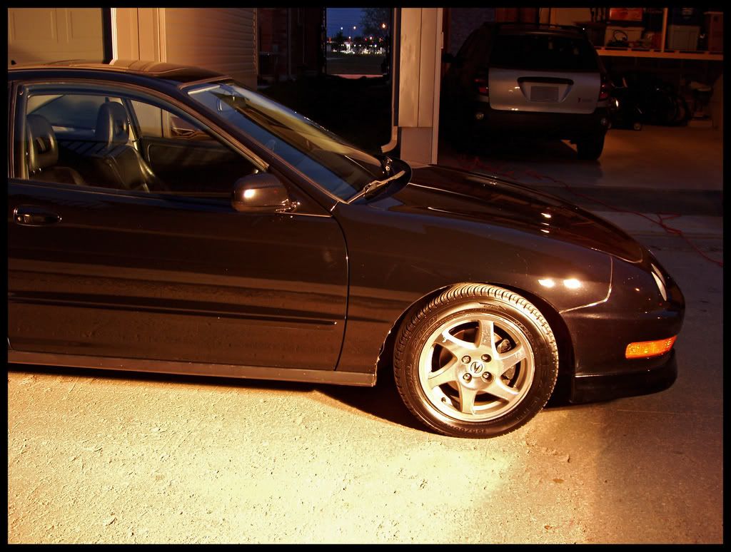

Turned the car around and brought it back in the garage
After PO106ff
After final polishing, I did an IPA wipedown to get rid of any remaining oils from the menzerna. Following this, I applied opti-seal, and then #26.

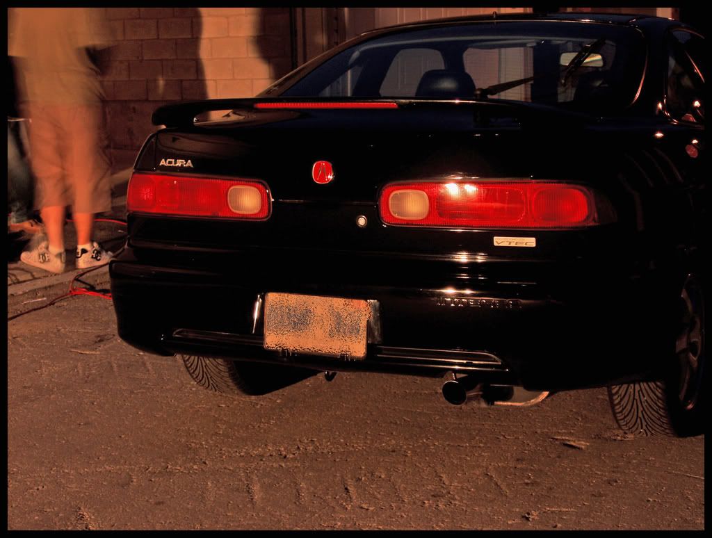

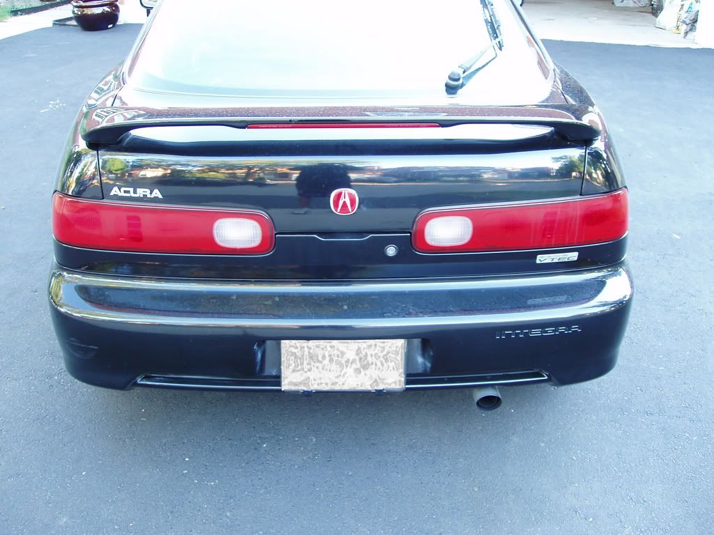

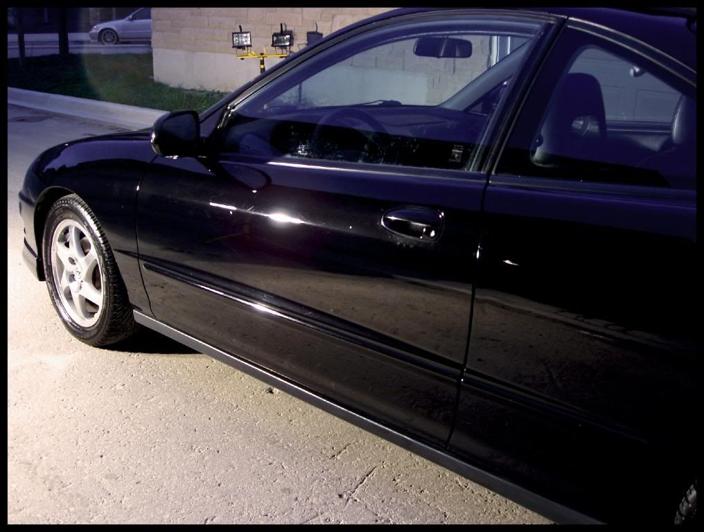

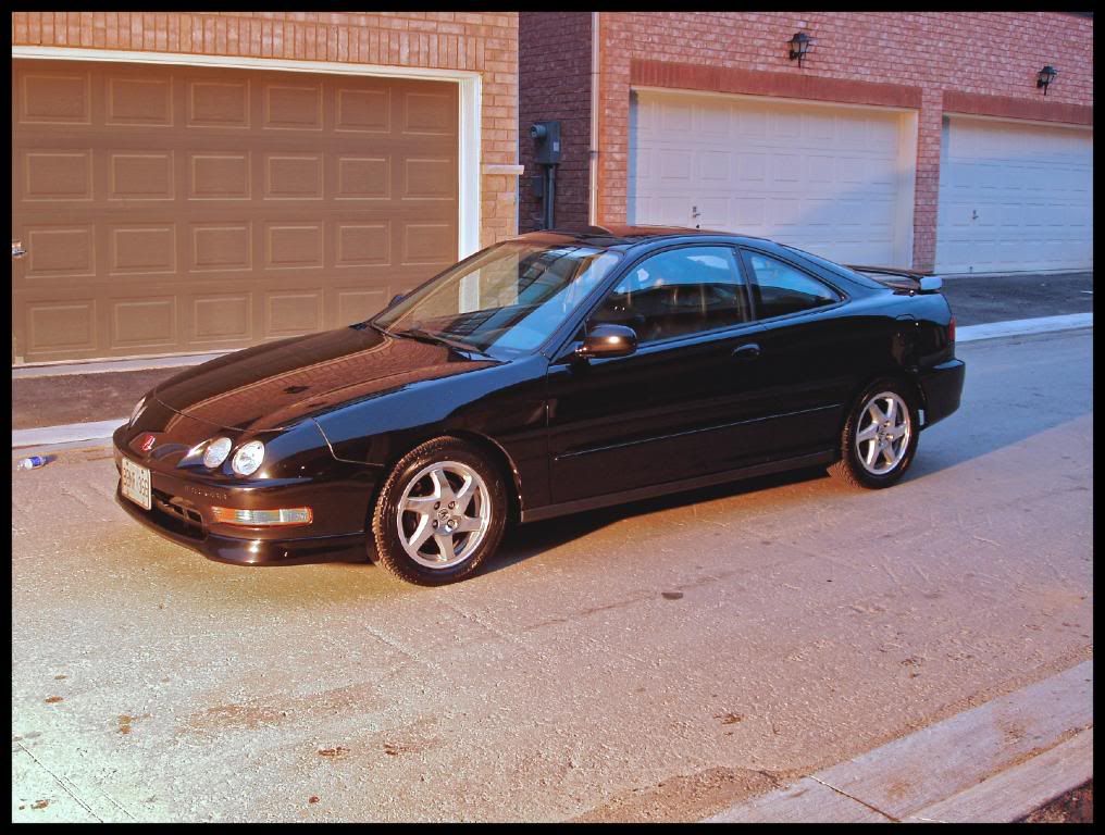

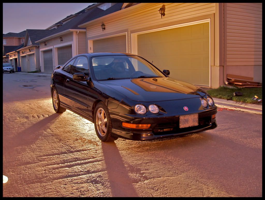

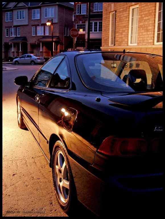

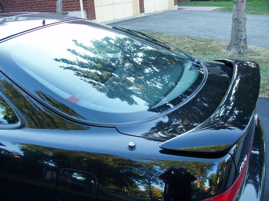

FINALS
Unfortunately I did not get very good pictures of the car. Time and daylight was against me for this detail. These pictures were taken a day after the detail. I was on my way to get daylight pictures but got stuck in traffic coming out of downtown Toronto so I got there late. Here is the best I could do for the time I had…
I will be going over some spots again in the Spring before it's taken out of storage, and at that time I will be sure to get some better pictures.
