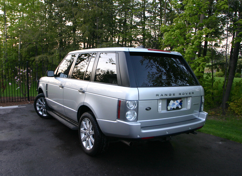

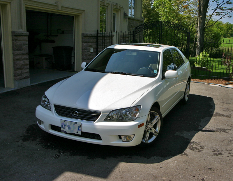

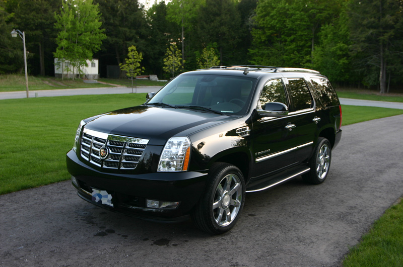

I actually washed three more cars that day (long day), all of these just got OCW as a topper.
