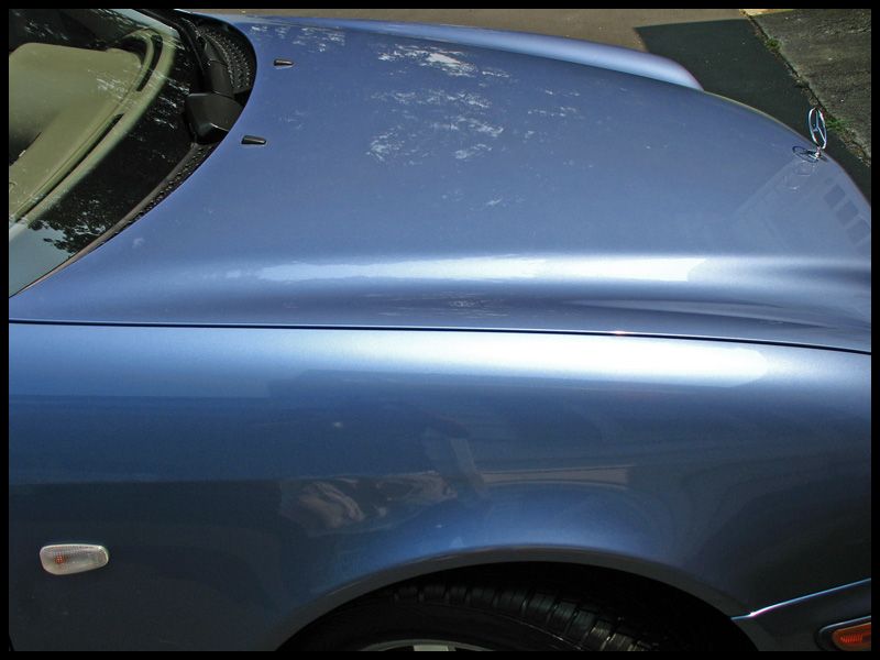

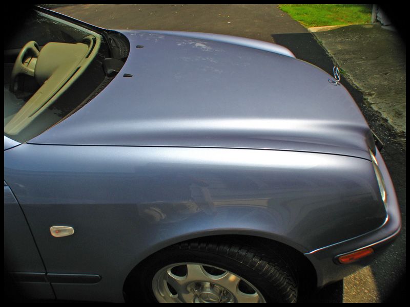

Checking/Failure/Dullness
Before
After

wish the sun was brighter before compounding...these spiderwebs were deep and plentiful

A superb job Sean; nice results with the polarized filter too! It looks like either bad chrome on the lug nuts or strong wheel acid was used too much in the past. What year is the CLK if you don't mind me asking? You wouldn't think the clear would fail that soon would you?

Acid isn't the word. The fact that the jams were heavily water spotted, dulled, stained, and oxidized led me to believe some really harsh chemicals have seen this vehicle.
Further, random spots of clear failing were abundant. The entire lower rocker section on the driver's side had clearcoat failing. The passenger side was completely repainted sometime in the past (lots of sanding tracers).

I'm curious as what the finish looked like after a rotary pounding at 1900 with a cutting pad ????? holee !!!! why so high speed ? that's a lot of heat generated.. I assume due to the time issue ?
tumbler: More like, the swirls were really deep. I stepped in at 1500 and the finish was laughing at me. Just out of sure experimentation, I stepped it up to 1900 with new beads of product and I was off! It chopped it up really nicely.
