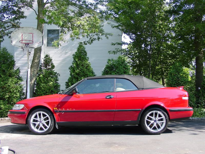

First up, Liz's Snaab.

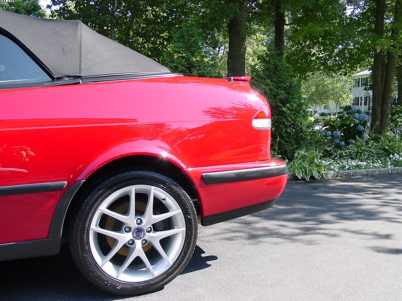

Well taken care of as I see it often ;). OCW died at 2.5 months but did so with style. It protected better than NXT paste wax (that was on the trunk). Car was washed every 7-10 days with NXT wash and sat in the elements 24-7. Her car is red, so that means very hot and when at her parents house was exposed to heavy sap and pollen. I had to polish out some water spots and extremely light marring, but other than that, it was very easy. Finals used:
-FPII via rotary and LC Polishing Pad @ 1500 rpm
-PwC White via rotary and LC Finishing Pad @ 1200 rpm
-Natty's Blue spit shined with NXT Speed Detailer
-Optimum on tires/wells
-PB TR on trim

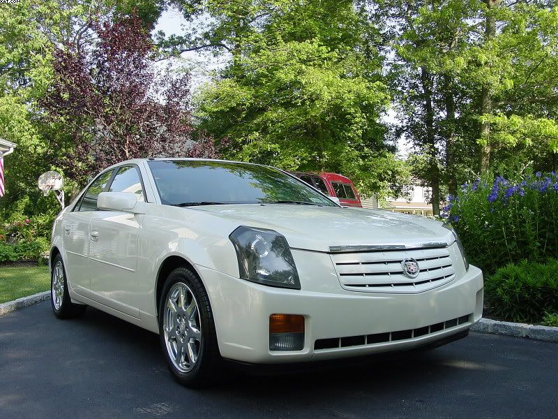

Last for the day was my father's CTS. This thing needed some serious TLC. I haven't buffed it or given it more than a wash in about a year. It was pretty swirled as he just runs it through the car wash, but I refused to spend a lot of time on the paint if he won't take care of it. In the end he was absolutely thrilled and said it looked like it rolled off the showroom. No interior pics, but the exterior was:

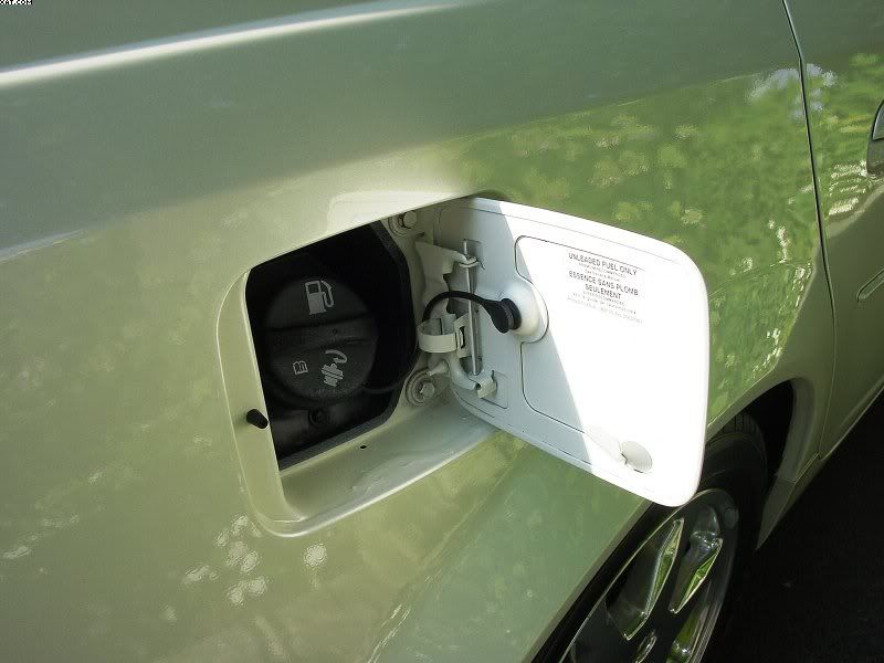

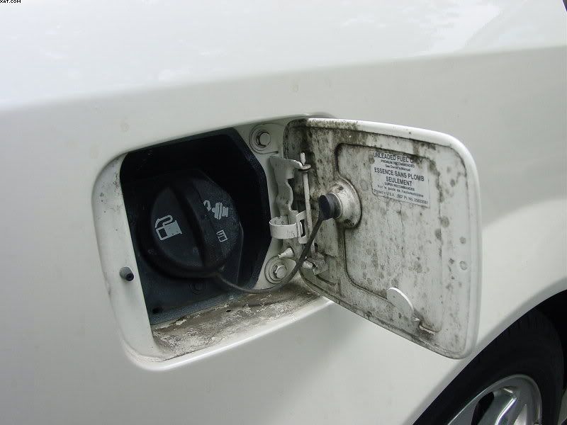

-APC 10:1 and Tarminator to clean up gas door and inside/ OCW to protect
-PB wash and clay

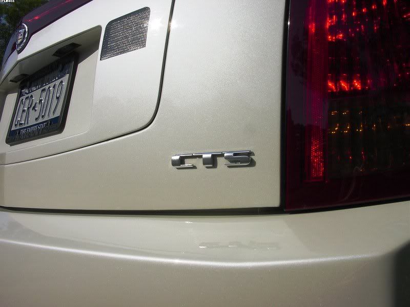

-Turbo Wax pre polish enhancer via rotary and LC Polishing Pad @ 1200 rpm
-Turbo Wax Sealant by hand
-OCW by hand
-Turbo Wax tire gel on tires
-Hyper Dressing in wells
Before
After
All the direct sun shots didn't show any characteristics so the shades were a must.
