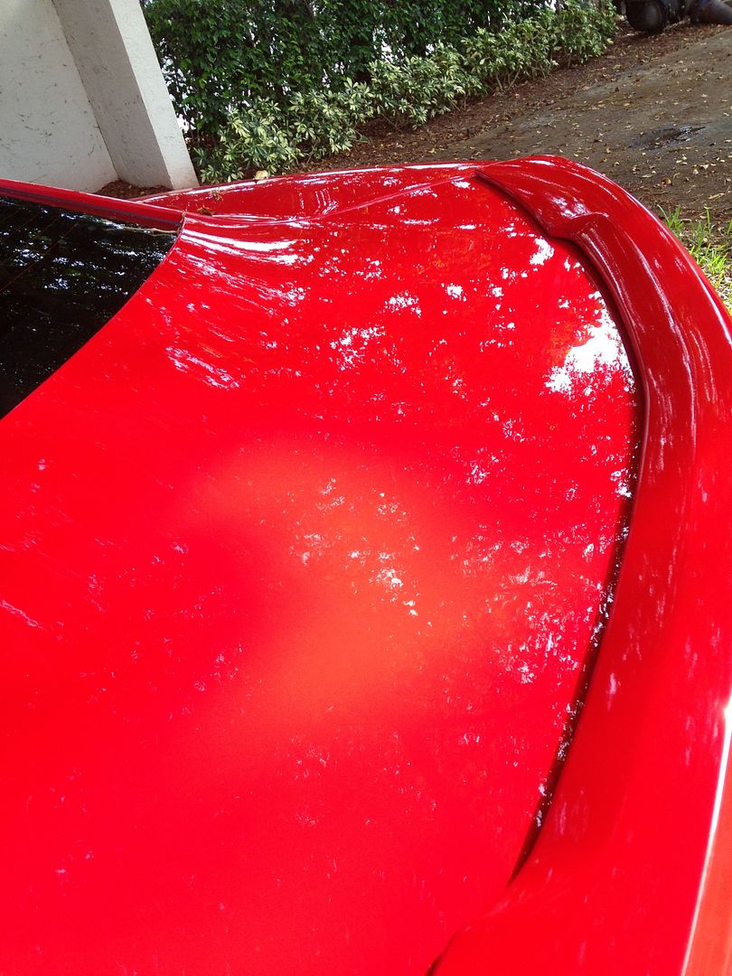

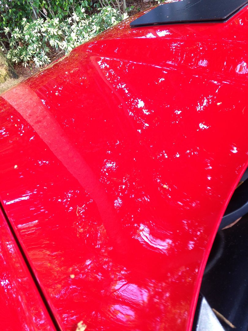

My car sits under trees all day and the paint gets dirty in a few months. So it was time for tear down/re polish. I love this schedule:
1. Duragloss rinseless wipe -leave wet
2. speedy prep towel and rinseless as the lube
3. Griot's Orbital on speed 3.5 with white pad and Menzerna SF4500 finishing polish-->sloooow passes
4. IPA wipe down
5. Orbital on speed 2 with blue pad and Blackfire Wet Diamond
Crystal seal tomorrow
4. IPA wipe down
