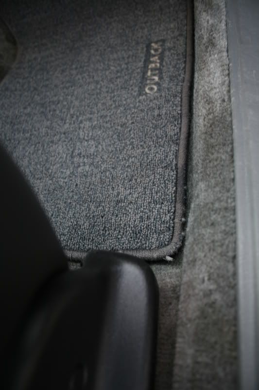

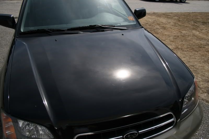

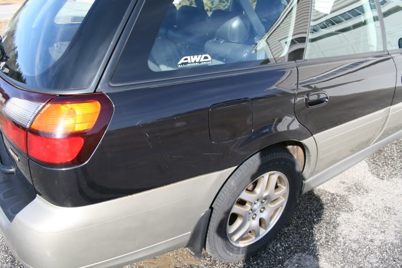

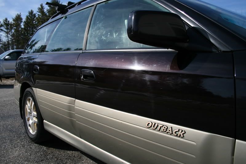

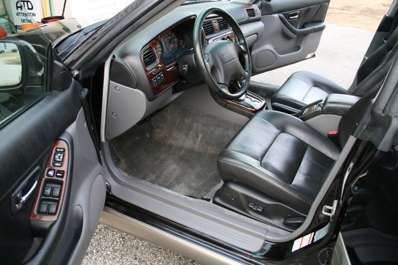

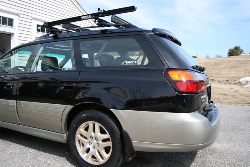

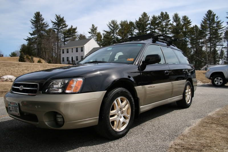

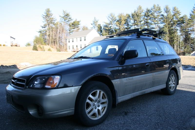

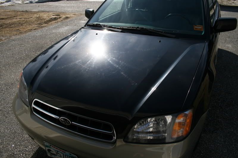

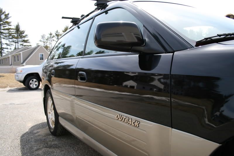

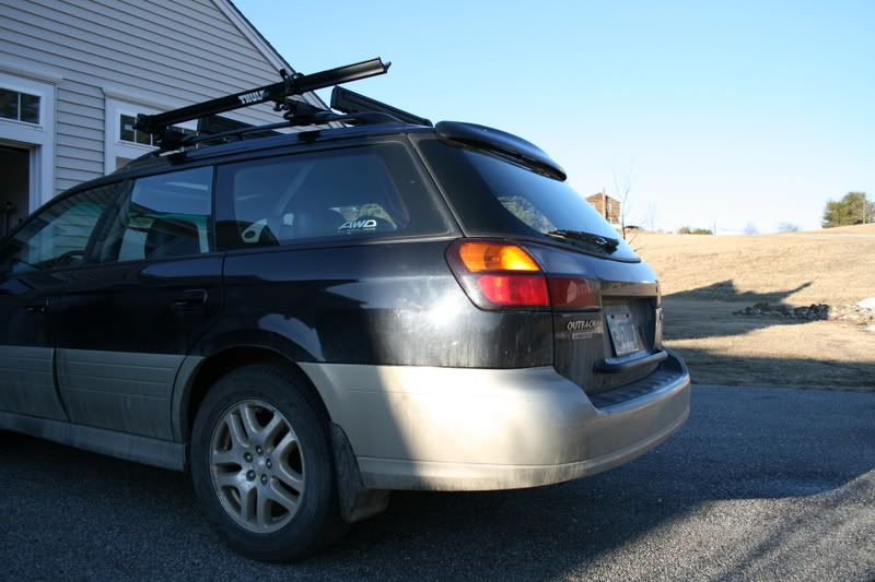

Owners only wanted the interior done(they couldnt stand the smell anymore). So I surprised them with the exterior, to drum up some business at his company. It only took me like and hr an a 1/2 anyway. They were shocked and wondered if I had switched their car with a neighbors or something. I just wanted to be remembered, after he saw it he wanted me to do his older jag, 26ft boat, and suburban as well.
OC yellow pad @ 2000/1200rpm on 1/4 of the car for the heavy scratches
OP black pad @ 1200/800
Poli seal green pad with PC speed 6

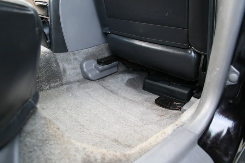

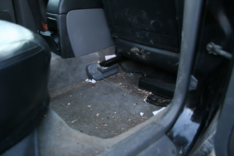

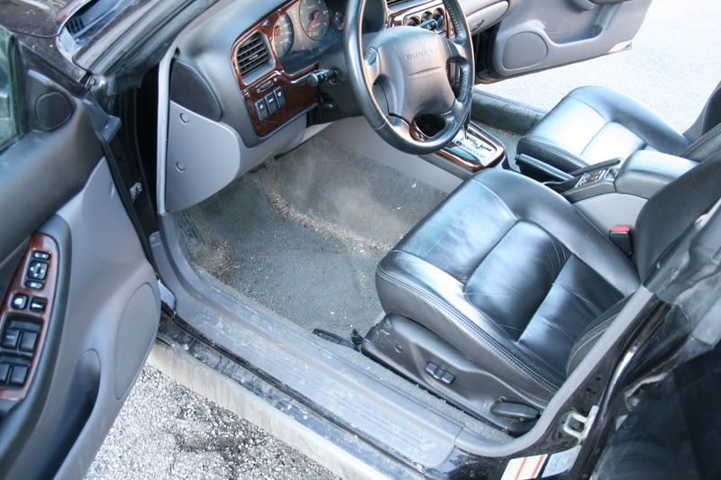

interior:
vac
High pressure air
vac

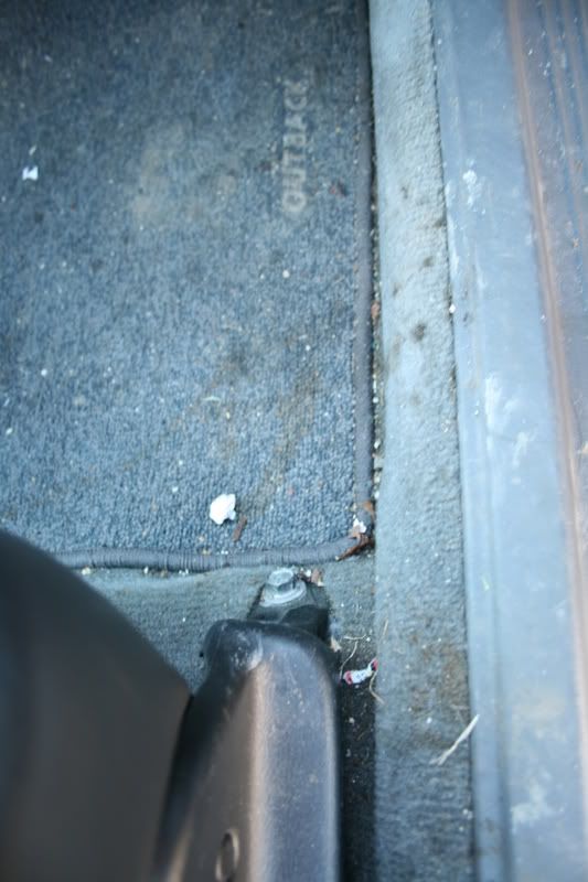

hot water extract (Pro HD cleaner/water/greased lighting mix)
lexol
They said there were several cups of coffee spilt. Witch I can confirm since the stain would keep coming back up after I went over it. I ended up going over it at least ten times with the extractor.
heres the pics No afters of the first one, I fogot:wall

Thanks! No not really, I wasnt really shooting for %100 percent so I didnt pull any lights out.
mr.icon, yeah in that side shot the two doors were repainted. you can see in the before how the back panel is a slightly different color. the color evened out after the polish though.

Wow looks great! What type of extractor are you using and what is your method? I want my carpets to look like that!
P.S. what did you use on the leather?
I used a LGCM, Im lazy and still havent fixed my durrmaid:sadpace:
I just pre treat/adgitate/extract and repeat untill it comes out clear
I used lexol on the leather

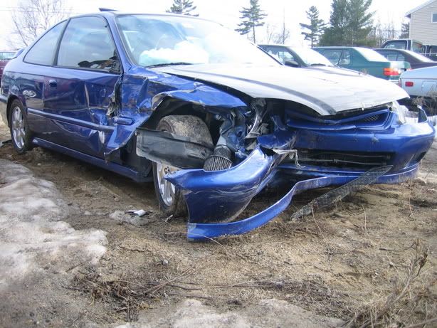

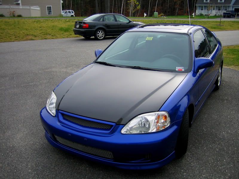

I used to have a 99 civic Si, Ive had the A4 1.8T for about 4 years now. Poor civic got smashed up a few years ago by an old lady.... heres some pics.
When I had both
sad day
