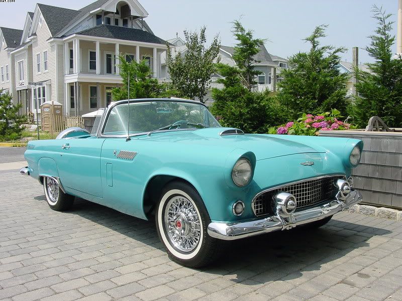

Wanna talk classics?
This is his '56 T-Bird thats on the list for the next time I'm in the area. The car is in 90%+ shape but the paint has swirls and a ton of buffer marks from the local place :(. Amazing vehicle though, compliments everywhere he goes.
I may very well have seen that one at a show. I'm pretty sure there's a similar year, white 'bird in Seaside Park.

Bill: I saw it! 1956 in white while I was walking inside at their place. Just for a brief second but the owner was VERY surprised to hear there was another one around.
