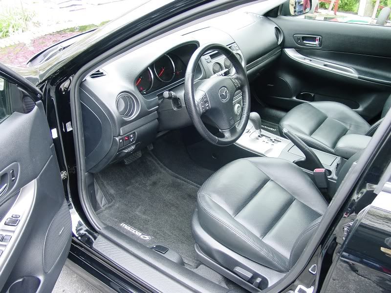

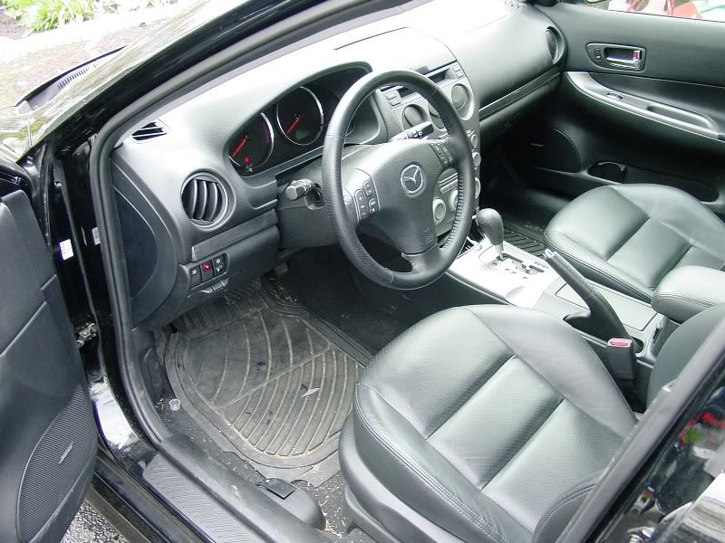

The interior was more soil and dust than anything. No spills or anything like that, just leftover crap from the NE winter.
-Vacuum
-APC 10:1 to clean everything
-Adam's VRT to dress/protect vinyl, rubber, plastic

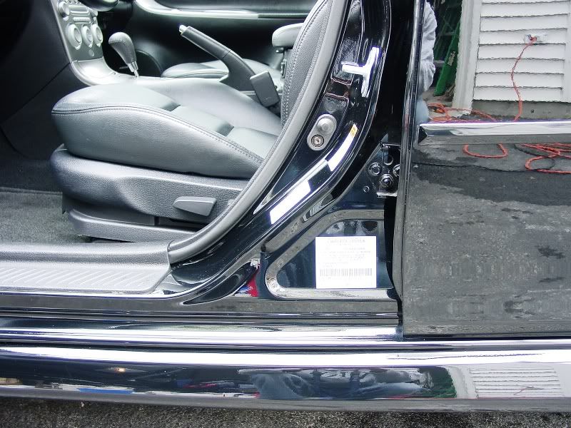

-4* Leather Conditioner on leather
-PB S+W on windows, shiny trim, gauges, and door jams
Before
After

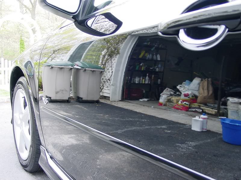

For the exterior, it was moderately swirled on the hood and light swirled everywhere else. After all, it battled a North East winter! The clay picked up more on the horizontal panels than anywhere else, but overall the paint was in pretty nice shape.
-NXT Wash
-PB Clay with NXT Wash as lube
-Optimum Polish via rotary and LC Cutting Pad at 1500 rpm on hood
-Optimum Polish via rotary and LC Polishing Pad at 1500 rpm on entire car
-FK1 #2180 Sealant by hand and MF applicator
-Spit shined to remove with OCW (my new sealant removal technique ;) )
-Adam's Detail Spray to remove pollen before pictures
-Eagle 1 Professional Rim/Tire Cleaner on rims/tires/wells with all respective Meguiar's brushes to clean
-PB BnB to dress
-Flitz on exhaust

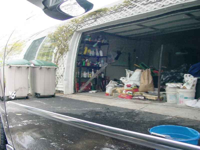

Before
After
My favorite
Any comments, questions, or concerns, feel free to ask :).
