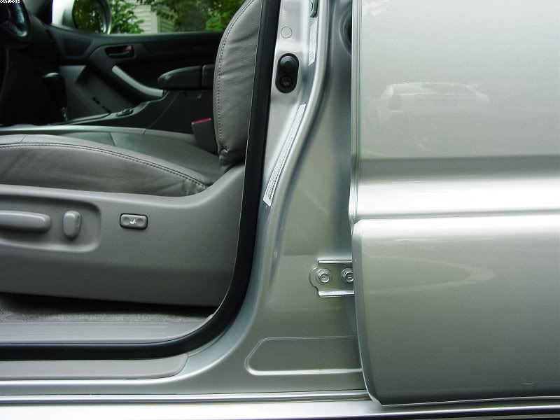

The doorjams were degreased with APC 6:1, rinsed and coated with the Turbo Wax's Last Minute Detailer. A very pleasant scent and easy application with an MF towel. The look added a bit of clarity and as far as I know contains no carnauba.

Couple shots of my underbody work. I APC'd it, then dressed with Hyper Dressing cut 3:1. I hate when these areas are neglected.
