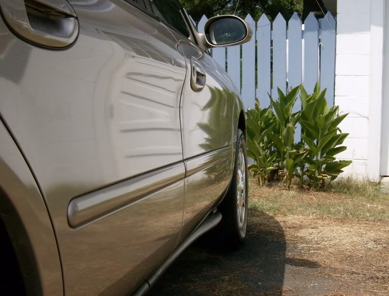

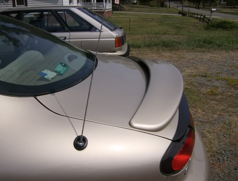

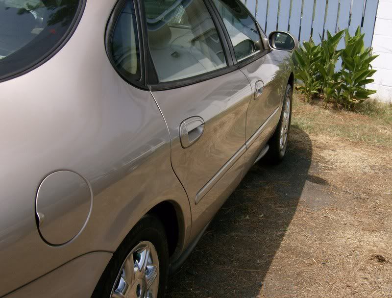

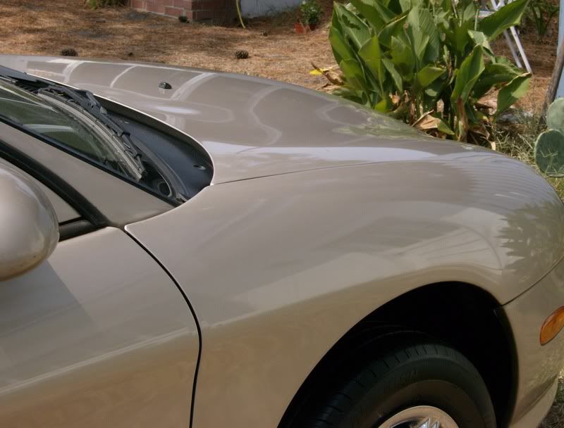

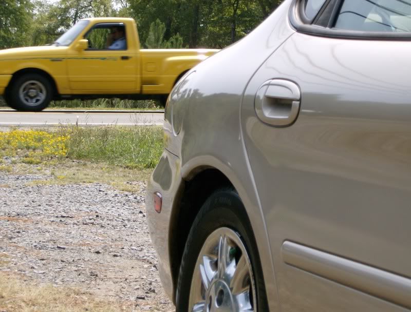

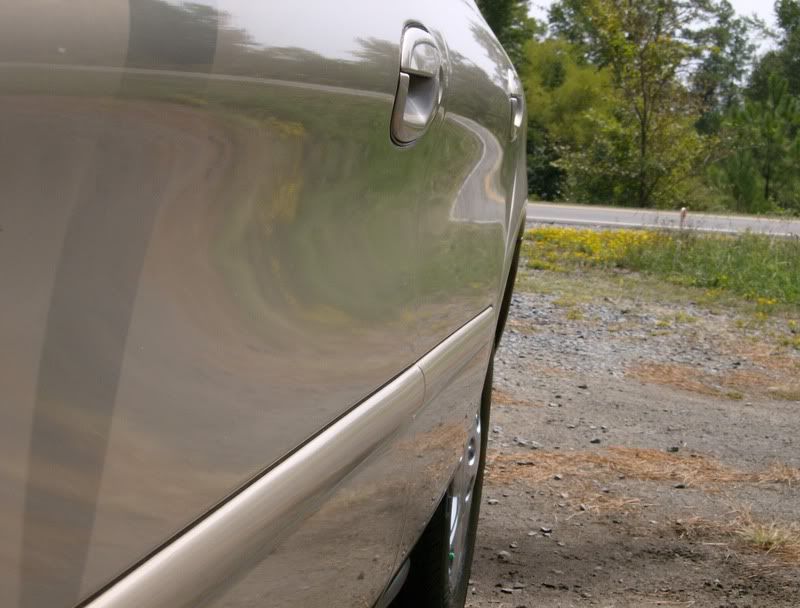

Lets get right down to it. Its Gold or "Champaign" in color It hasn't been truly waxed ever since they bought it from carmax. This car had a TERRIBLE over spray problem. Almost like it was near a car that was being painted. It almost felt like sand paper on the car. When the tires were cleaned brown gunk kept coming off of the rubber like embedded or invisible dirt! boy were they a pain to clean! The trim on this car is faded beyond my repair, I offered to dye it but dad said maybe later. I offered to do the engine of this 24v DOHC car and dad said "no" so just exterior paint shots here... :(
Wash: ONR (3oz to 2 gal mix) sorta hard water here. Dried with MF towels of course.
Tires: cleaned with Red Max and Grim Reaper with my trusty green brush! and dressed with grape dressing. The wheel wells got the same treatment.
Polish: Seeing as though it had such a horrid over spray issue I went right with the Yellow CCS Pad and Heavy Cut Polish (HT-357 Magnum). 2 passes later over the whole car I was finished with that, a few slight problems remain like some rough spots near the windows where I couldn't get my buffer to go! :)
Wax: Glazed with Merzerna Finishing touch and sealed with Opti-Seal
I didn't want to use the EZ Cream Glaze on this car because I had never used my Merzerna before.
I don't have any before pictures as it was really early and I didn't want to wake up the old man or my mom!
and these may not look good in all of them but it was over cast and I couldn't figure out my moms camera to save my own arse so these are all I got!
